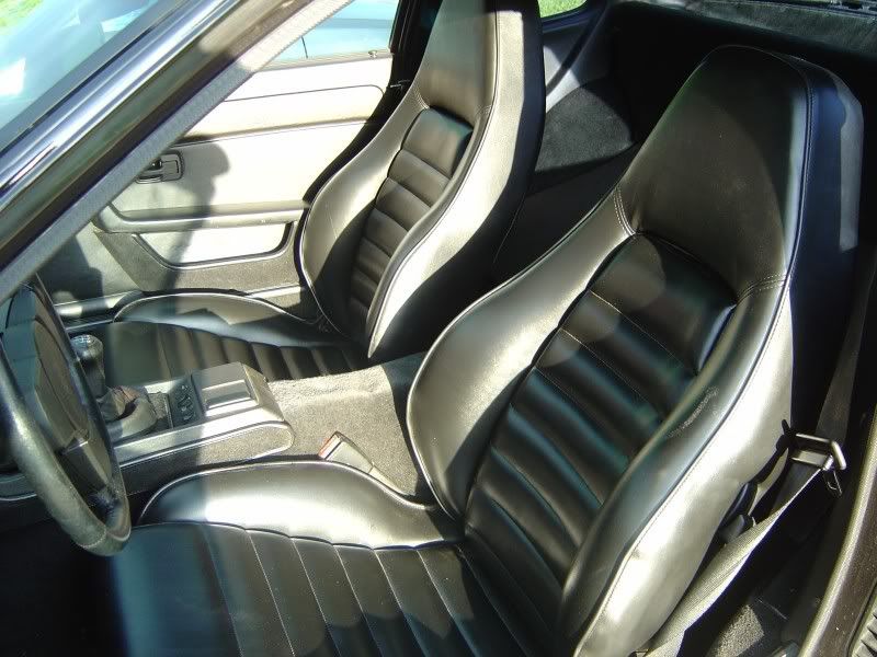

Has anyone tried these? They look great, comfy, and have low-profile bottoms. Easy to find in leather for around $250/pair. Thoughts/comments?

The 944 seats were probably made by Recaro, and if not they at least share the same 16" rail spacing of many of the Recaro seats you'll find from the '80's. I believe the CS rails are about 19" apart, so you will need to fab mounts.
FWIW what you've pictured there are "sport" seats, and I don't think you'll find decent ones for $250. Standard 944 seats yes, or ratty sports for $250, but the sports will go for $500-$800 or so if nice.

As far as opinions, if you like them why not? As long as you don't cut the car to adapt them you can always go back. I would probably instead spend the money at a local upholstery shop stiffening the stock bolters.
