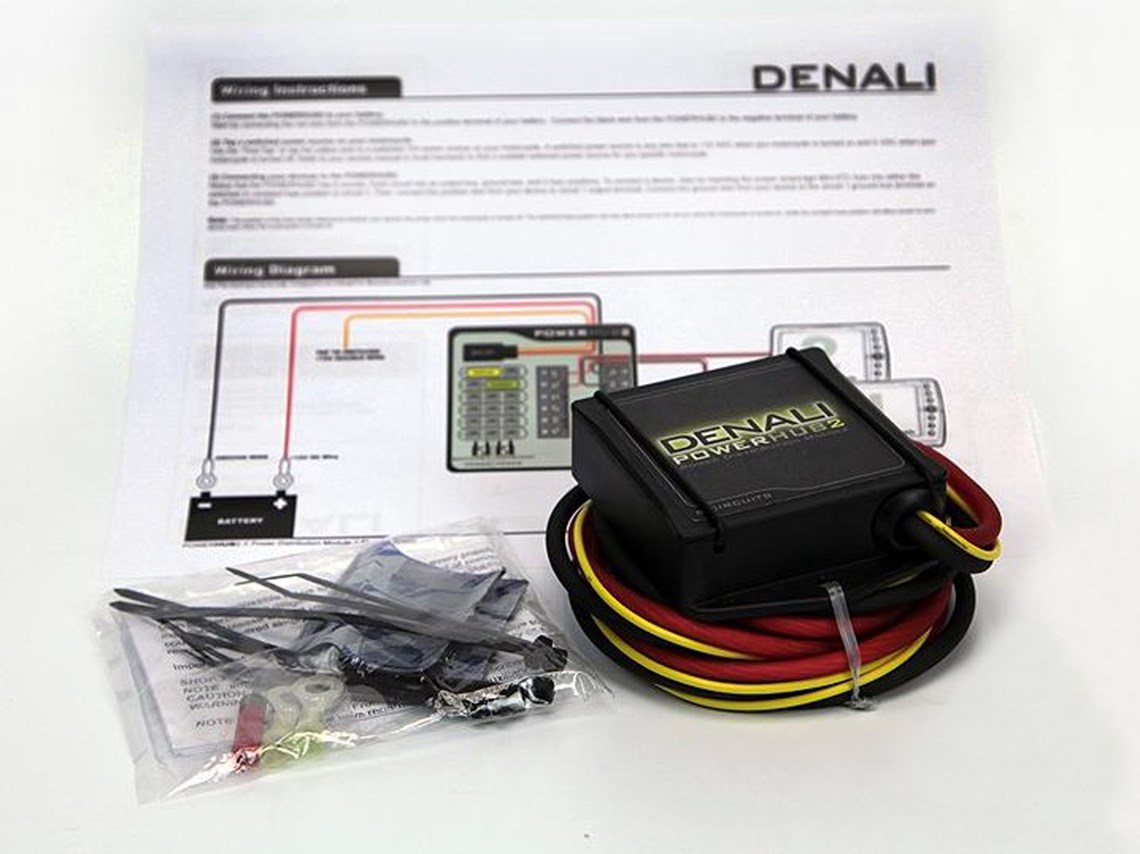

When selecting a power source for added devices, like fans, pumps, etc. I always use the alternator output as the source. It is the source of all current once the engine is running. I install an 8 gauge wire on the alternator and run it to a junction block similar to the one in the picture. Among the several wires on this junction block is my 10 gauge battery charging wire, which is the only direct connection to the battery. The battery is only used to start the engine.
I use these a lot for power distribution. They are prewired, fused and have a common relay. A very tidy package.
