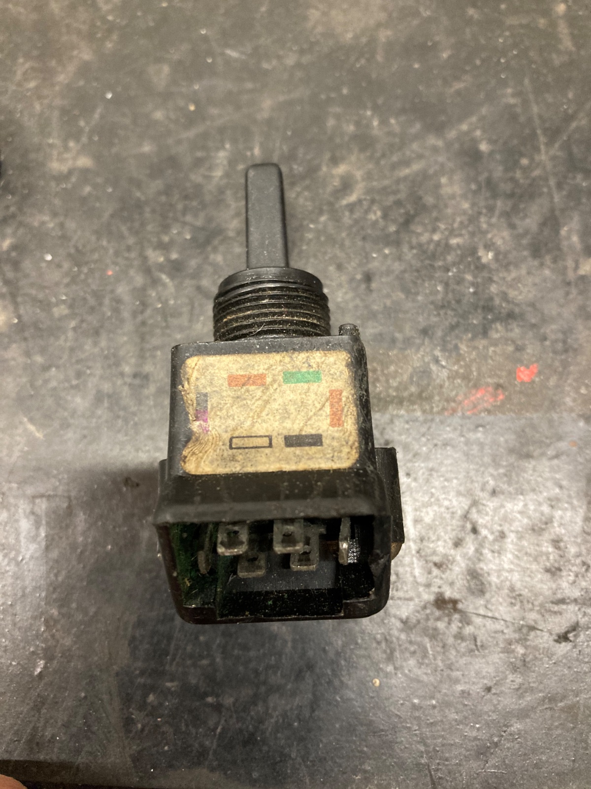

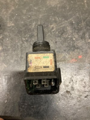

Need some help with p/m switch, there is no harness plug and 6 pins on the switch to figure out. Anyone have an image of the factory harness plug with wire colors?

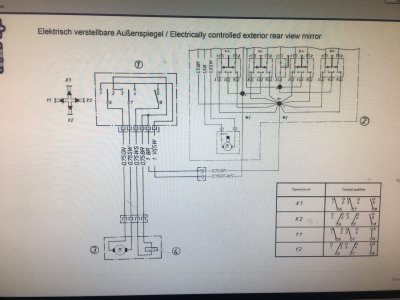

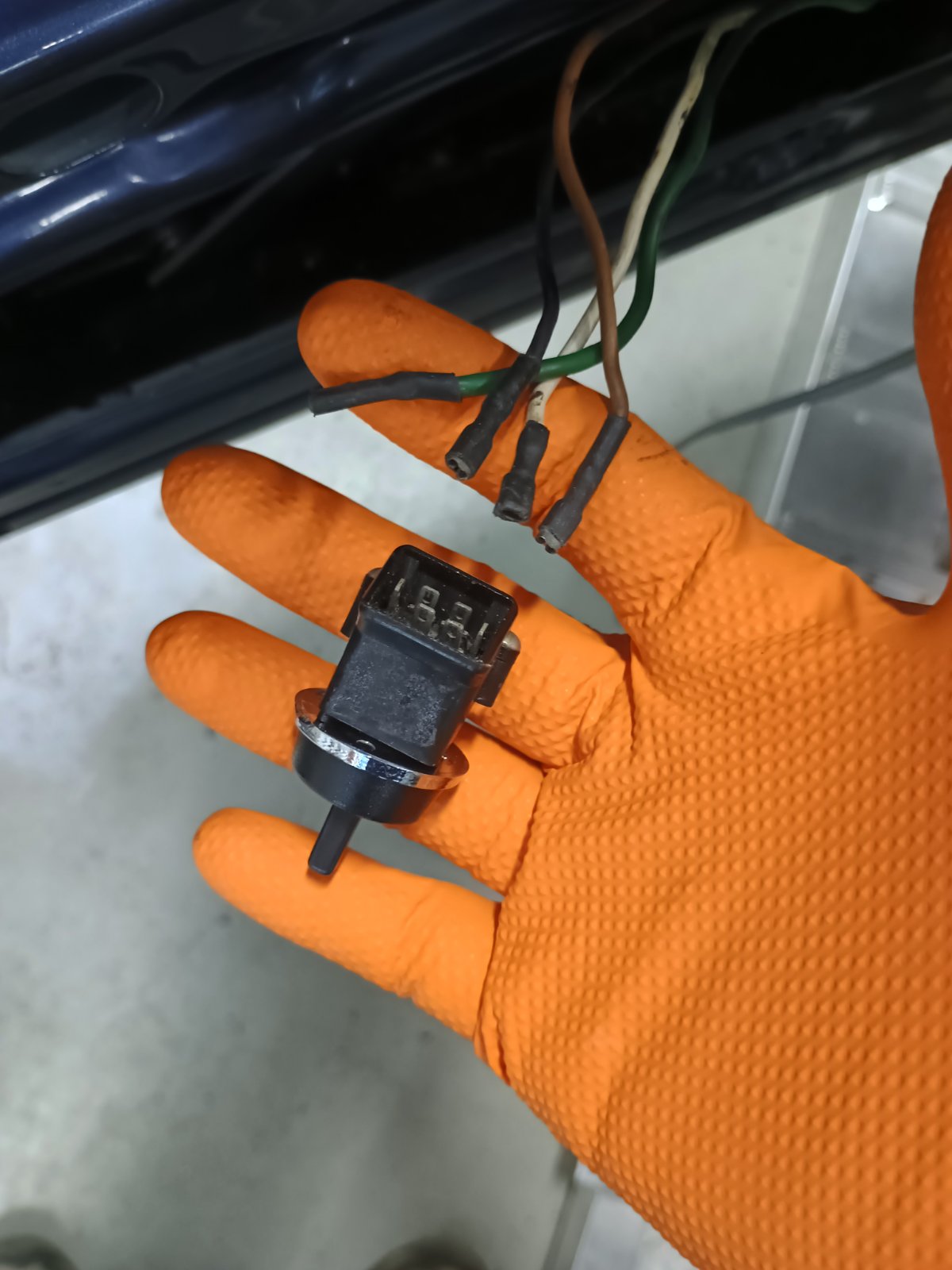

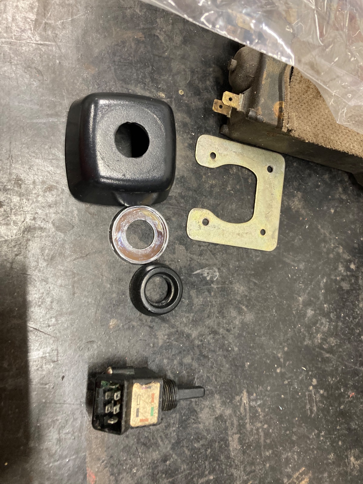

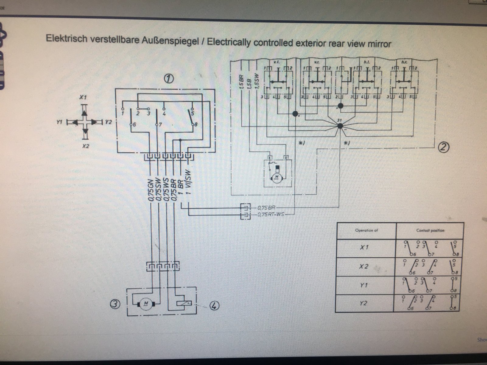

some pictures. On the first picture you can see the colours for the pins.
