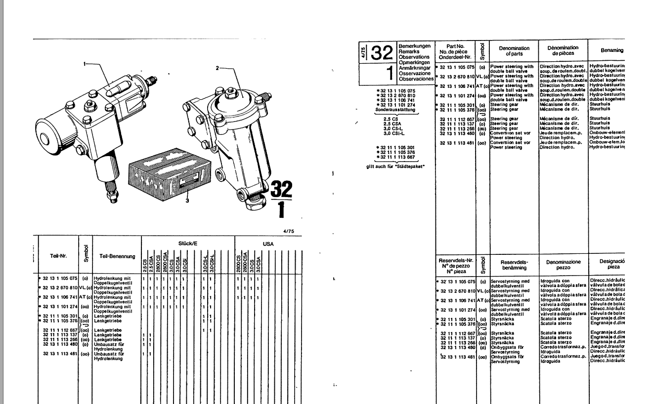

From the parts manuals it appears that all power steering boxes are the same version for LHD e9s. Is that true?

Quick ratio wouldn’t be needed with PS, what would be the point. There is one version for the coupes (other than LHD vs. RHD) and it was optional Mon 2.5CS/CSA and CSL.
That seems to square with the parts manual.
That is where I found it but as Keshav would remind us nearly all CSL other than the first 169 ultra-lightweights had PS from the factory.
