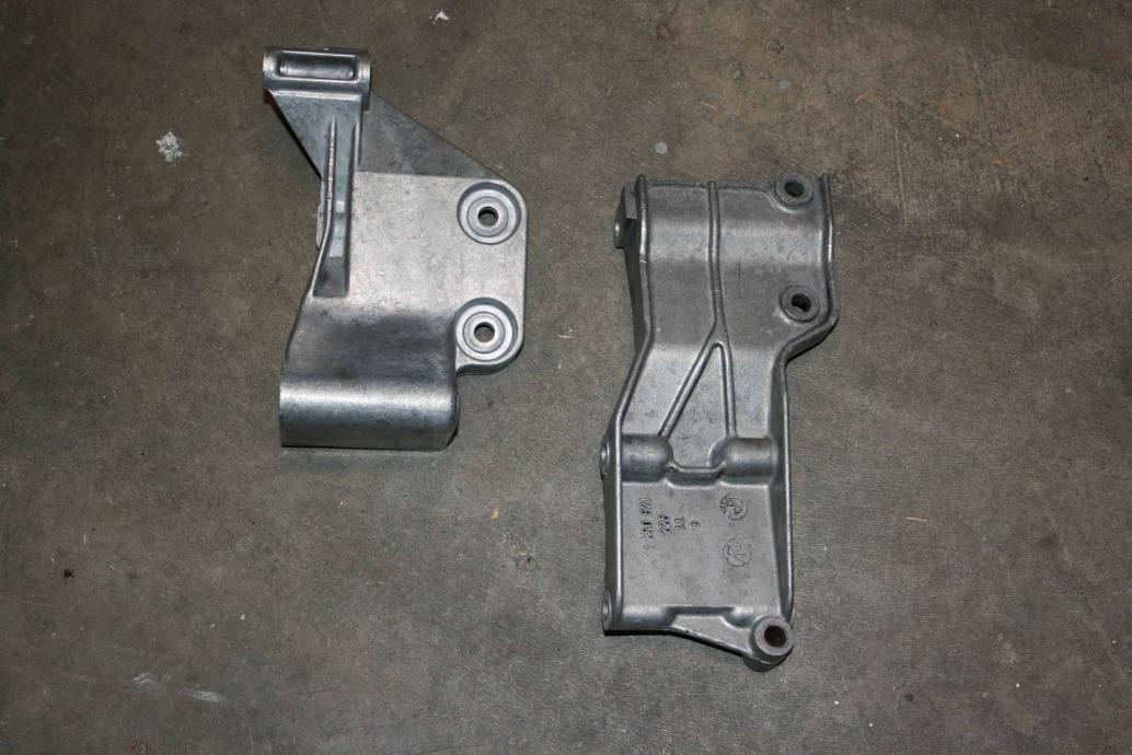

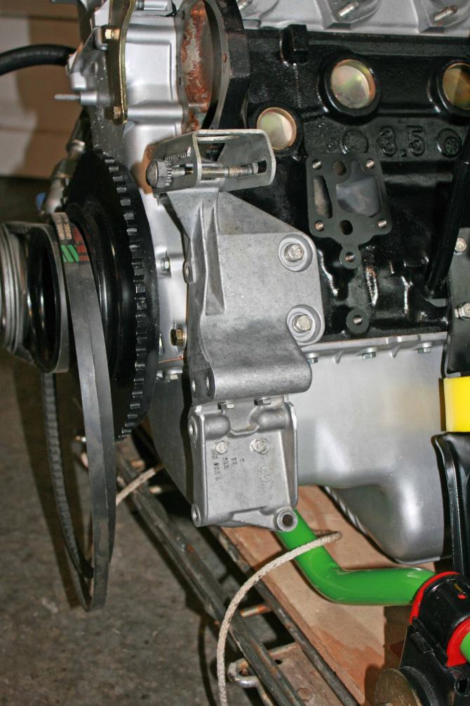

Here is a modification I am trying out. I cut the bottom section off the PS bracket and used a custom steel angle to connect the two pieces. It feels sturdy.
Twist - the original adjustable arm (about 6" long with the long slot) has more flex than the new bracket. It could also be that the rubber isolators were too soft and/or the belt too tight.
Some pics...

Working on a problem like this with the engine & subframe out of the car is cheating! Plus, you're missing all the fun of crawling under your coupe.
But seriously, from your photos, we can see how the two brackets differ. Since they're aluminum, I guess you decided to use the steel angle bracket to join the old and new pieces, rather than welding. My only concern is that the old bracket might fracture in the vicinity of the two bolts that attach to the steel angle - the stress is concentrated at those two points.
Were you still able to pick up the mounting boss at the bottom of the oil pan? If so, you'll probably be OK.
Welding is still a possibility, although the pieces do not overlap much. Yes, the boss on the bottom of the oil pan will be used. I had not installed the bolt when I took the photo.
