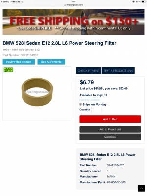

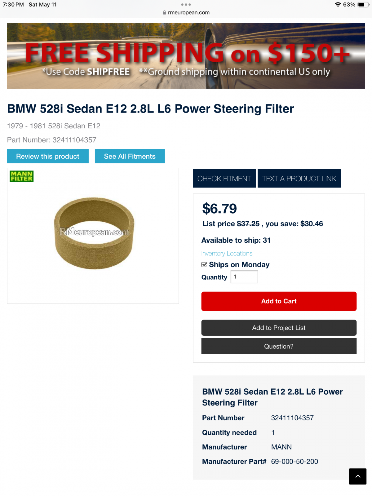

Cheap filter…
Thanks, Don. Already got the filter. Probably paid more than that but hey, it’s still cheap :) I’m probably going to run out of time to get the car ready for the event I’m doing at the beginning of June due to the heater valve replacement which I am procrastinating on because it sucks so much (E12), so I’ll probably end up driving the 911 (pobre de mí) but at least I can knock off some of the other stuff.
