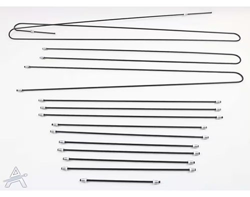

I bought the lines from AceAndrew, maybe 6 years ago, the pre-bent only goes so far, the long difficult one is not pre-bent so you have to do that anyway
And the main line from him was too short, I had to have a splice put in it
I did a very careful job bending it, but too short
FYI, I have an un-bent set for sale, I think I bought them from WN
I bought the IE set, it was nice but did require some further bending. I purchased a roll of cunifer (copper-nickel) line for additional brake line work and for my fuel lines (different sizes). It’s very nice to bend. I agree with ordering a bender and straightener, I didn’t do that with my first attempt and wish I had from the start - straighten out the rolll and then use the bender for the curves. Use the lines you take off the car as your template. I know that some have mentioned that there are services where you can cut the roll to the lengths you need and then have a shop flare the ends and put on fittings - may be an option you could even pursue locally.
