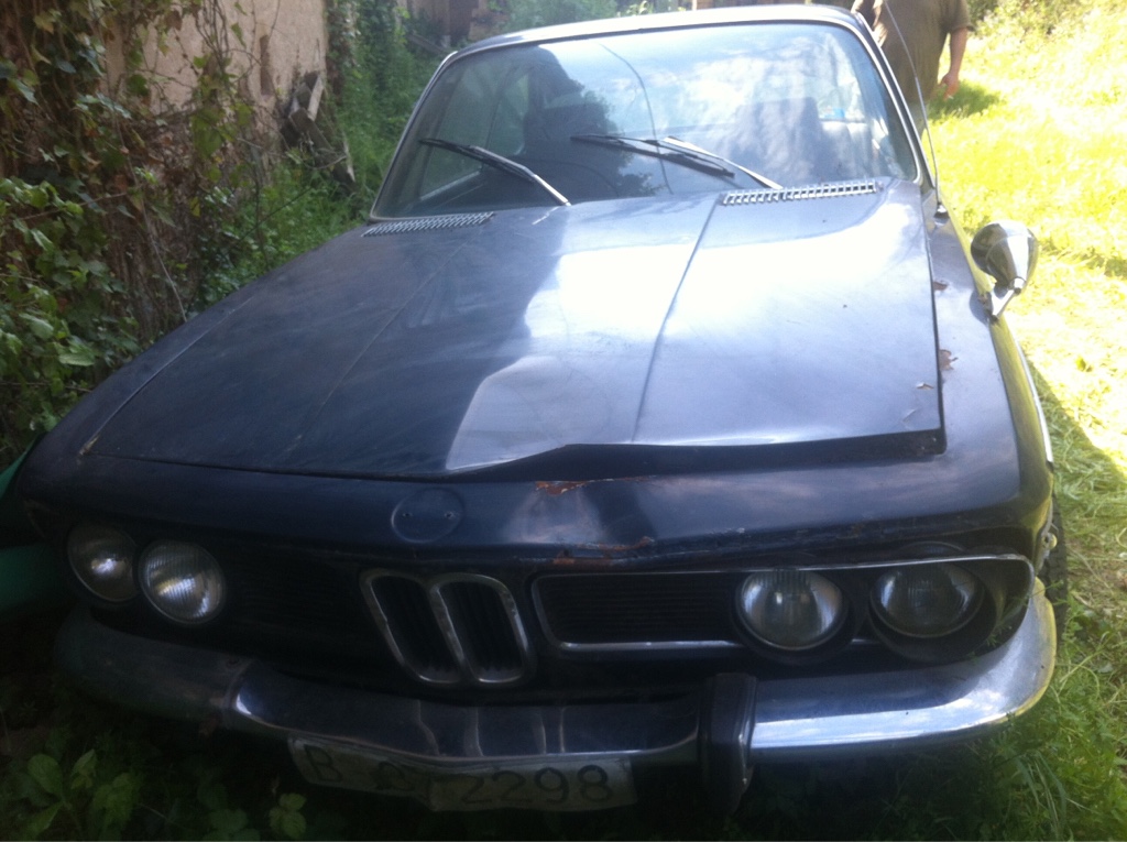

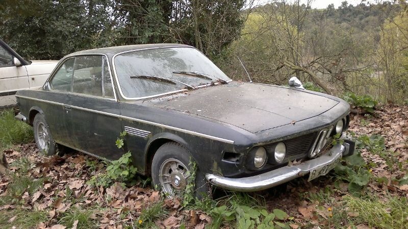

and here begins all friends, my in-laws only condition was that the e9 had to have the same value as the clock, and so, I found a shabby e9 in a second-hand page, I wanted a e9 because they had seen pictures and it was beautiful, I went to the seller and when I saw the car I knew I had a lot of work ahead of me, but like many things I could do in my house then buy it, here it is!

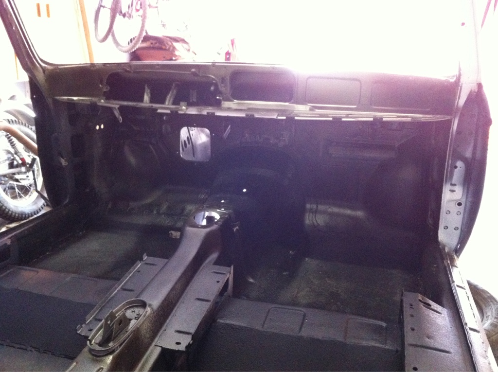

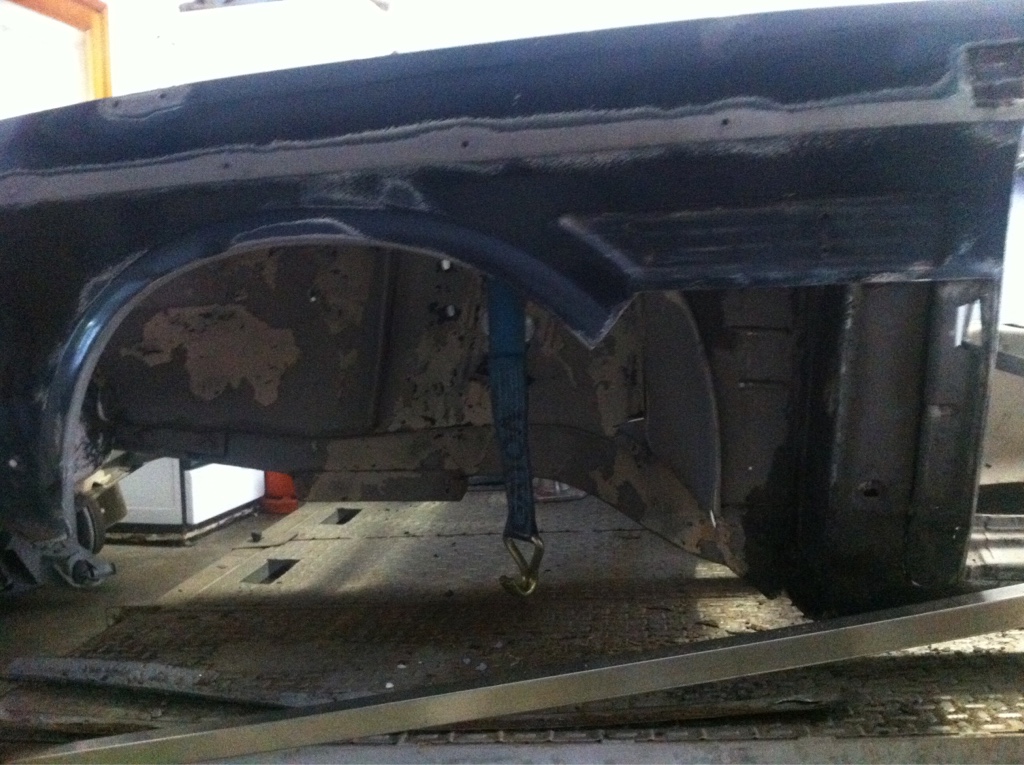

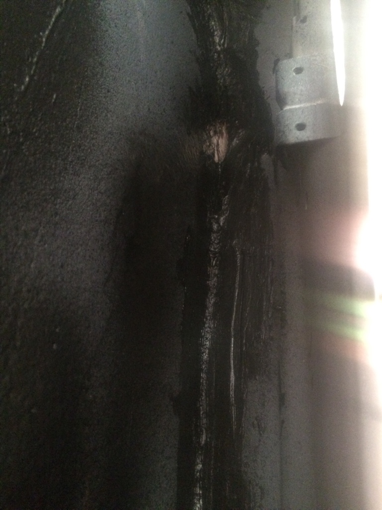

all parts of new iron before them are painted with anti-rust and "primer" prior to welding in the car for the inside and also covered parts! also cover boards has 2 holes on the inside of the fins, because at this point a lot of water, dirt, etc, my e9 has sunroof, then has 4 drains, the water comes back to l'outside but front Deague tube is inside the bottom of the fin, but l'water remains stagnant in and no way out, so I chose to make holes in the front wheel arches and place Ilun inner tube for l ' water drain out!

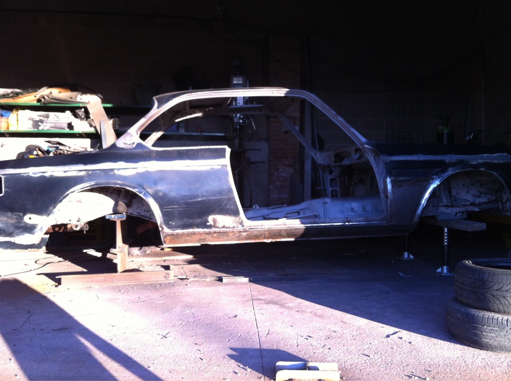

weldments here! and some improvements in the heating plates and shafts with stainless to replace plastic and rotten irons, also change the radiator, etc

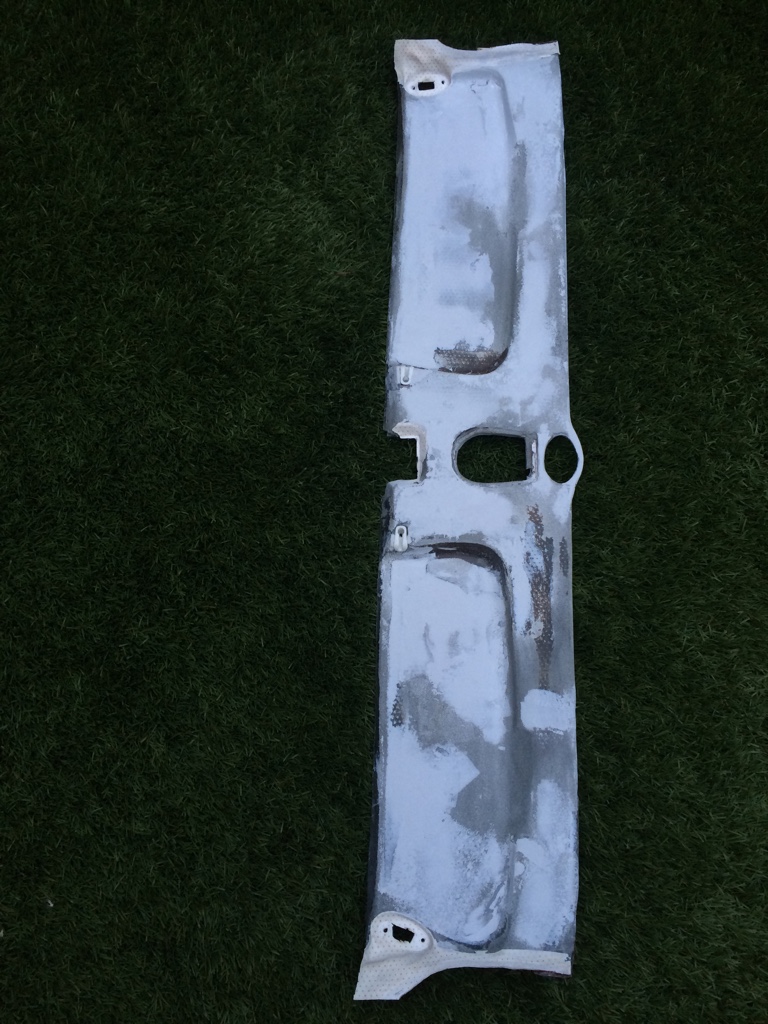

the bottom of the heel also has the weak point that much rust, because there is a part that will pass of front to back and humidity comes here, even if their plastic and rubber for sealing, but with the old heel He has served as a template for in that way make a new whole with a folding iron! and I welded iron side, so water never enters more!
this piece is made with iron 4mm thick, very brave to strengthen all the lower and solder well e9
here is painted with anti-rust primer first and then with "textured"

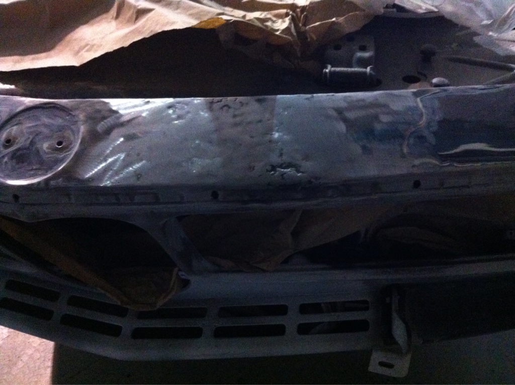

I also blasted the door the area and cut down and repaired with new plate, before printing the floor inside and fill out the dough to seal welded 3m from every pore and soldiers sites and made new parts
