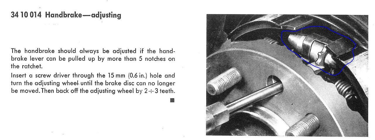

a digresion on the hand brake adjustment
you know what the manual says:
image uploaders
but they say nothing about if it is up or down for more brake pressure
i di this video when i put new rear disks
i was expecting up on one side and down in the other, but forun that both sides requeire up for closing the jaws so increase pressure
as the part that does the trick is reversible, do you think it has been wrongly installed in my car or all your cars do the same ?
my case:
