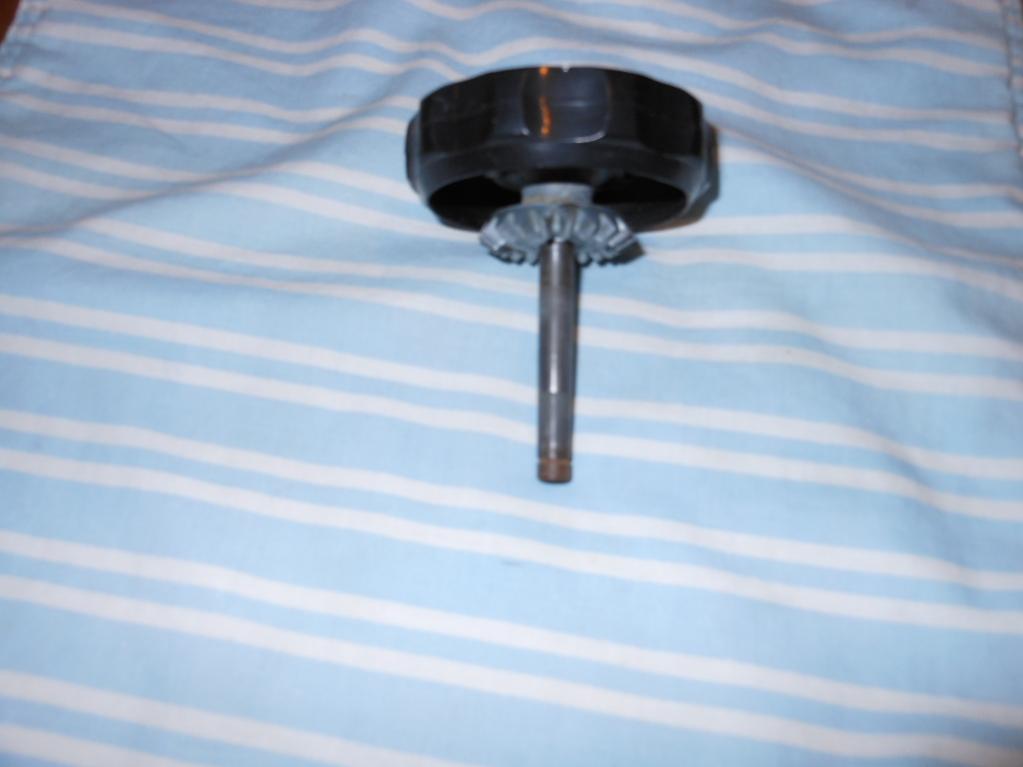

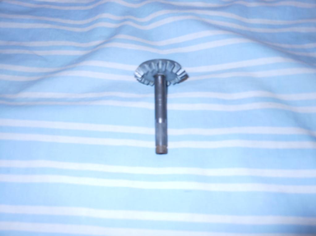

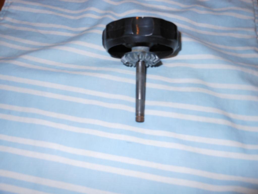

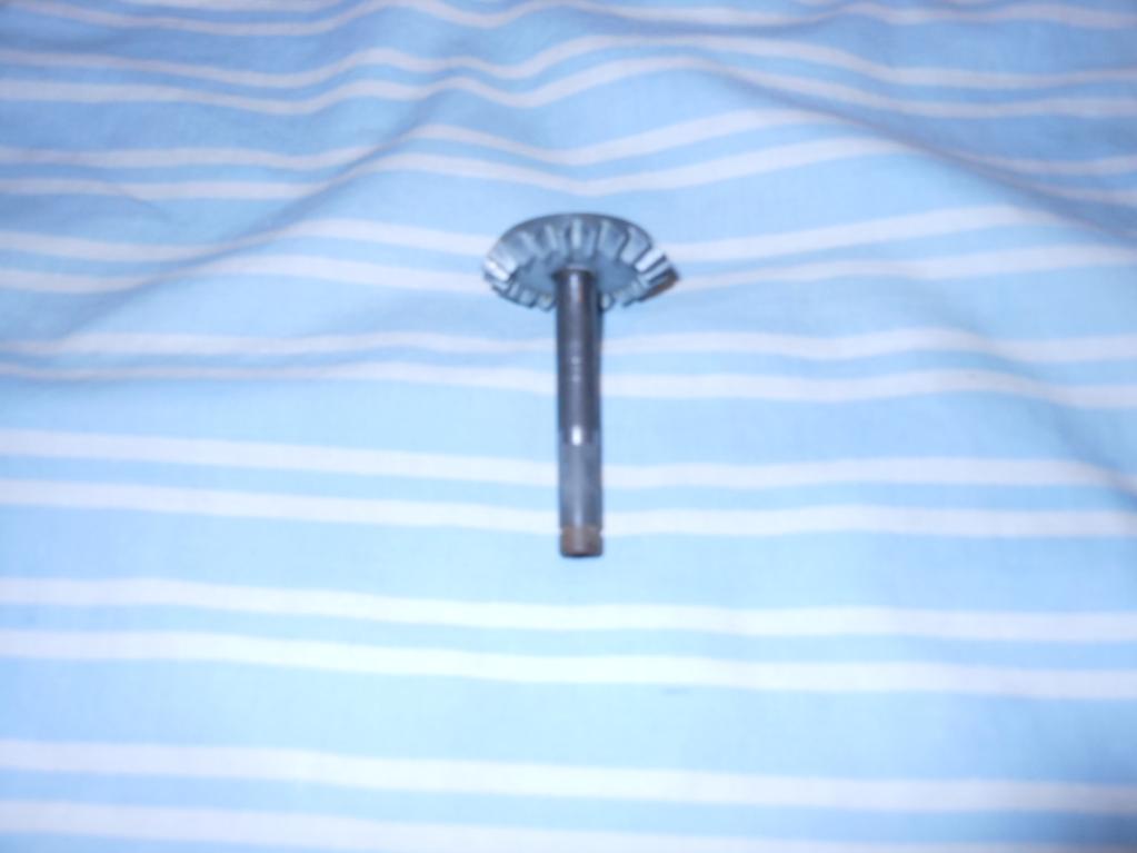

I just checked and it appears the seats are not symetrical in their core structure:
That is what they should look like:
Left seat (driver side):
Right seat (passenger side):
The adjust knob turns a squared cable that rotates a gear to set the angle of the seat. It has been a while but my gut says the knob can be re-sited to the outside part of the seat.
It has also been a while since I had the seats apart. If you can post pictures of the seat, it might help.
The squared end cable might just be disengaged from the gear shaft. I keep an umbrella under my seat and have yanked it out by accident a few times.
