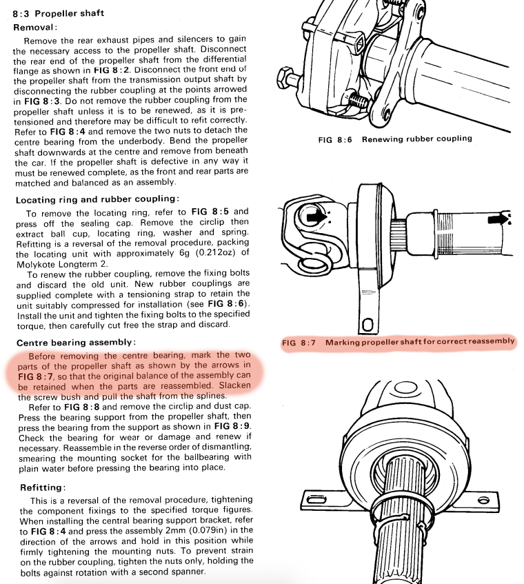

I'm pretty sure you can do it wrong, there should be a mark on each part of the prop shaft that's supposed to line up when the two parts are joined together correctly.
At least my prop shaft has markings, but I don't know if they're original, or from a previous repair and balancing.
EDIT:
Seems like they maybe didn't have any markings from factory as the Autobooks manual in our tech section says to mark the prop shaft before removal. Don't know how accurate that is. But I guess if @CallumNicklin recently had it balanced, it definitely should have markings, old or new.
EDIT:
Thanks guys. Yeah, all is correctly aligned after rebalancing was carried out.
Can someone confirm if the 2 pieces of the prop require a parallel or non-parallel alignment, or if it doesn’t even matter?
