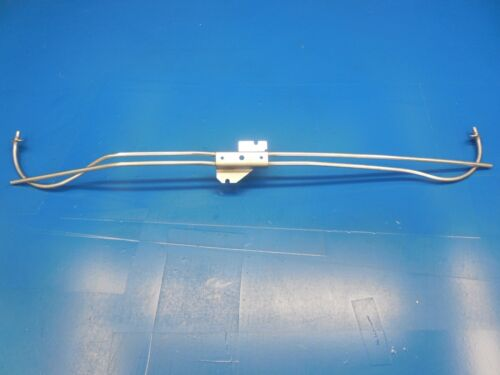

1) Even though he lubed the cables, there is a solid "crisscross" guide that the cables feed into. It sits in front of the motor. As the motor spins it feeds the cables in/out of this guide tube. The tubes can have rust/debris that can really hinder the cable's motion. Was that pulled and cleaned out? My cables were actually fused to it, I got a used one from Porsche, since the same part and cheaper than BMW. Also if the curved ends are bent even a little, you can see how that would offer resistence to cable motion

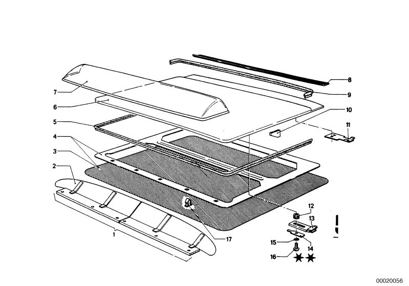

4) Uneven rise when closed. Make sure #10 exists on both sides.

also # 10 hits a unitt in the roof i think
