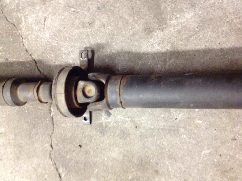

Pre-loading is easy/simple.
Note that the bolts to the center bearing are in slotted channels.
Push the bearing forward a 1/4" from its natural position just as you tighten the bolts.
Done.

I'm ordering in the am- I ll get you a center bearing if
You need. Do you have a pic of one installed?
