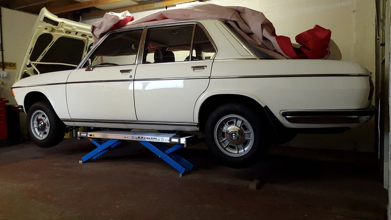

I'm suffering the signs of a deteriorating prop' shaft centre bearing, with a distinct thumping from the shaft when taking up drive in 1st/reverse. The bearing rubber hasn't failed however the shaft can be moved a fair amount by hand with the rubber flexing as a result therefore I'm assuming this is at fault. The guibo appears to be in excellent condition with no cracking evident. My question is, is prop' shaft removal a home job ?. I have an EZ Carlift therefore can raise the car 2ft (photo below isn't raised to the full height) however the crossbars on the lift would restrict exhaust and shaft removal I think. This aside I don't really like the idea of lying under the car while removing a heavy item like the prop' shaft. Is it best left to a garage ?. The other question is, although the guibo looks ok is it best to replace it while the shaft is off anyway ?. I'm concerned that I may be replacing a perfectly good coupling with an inferior aftermarket one but don't want to do the work twice should it need replacing in the future.

Ok I'll have another look up on the lift. I still think the lift crossbars will be in the way though, which is a pity as it's a good bit higher than using jack stands, the ones I have anyway.

Not sure whether the cross bars will be in the way or not.
