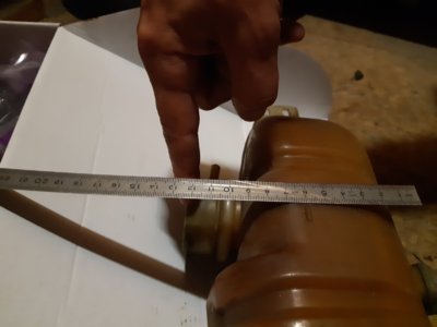

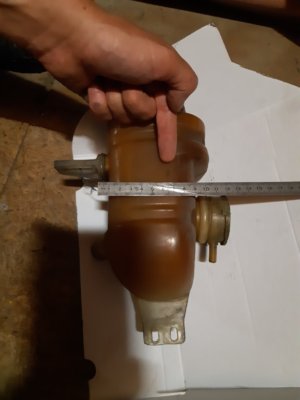

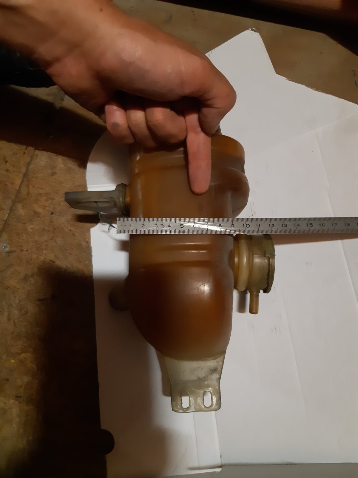

Q, how high the coolant in the reservoir ? (Cold engine)
Here is a drawing to explain my point
Why am I asking this question?
Here is the reason:

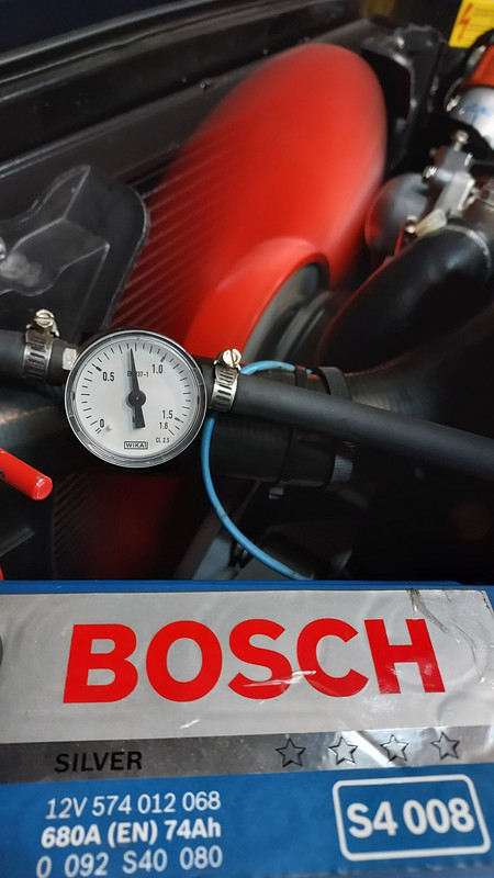

On hot engine, if I set coolant level at 5cm, this is exactly half of the reservoir, ...the pressure reads 0,75Bar
But if the lever is at 7,5cm, pressure reaches 0,95Bar
Remember that 1Bar is the pressure that opens the safety valve of the cap
Hence my question
Is there anything in the books ? I saw nothing,...but

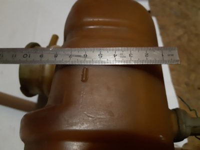

As a starting point, could it be a simple option to just copy the height of the transparant reservervoir? Either distance to top, or distance to bottom?
I asumme the volume and dimensions of the plastic vs the brass version are quite alike. If so, then the level should be the same. ( note that I'm not anywhere experienced in engine things; it's just my practical reasoning)
Your pressure difference makes sense. As the air volume is smaller when filled to 7,5 cm the pressure will raise more compared to the pressure reached with a coolant level of 5 cm.
The air needs only needs to compensate for the growing volume of the coolant when heated. If the reservoir was a straight edged box, I would think the pressure increase is almost linear to the height. As we have hemispherical top shape,the linear pressure build up is pulled slightly up by the facts that the air volume reduces more between 5 to 6 cm, compared to 7 to 8 cm fill levels. Also the fluid above the 5cm level will add to the expanded volume, thus increasing the pressure a tad more vs linear.

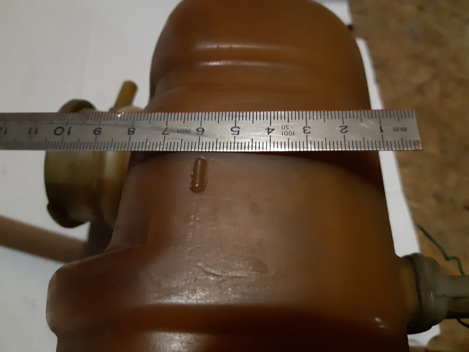

this is good too,
i can check the level at the transparent and judge,

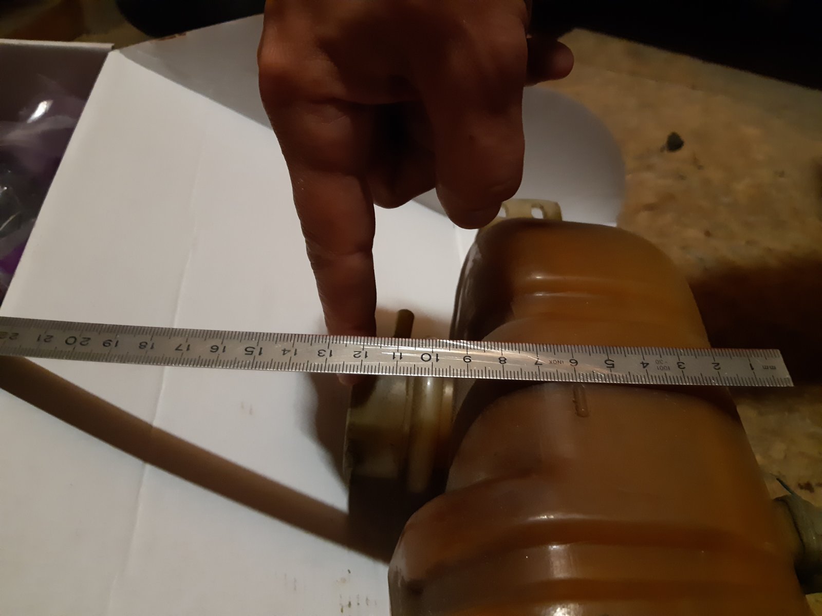

but, was there a level mark?
Yes there is; it is 6 cm from the bottom of the reservoir, which leaves 2cm to the "roof" of reservoir = 6 cm to top of cap attachment.
