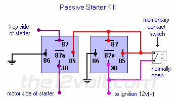

Looks like you could do this with a pair of relays and a momentary contact switch: https://www.the12volt.com/relays/starter-interrupt-diagrams.asp#psk
I think my friend went the simple way and found a switch that worked like how I described above, but using one of those diagrams you posted might work good too. I'll have to spend some time understanding it. Thanks.
EDIT: I think this one will work.
This is a stand alone starter kill. It does not rely on an alarm or keyless entry for it to work, only a simple momentary contact switch (normally open) to deactivate it. Every time the ignition is turned off, continuity is broken on the starter feed wire. To disable (or start), turn ignition on, then press the hidden switch, then start as normal.
