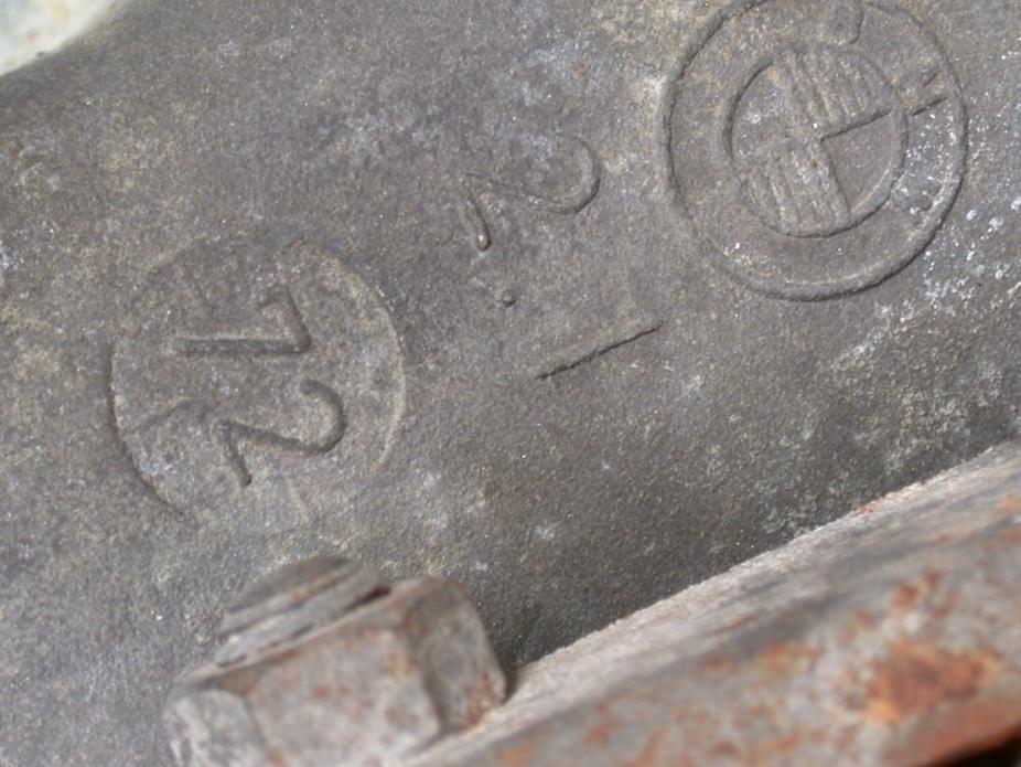

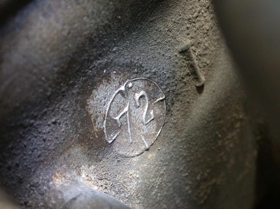

exactly there is a circle with a number on it, smth like 71, 73, 83,...
steve, how is your "72" head ? older or newer style ?
If the head is from 74, it's the older style. The new style was introduced in two steps: 1st in June 79 with a better casting but still the old style, then the second step about a year later with the later style casting with new design.
