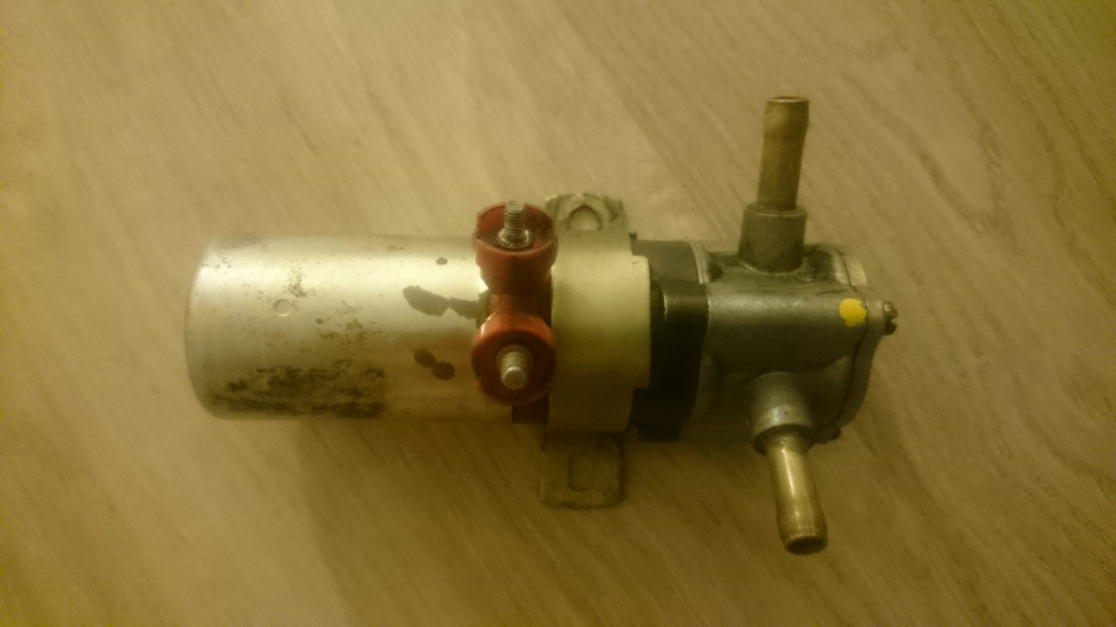

My original BMW 3.0s Alpina B3 export from 72 has fuel problems.
The pump is something special for the 3 Webers.
Have you the same pump? Actual head of Alpina engine department told me they used standard pump. But this is definitivly not the standard.
Engine in matching numbers and original.
Maybe it has been changed in the past.

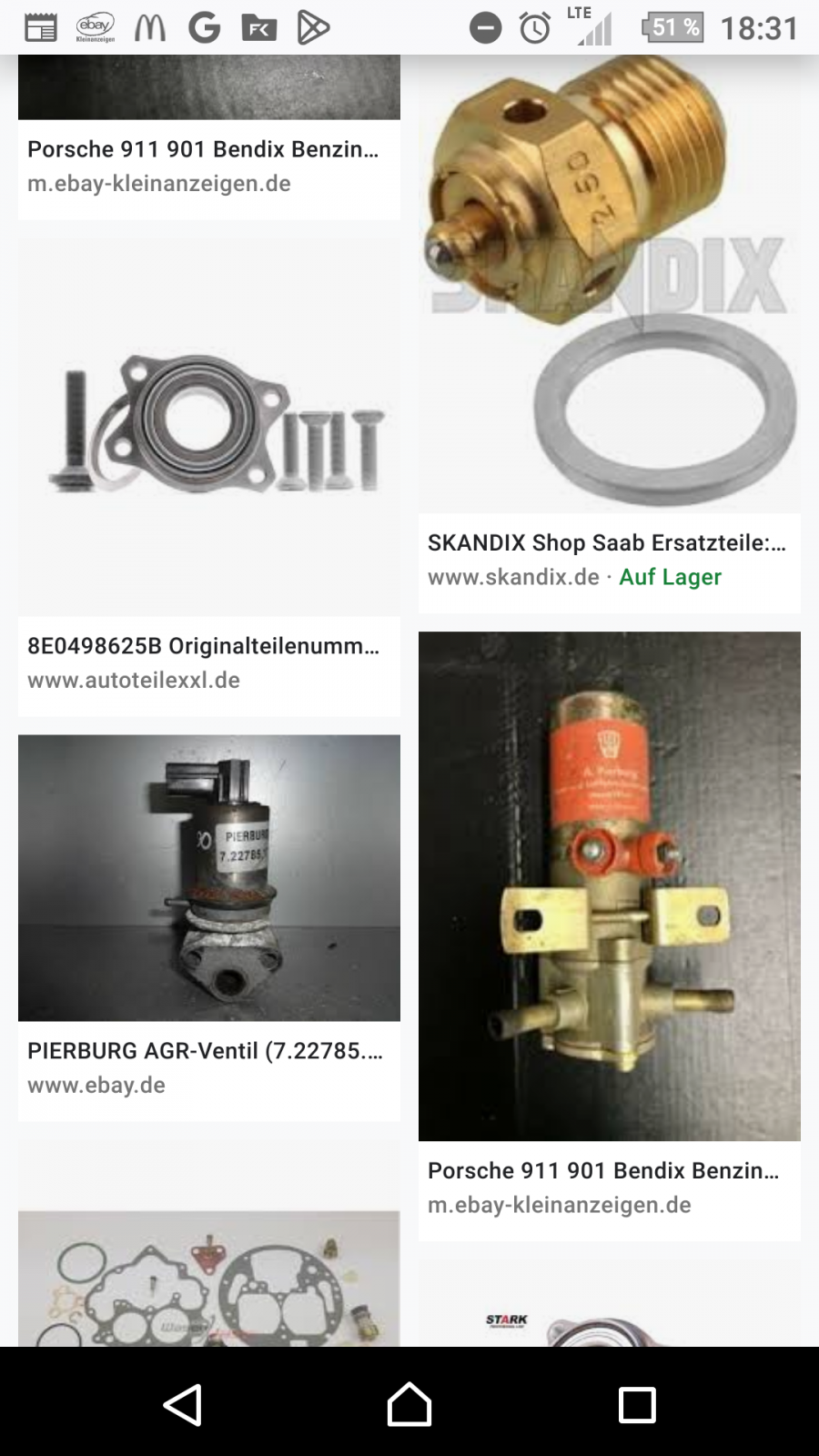

This could be an aviation pump. Alpina used Pierburg/Bendix electrical pumps on their carb set ups. The standard BMW pumps have either not enough flow (mechanical-CS) or too much pressure (electrical- CSi)
Do you know what PSI you have? Webers prefer a low 3-5psi flow.
I have had good luck with the Facet electric pumps with an added pressure regulator + gauge for tuning.
