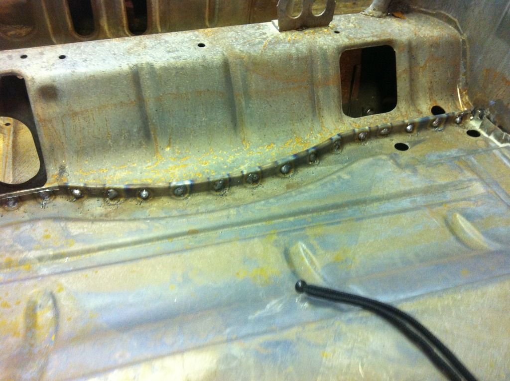

If I was to put in new floors – I would not seam weld it but plug weld it- you can buy a set of hand joggles that have a punch in it and that will enable you to punch lots of holes in the new section and then zap the holes with the mig (this sort of replicated the spot welds) – BUT you need to try a bit on the bench – if you don’t have it set right, and if you don’t zap it for a sufficient time the weld will not hold.

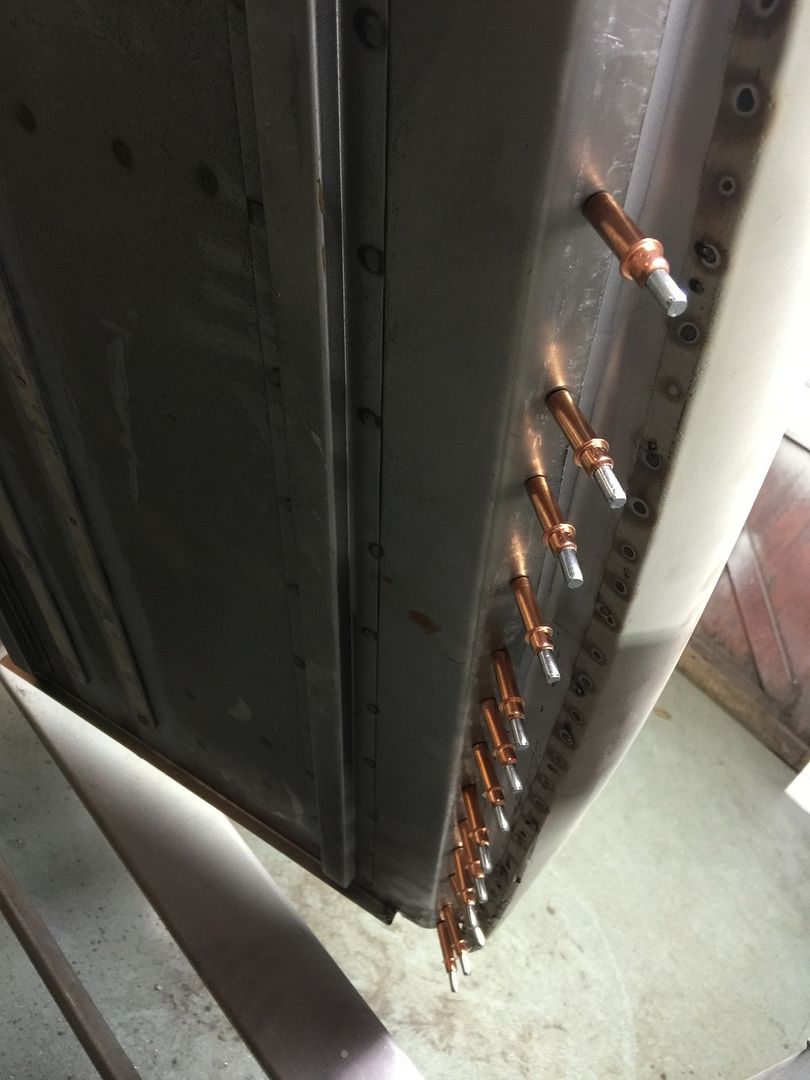

I use clecos to hold the panel in place and then just zap the small holes that the clecos leave.

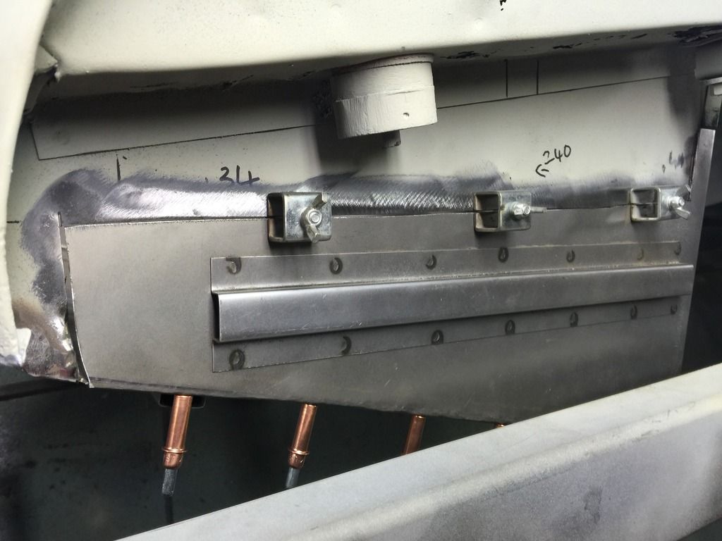

You can get them off ebay…. Here is a picture of a Jaguar XK150 boot floor I have put in - showing the clecos and clamps
You need to ensure that you get a good sung fit first and that you must spray a weld through zinc primer on the lapped joints that will be coved by the new steel, this will help reduce any rust starting… also you need to when spraying the car – ensure you use seam sealer on all the joints. – a good tip for applying the seam sealer is applying it using a Scoth pad – I could go on and on….
some pictures of plug welds on my VW camper
