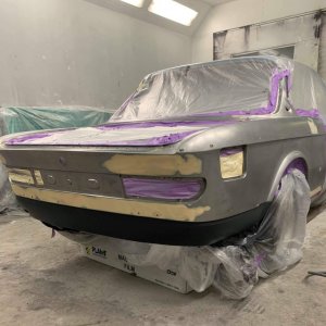

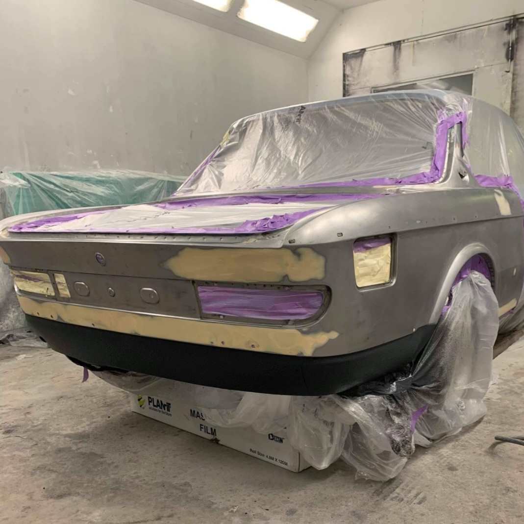

Quick one, originally , did the stone chip paint at the rear only cover the lhs / rhs lower qtr, through to the vertical line on each side, or did it go the whole way across?

Even a picture ripped from our forum:
(From member Andy the Aussie)
3 datapoints; the Consensus is: yes, under the rear bumper as well.
I checked mine, the stone chip paint goes across the back under the bumper as well.
