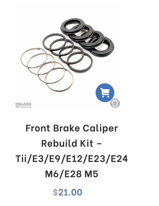

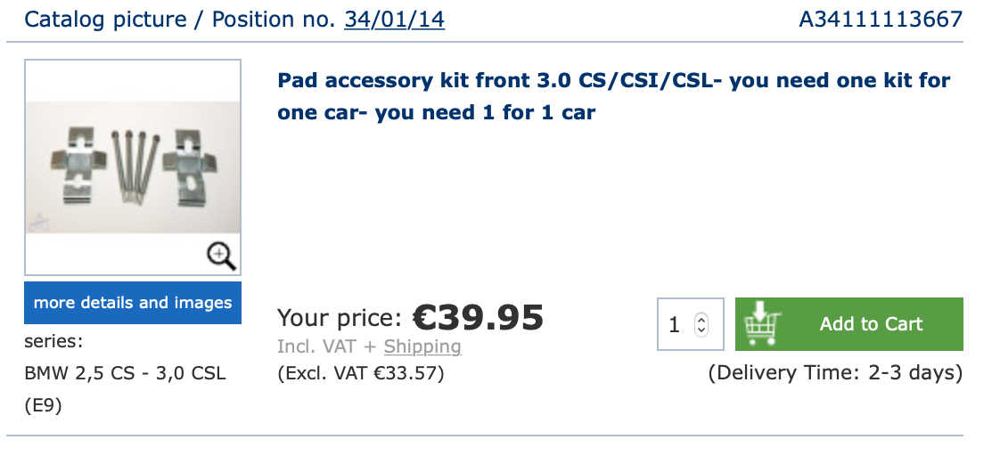

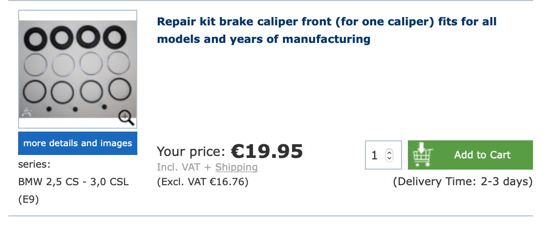

I've started the process of refurbishing the brakes and seem to have run into a dead end regarding parts. Both Ireland Engineering and Wallothnesch are selling the parts (seals and rings) for the fronts but nothing for the rears.
I called Ireland today and the person I spoke with said they're understanding was the parts for the rears are different from the fronts and so I've reached out to W&N to see what they say but I'm wondering if anyone has been through this process before and if there's an easy work around or supplier that has parts for both fronts and rear calipers.

After I pressed publish on this link I noticed that the Ireland kit is also the one used for other models like the E12/E23 etc. If these are all the same calipers or parts is it just a matter of ordering these same parts for a different model?

Each rear caliper L/R have 2 pistons 42mm diameter
Each front caliper L/R have 4 pistons 40mm diameter
E3 E9 E12 & early E24 used same pistons, rubbers, the only difference was in brake pads mounting kits depending on what rotors car used - vented / non-vented.
