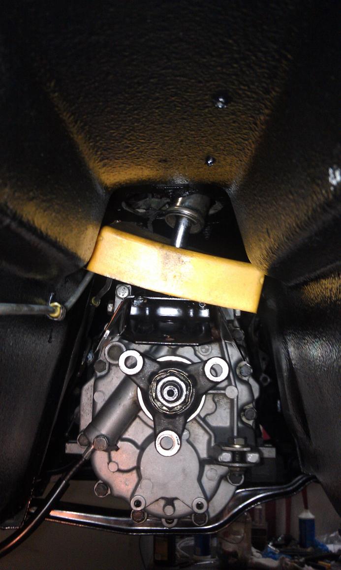

I had some other work to do so I've been off the site for a few weeks but I'm back working on the "grey lady". I connected up the shifter and had a few questions I hope some can help with;
This is a 5 sp conversion from an automatic (1974) and there are 2 holes in the shift platform, one in front of the other. Which hole should I use to connect to the body, the forward or rear hole? The forward hole seems to almost match perfectly with the existing self-tapping bolt that was there with the automatic. And is there some kind of spacer that goes in between the platform and the "tunnel" (body).
Is there a bushing that goes on the bottom of the stick shift?
Also, in the picture there is a nut & bolt configuration attached to the rear of the transmission that does not seem to go anywhere- does anyone know what that connects to?

The back end of the shift platform connects to the body via a rubber AFM mount as per Carl Nelson's 5-speed conversion write up:
"Install five speed shift assembly, trans cross member (this just straddles the large openings on the bolt track) and drive shaft. To support the rear of the five-speed shift platform use an airflow meter mount (all holes are present). "
The AFM mount is a thick rubber bushing with treaded rod at each end. Fit with 10mm bolts.
EFI Air cleaner mounts from e12's, e23's, e28;s etc should also work.
I had an e12 parts car so I cut out the rear support bracket and used the stock e12 rubber bush and support.

From the tech info section in the link above you should be able to view pictures of the conversion.
If I understand you correctly, the forward hole is the answer to your first question. An AFM mount, part number 13-62-1-359-216, is needed.
I'm not sure I understand the shifter question completely , but Devinder's pictures are there in the Tech section.
Best of luck.
Peter,
I used that empty tang as a mounting point for the exhaust which had a small bracket welded to it. Otherwise it is not used for anything.
