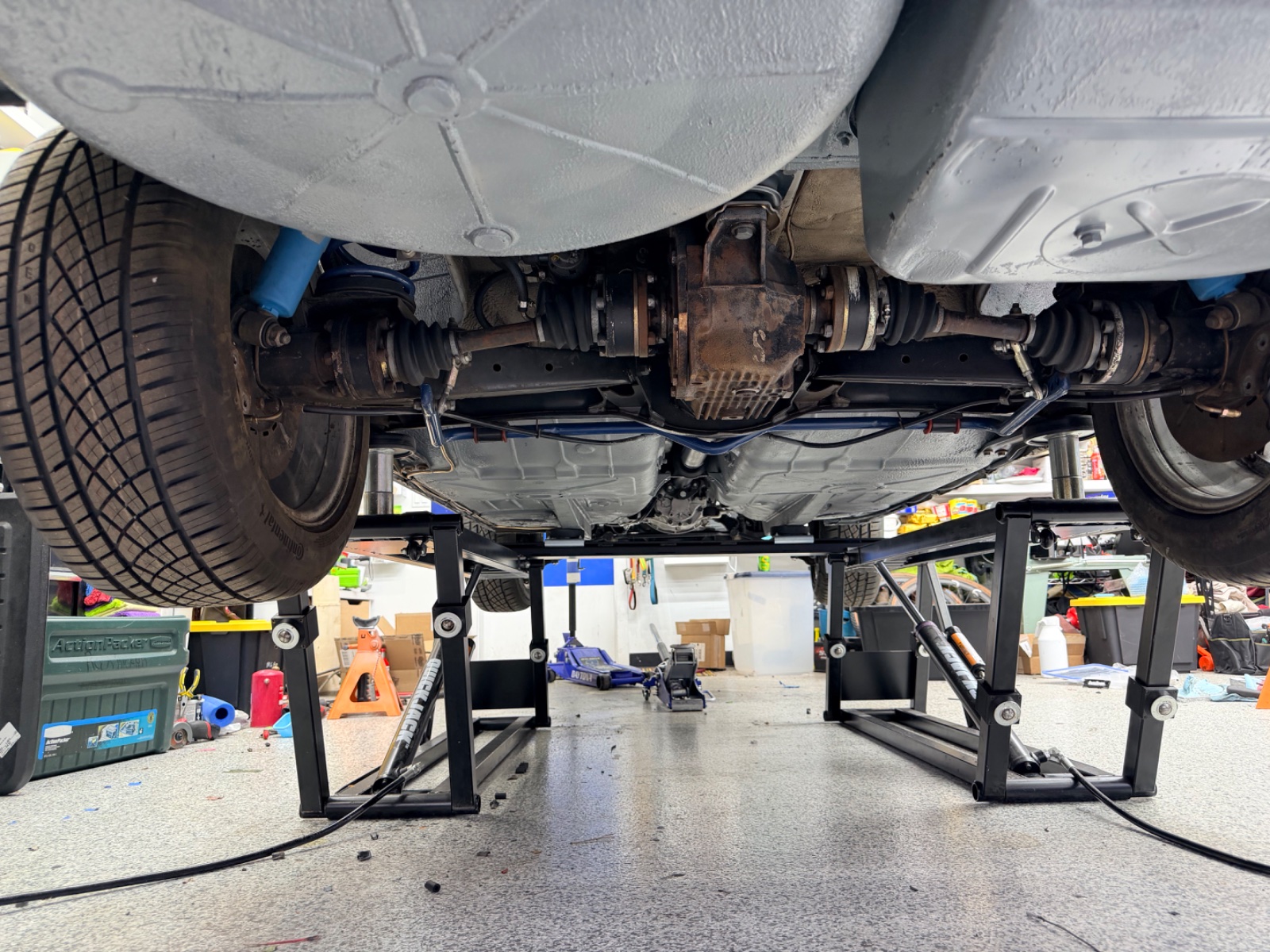

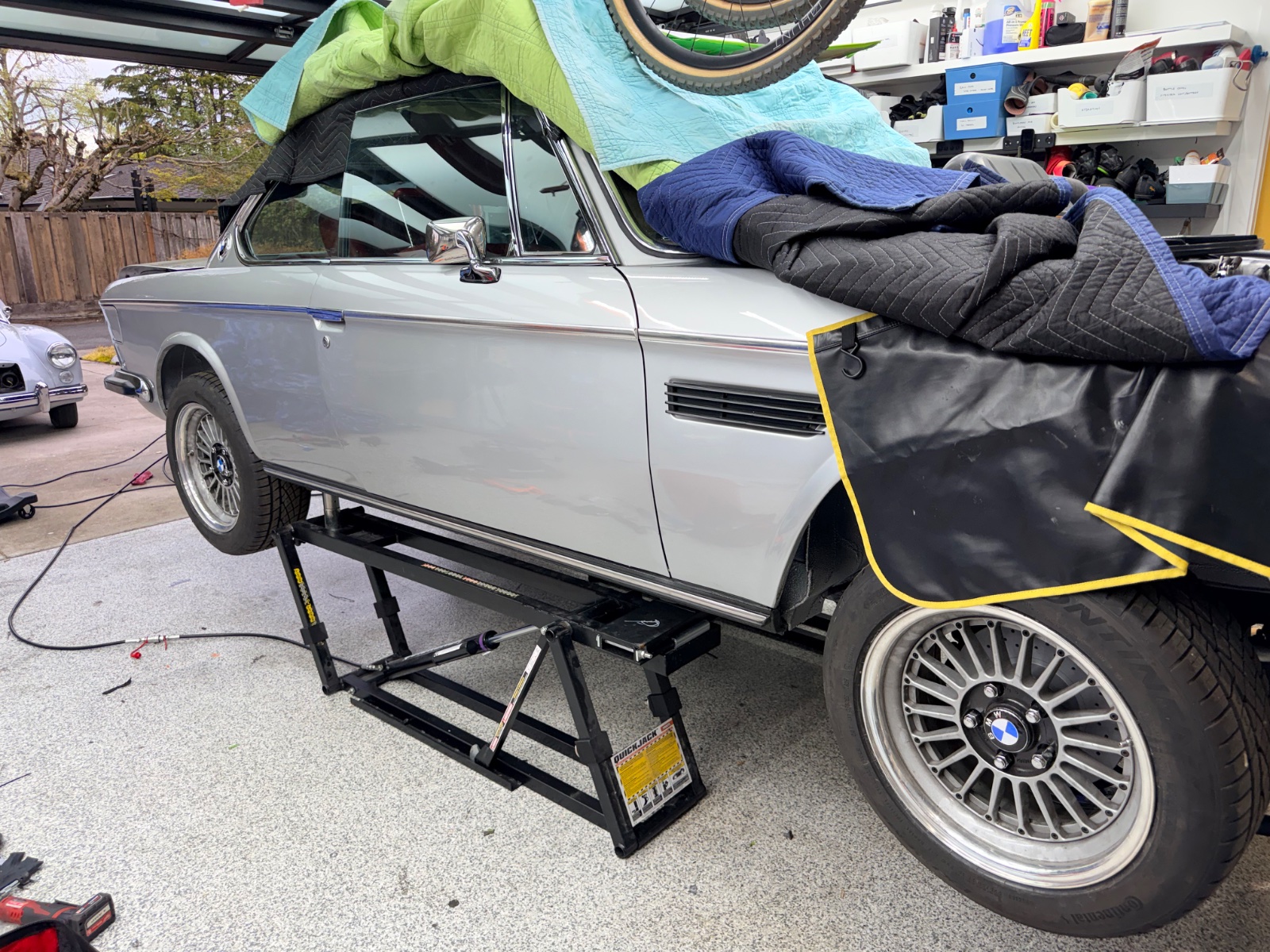

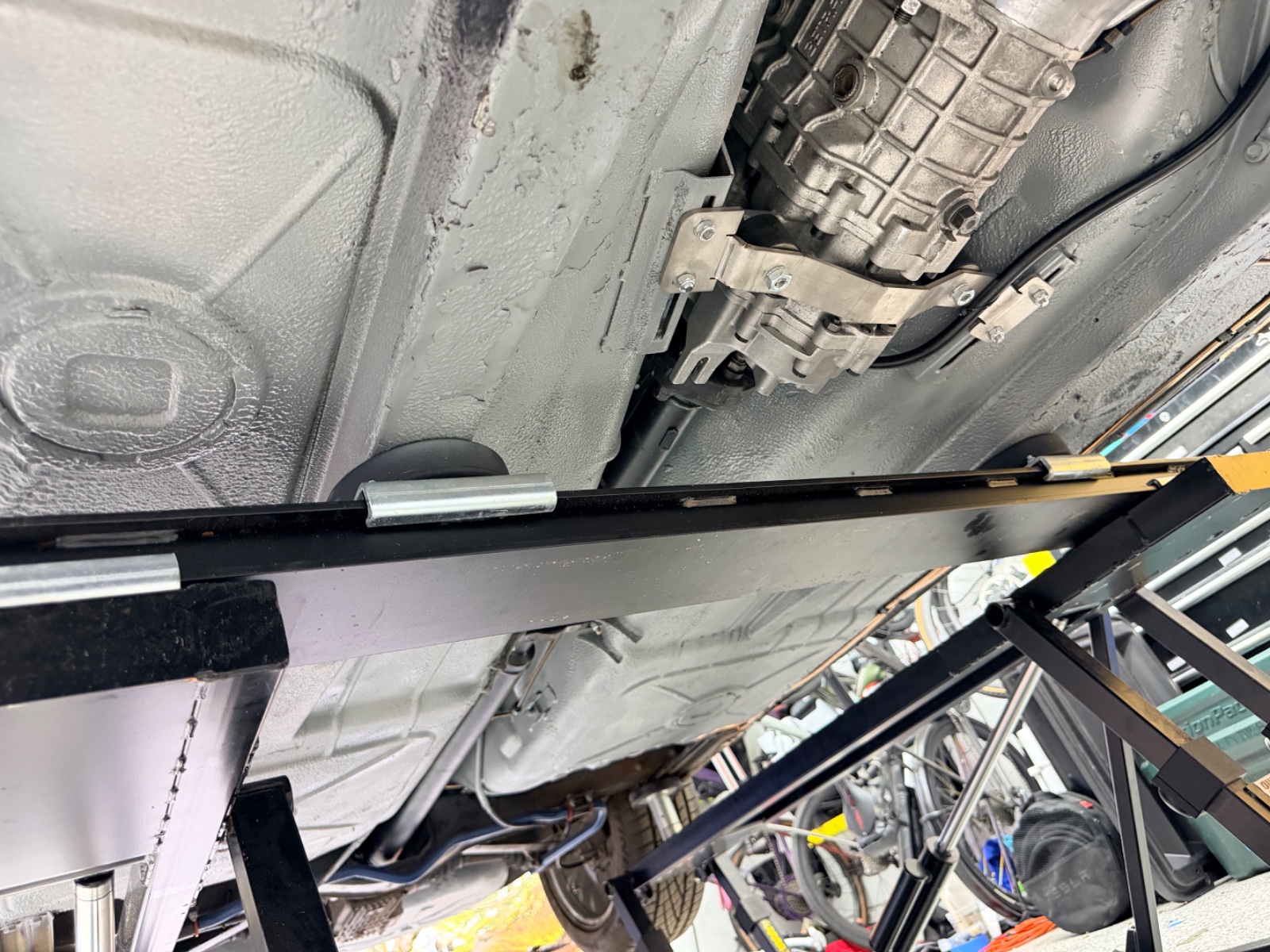

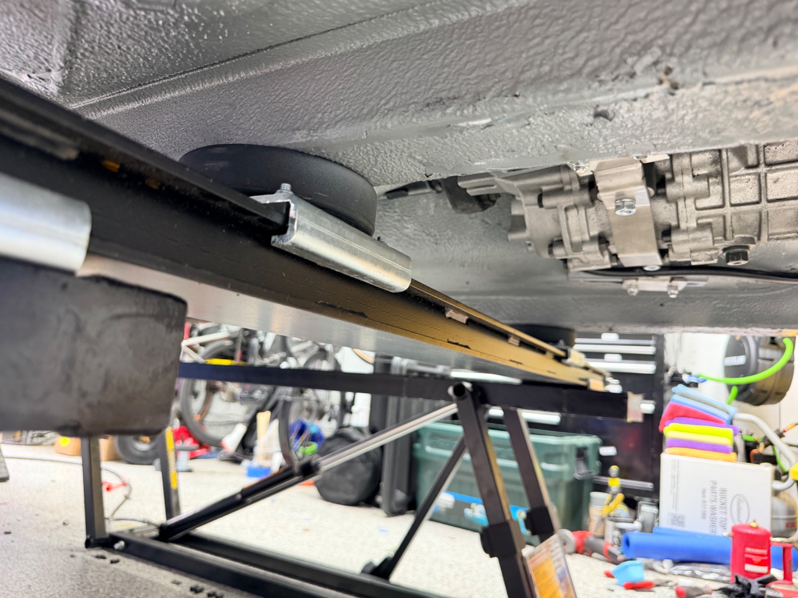

I had a quickjack for my other cars, overall works well, it's convenient if you don't have room for a full 4-post or 2-post lift, and is faster than jacking and placing jack stands, especially if you're going to be working on the car for a while, since you can lower it to access engine bay, interior, etc and then raise it to do stuff underneath the car. Up until recently, however, it wasn't a good option for an E9 because the ideal lifting points are staggered, with the frame rails much more towards the center in the front and then either the subframe or back end of the frame rail more to the side in the rear. Because the QJ lifts along a linear path, it needs the right and left sides to be parallel to one another. One option is using pinch weld blocks and lifting by the edge of the rockers or the weld seam, but again not ideal in our cars because the fuel line is right there on the driver side. IN the past QJ would have recommended that you place the two lifts running across the car rather than along it, and to have the front lift have its supports closer together than the rear lift. That works but is pretty wonky - the car lifts sideways and then you have two cross beams underneath the car. Maybe good for changing wheels or doing brakes but not ideal for any engine/drivetrain work.

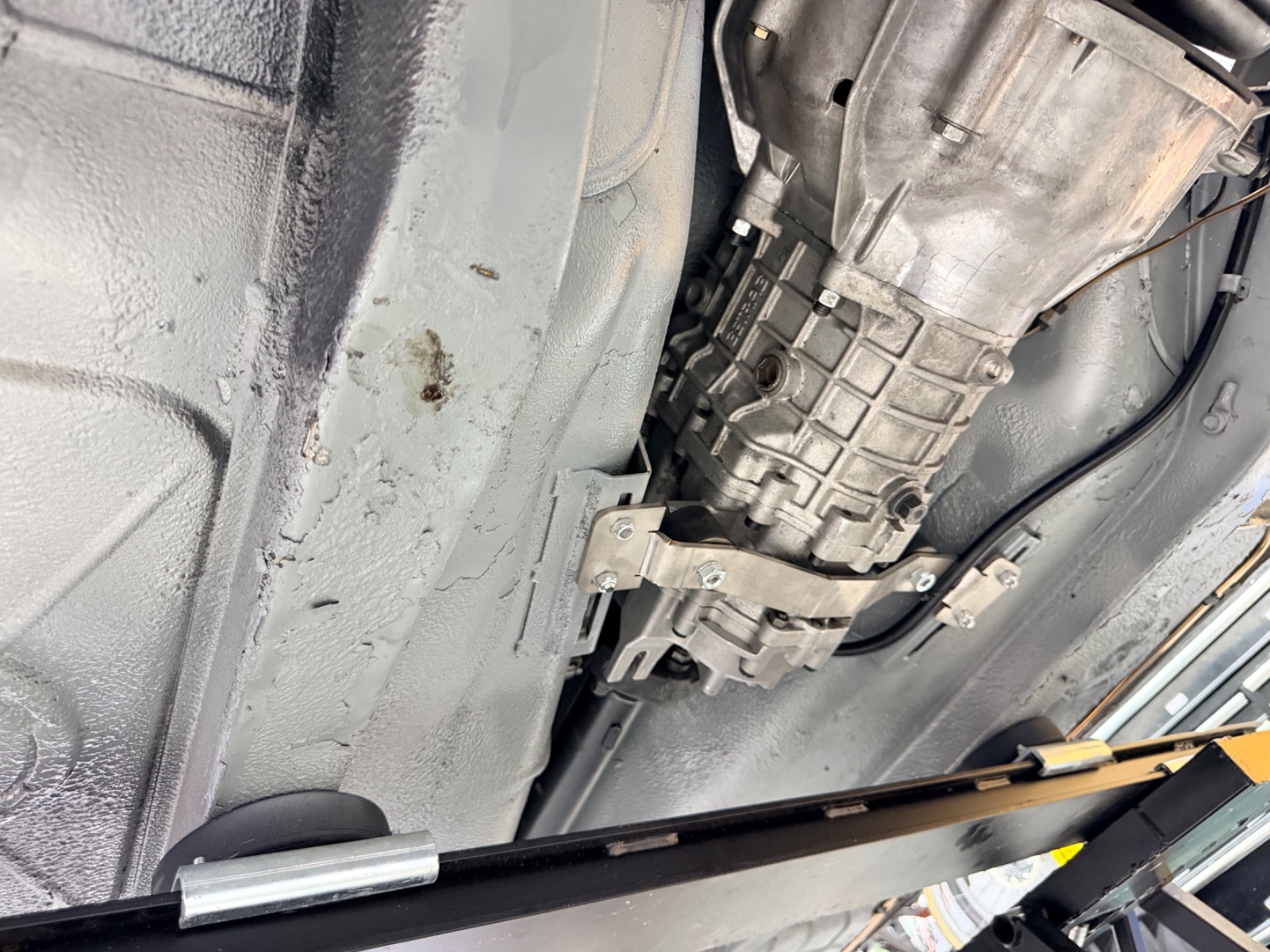

Earlier this year they came out with a crossbeam that spans the front portion of the two lifts and has sliding lift points so now the fronts and rears can be staggered from one another. I got it planning to use it for the E9 and my MG, and so far it works great. A few small issues:

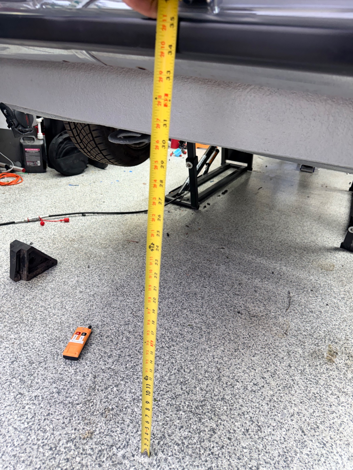

1. You still do have a crossbeam, but see the pictures below. When I installed my drivetrain today I did it with the standard jack stands, but I probably could have done it with the QJ. I think unless you're dropping the transmission it isn't an issue

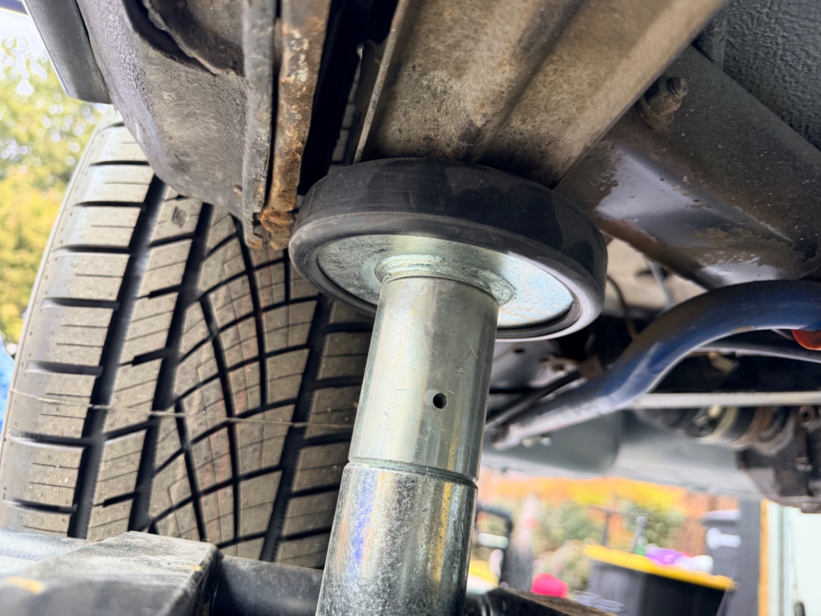

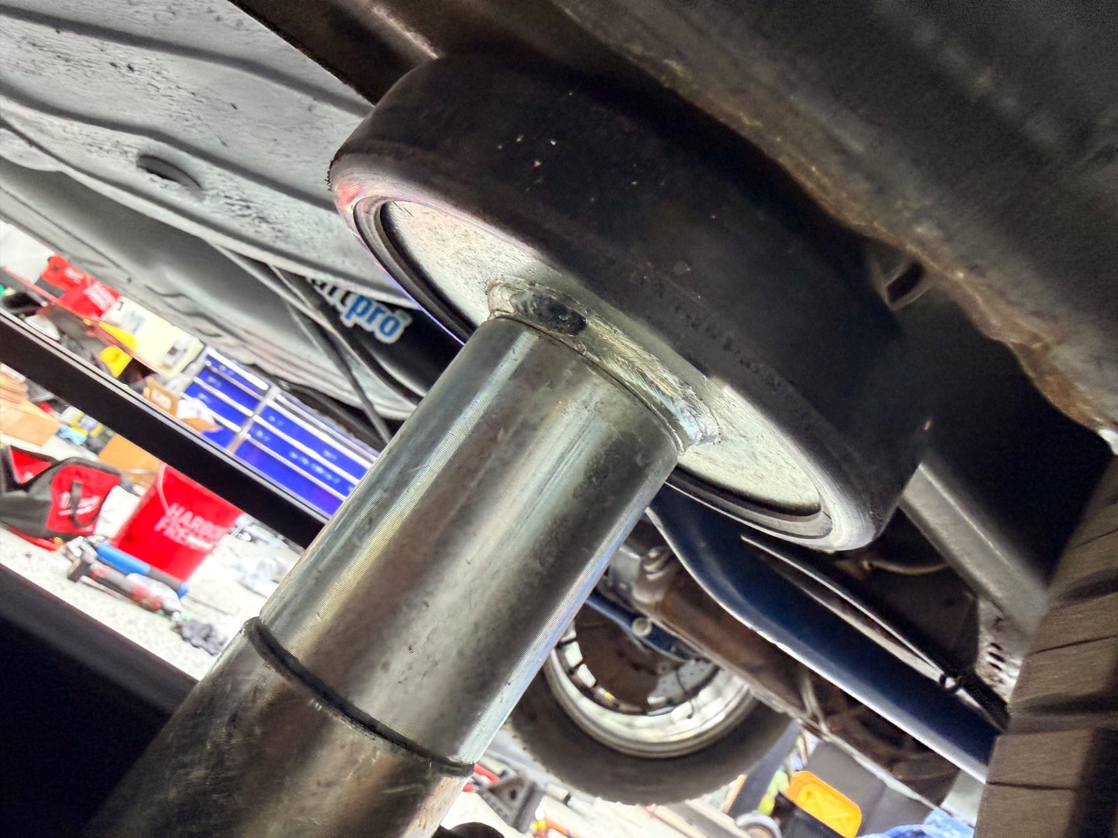

2. Setup takes a little bit longer. It was about 10 minutes, between positioning the lifts, orienting the crossbeam, etc. In addition, because the frame rail comes down fairly low, I did need to jack the front of the car slightly to get the crossbeam and the lift supports under there. But once it's set up it's easy.

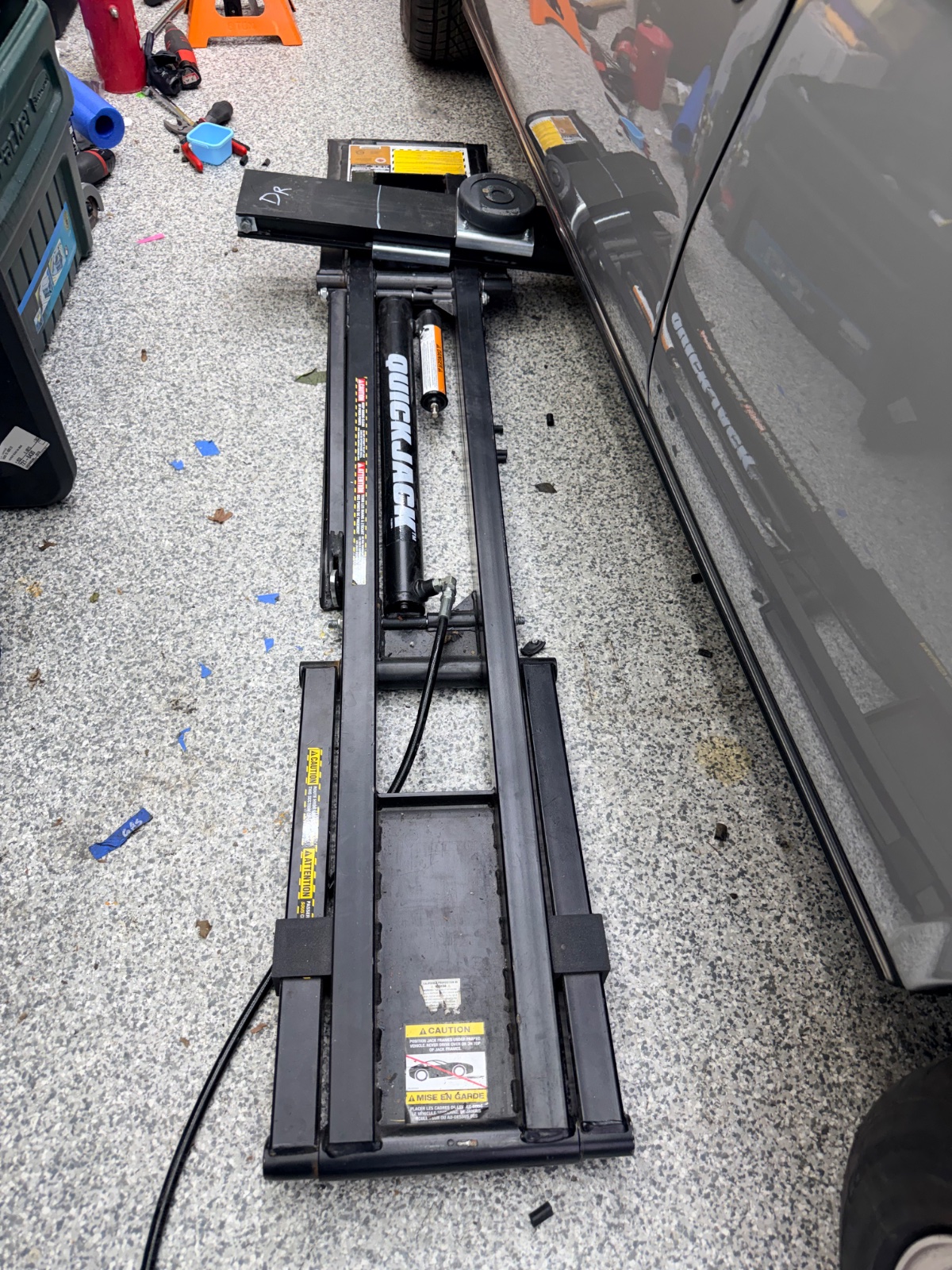

3. The crossbeam is very heavy. I have the 7000TL version, since I wanted to be able to lift my truck, so all of the parts are heavy. I had the wall mounts but found lifting the things onto the wall onerous. Instead I added casters to them so they glide easily, and in its disassembled state I can keep the two lift portions and the cross beam slammed together on the floor and just drive over them with the car. They clear easily and that's not space I'm using anyways since it's under the car.
4. Once you have the car lifted you can detach the hoses if you're not going to be going up and down routinely. I have the pump and hoses on a small Harbor Freight welding cart, so I tend to lift the car, detach the hoses and then push the cart out of the way if I'm going to have it lifted for a while.

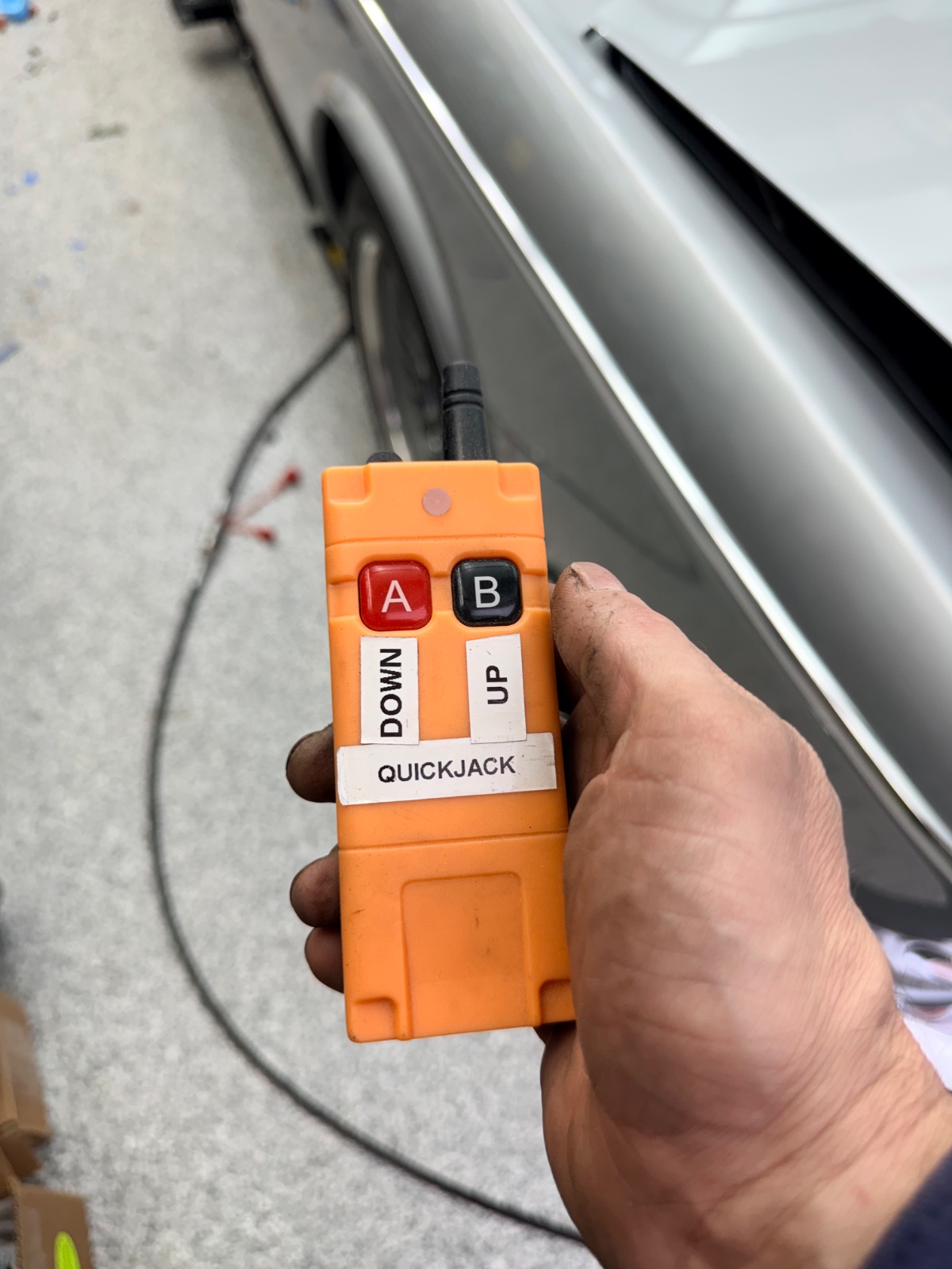

5. On the QJ facebook forum there are instructions for making the remote wireless. I HIGHLY recommend this option, since I can have the remote in hand, start going up, walk around the car, adjust, lower a bit if needed, adjust, etc. When the remote is wired you're a bit limited in your movement.
There's no way that this beats a full lift, but for those of us with garages that won't support a lift, this is a very viable option.

Be carefull not to place the front lifting point to far rearward. A front engined car is 'nose heavy', as is our e9.
With your QJ, do try and move the cross bar as for forward as you can - ideally as close to where the frame rails curve up into the engine bay.
In a fully loaded e9, the center of gravity lies about halfway between the handbrake mount and your gear shift. That's just 5 cm (2 inch?) or so away from the lifting point in the pics above.
Me thinks , if you lean your body weight on the nose to check the the distributor, it'll dive right off your QJ's
Amhik..
While unknowlingy lifting my car up on my tiny lift, I supported it too far rearward. A fully gutted car, but still with engine, so 'worst case' if you will.
As i lifted the spare tire from the rear I felt the boot tilt upwards under me. Dropped the tire right back. I could lift the rear with two fingers, balancing it on the front supports under the frame rails. Scary as hell.
Good point! I should have added also above that because the front lifting point on the QJ is starting higher than the rear, the blocks used for the front and the rear are different (and supplied with the crossbeam). With their rear block because of the way the frame sits, the car on my first elevation was tilted somewhat rearward, higher in the front than the back. Not by much, maybe 2 inches. For this time (and for the photos) I used the lift blocks supplied with my truck accessory package - they are slightly taller, by about 2”. So car looks level, which is good, but I guess the long and the short of it is that if you use the ones they supply, car may not be 100% level front to back but at least is slanted in a way that is slightly protective against your experience described above.
