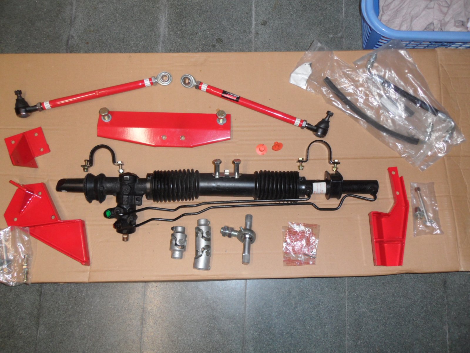

i'm installing a R&P kit on my C2 now.... remember me the days we looked at it for the E9 but was almost (? ) impossible without getting the firewall more aft.
Was surprized to see many brands who sell kits for the old Corvette's.... will be a great upgrade in direct, precise steering .
( on the E9 we inverted the steering rod and elongated the pitmann arm and idler arm with 35 (?) mm , that already give a much better steering . )

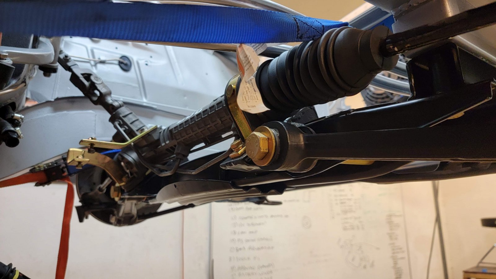

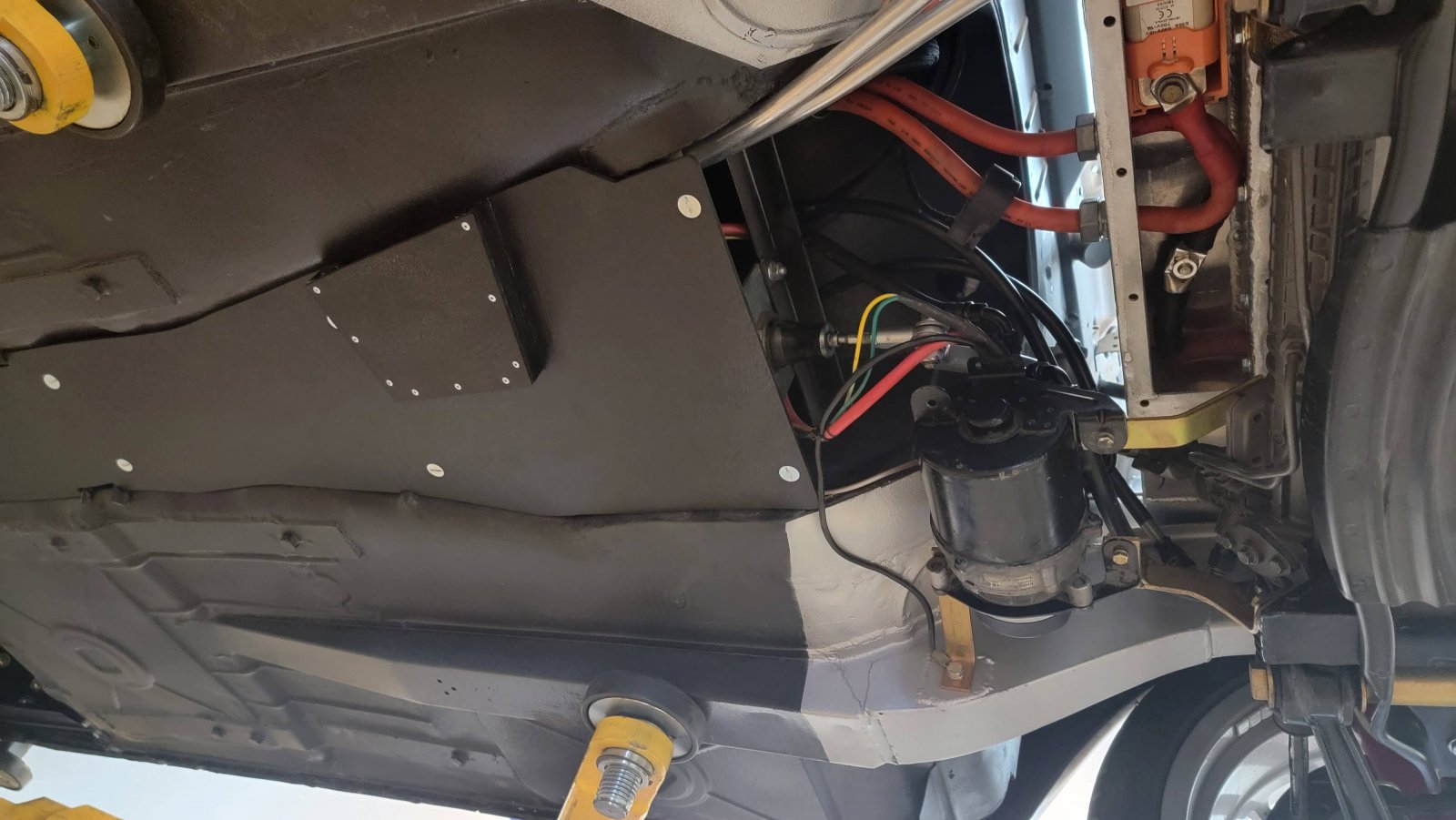

@JetDexter did it from scratch on the CSE using a rack from a VW Golf. Works great. Of course, this was to get more room for the battery box, and uses an electric P/S pump from a Mini Cooper, and certainly not a bolt-in.
