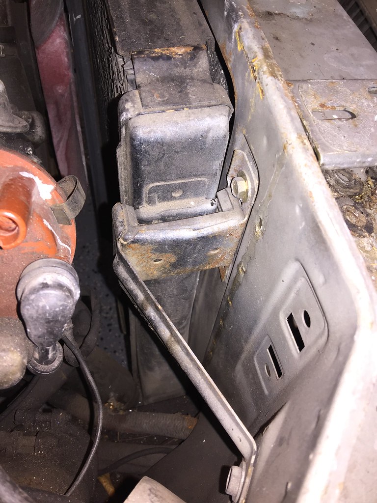

For some reason my car is missing its top passenger side radiator support bracket. Part # 41131820435 . They are nla - Anyone out there know where I might be able to find one.
The part number that you provided is for an auto. I have one available for a manual if interested. Here is a pic:
