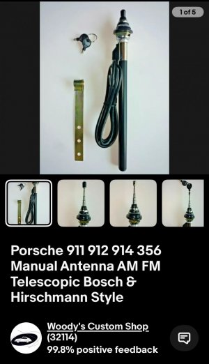

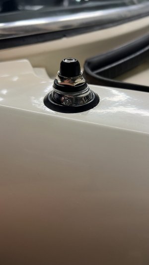

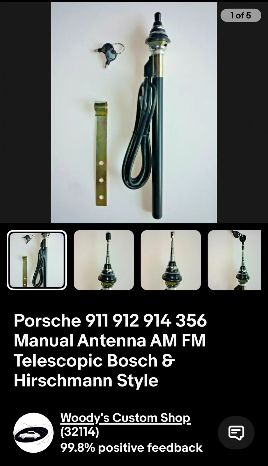

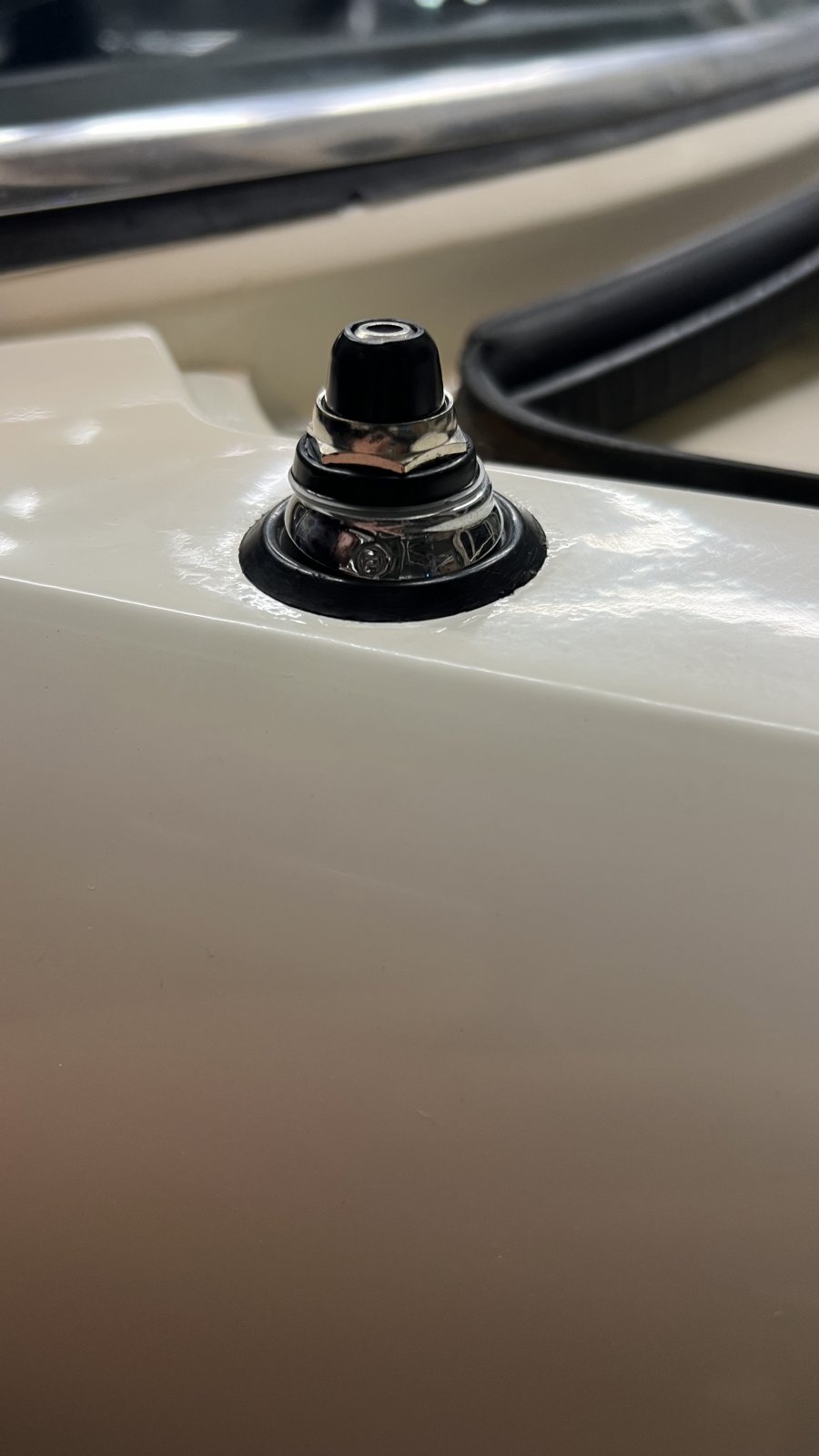

I installed one from eBay. It was a very close match to the Hirschmann that wouldn’t retract. I ended up using the “H” stamped piece and it fit well enough for me.
If installed on front fender, note that the inner fender comes off with five or six sheet metal screws. Clean it out while you’re in there.
