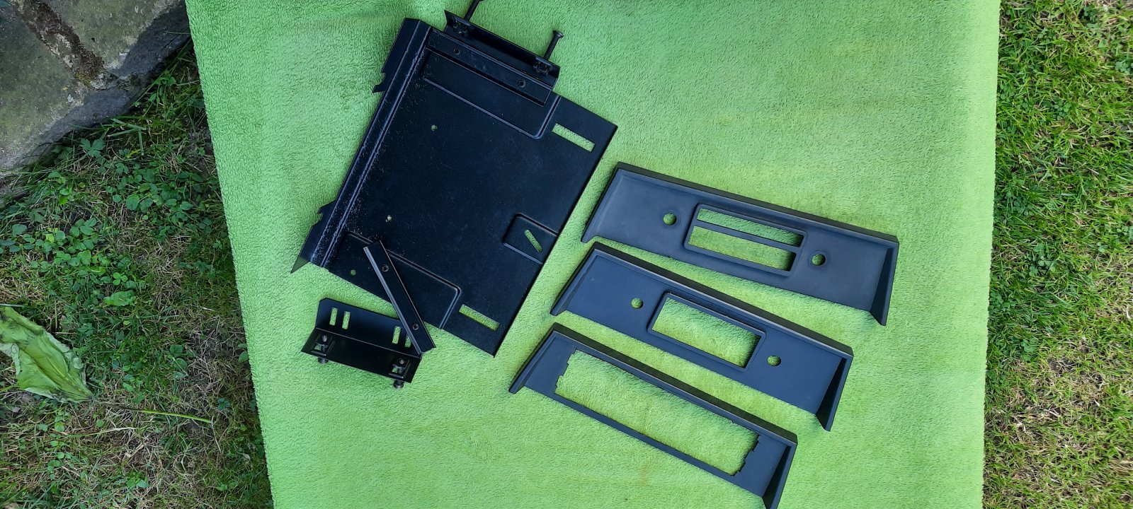

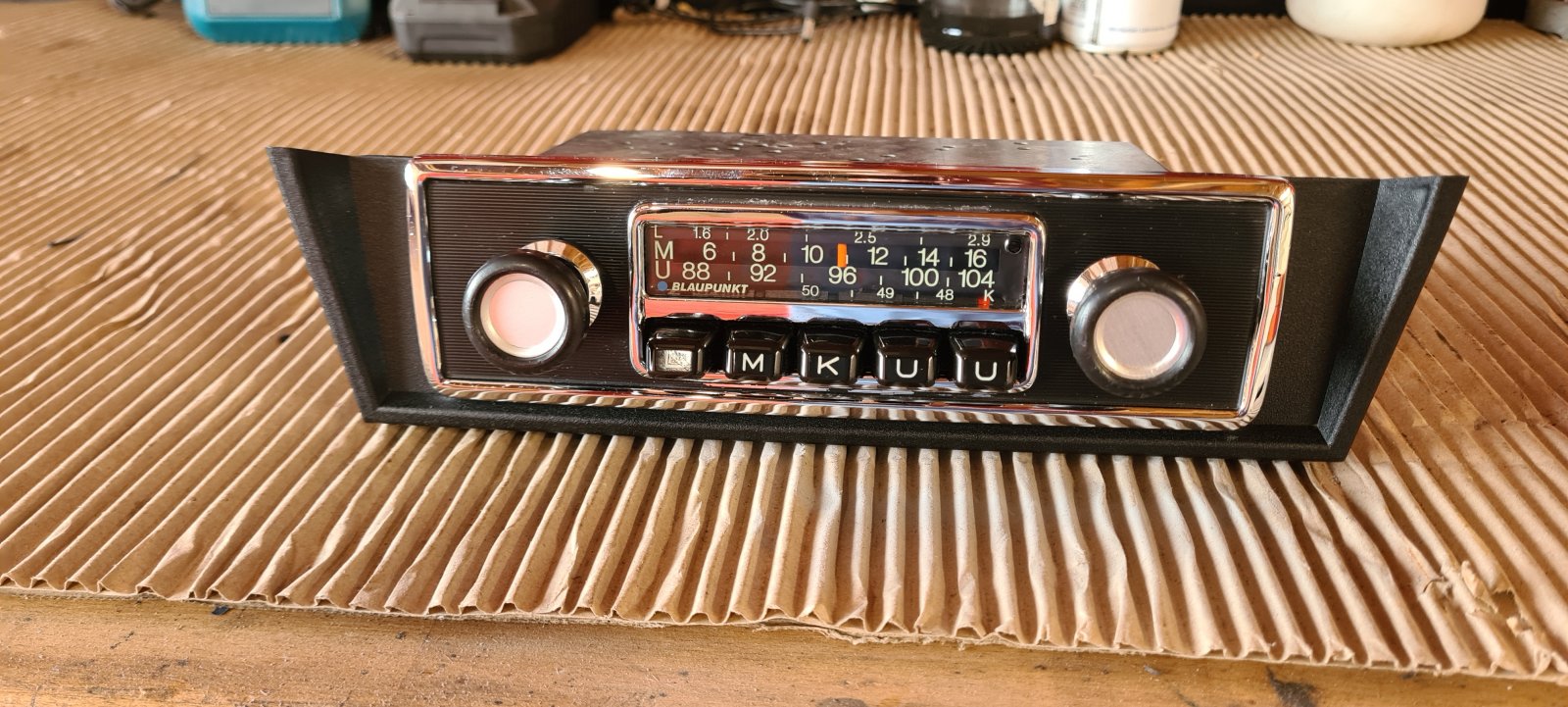

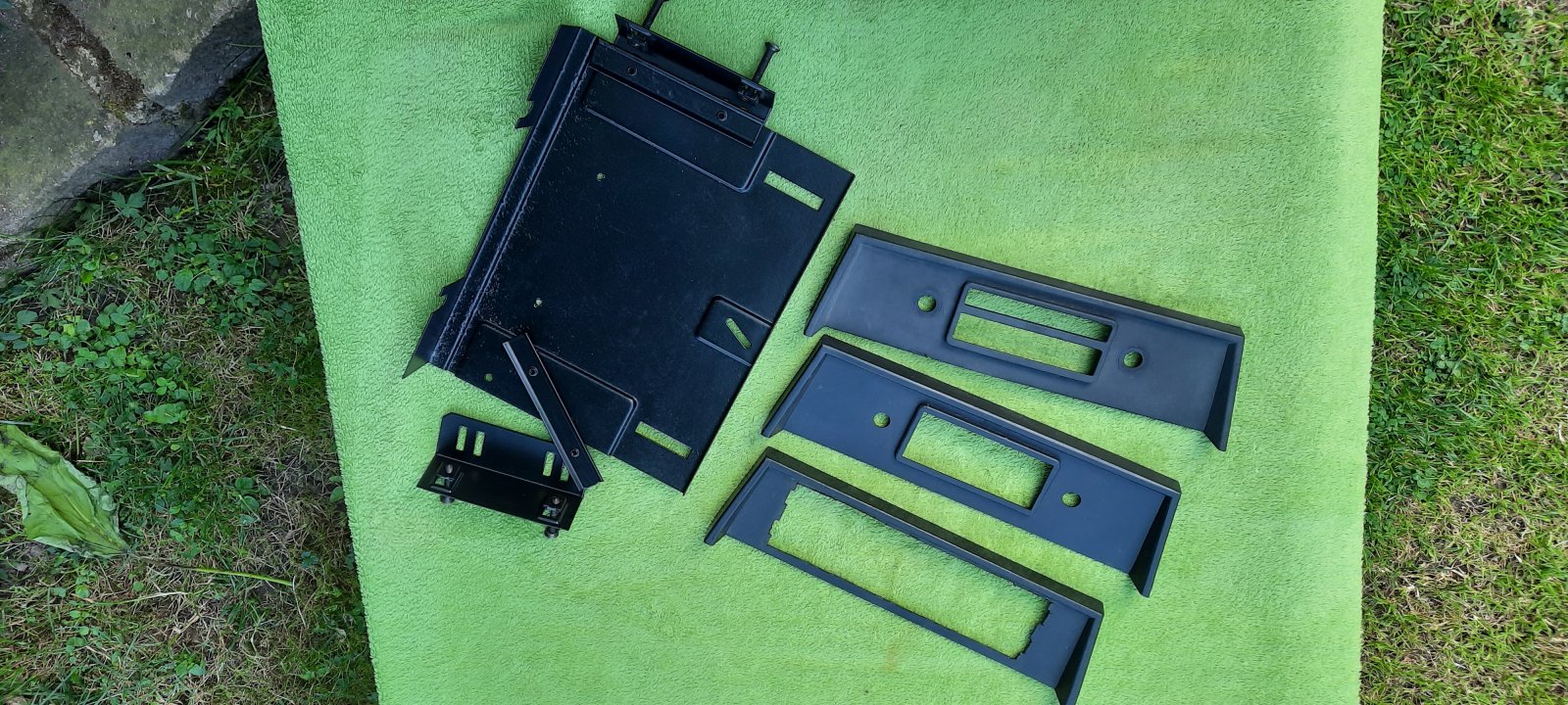

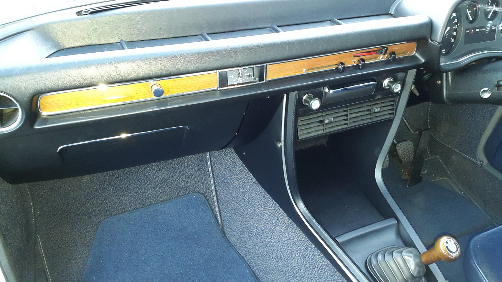

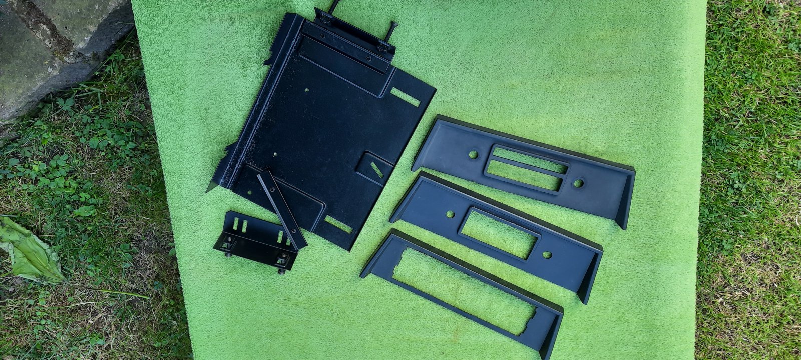

I have obtained a Blaupunkt Frankfurt set (with knobs matching those on the car) for my '72 E3 along with the correct facia panel matching the tapered sides of the console. I have various mounting chassis that I can adapt however my query is regarding how this is fixed to the console. I don't have AC so it looks like the plastic heater assembly is forming the top surface the radio would be against but presumably screwing into this is a bad idea. Is the correct method therefore to attach it to the vertical inner sides of the console ?. I'm not too keen on doing this either for fear of bursting through the console sides. I'm keen to see what others have done.
Alternatively is there a complete radio/speaker housing available that would just slot into the space below the heater ?.

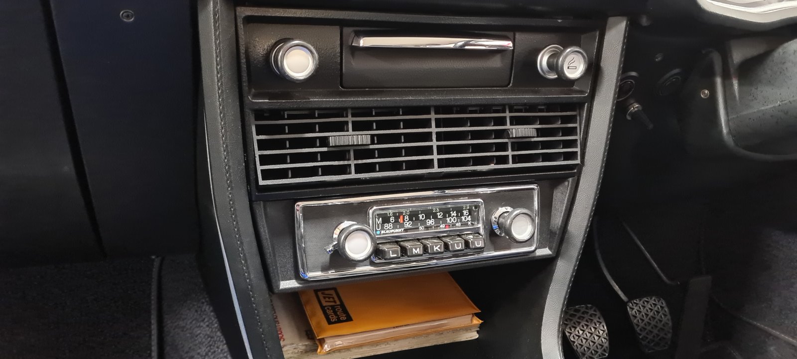

Very nice. How is it supported as I see no additional screws in the console sides or is this a dry run with the radio supported by the books below it?

on the left the support for the radio is shown:
Standard fixing is with screws through the side panels with the possibility of adjustment
If you don't like to drill holes you might fix it from the inside.
I have various radio supports available, just pm me.
Thomas
I mounted my radio bracket with screws on the inside of the console, more difficult & worth it.

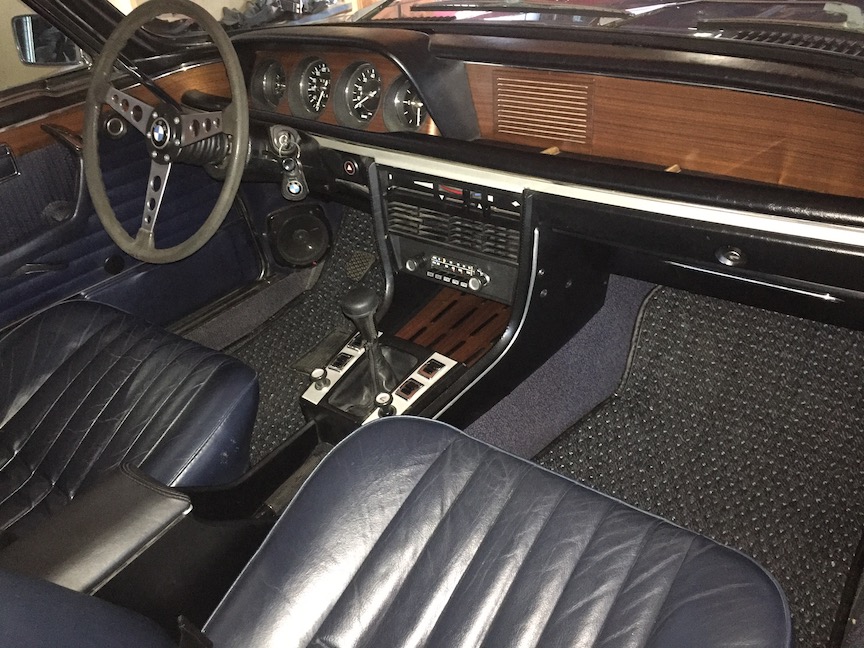

This is the speaker that's available through W-N, despite being listed for E24s 6 series.
With little ingenuity you could fabricate or perhaps repurpose an E9 speaker grill from the upper dash.
Just want to make sure I’m clear. Is the speaker part you link to above for the E3 upper dash or the E9 speaker in wood dash panel shown in picture?
Essentially yes, it's the shallow kick panel speaker on E24s &E28s.
Yes, dry run to achieve correct bracket position, now fixed with screws.

Thanks Thomas, I sourced the same mounting plate and front plate from another supplier in Germany
