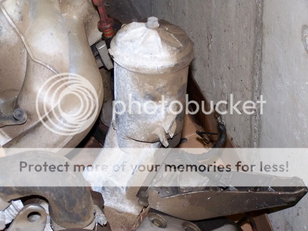

Mr. Healy. If you look at the photo I posted on the toothy wheel, you will see the offending oil filter can. Bad design as I saw it and I did not experiment with the part. I posted on this in the past. Thanks for bringing it up again however. I wonder how many engines are toast because of that cheesy check valve. Shame on the BMW engineers for this one.

I accumate a bit of scrap in this shop and try to recyle before it gets out of control. The upright can went away. If memory serves me correctly, the spring beneath the check valve was weak. So the idea that this to keep the can full makes sense vs a plugged filter by-pass.
Not sure though. That being the case, then why a slow pressure build up as Mr. Healy described? I was told that BMW upgraded the piece with a steel vs nylon seat and other improvements. Yet, Mr. Healy had trouble with the factory replacement as well.

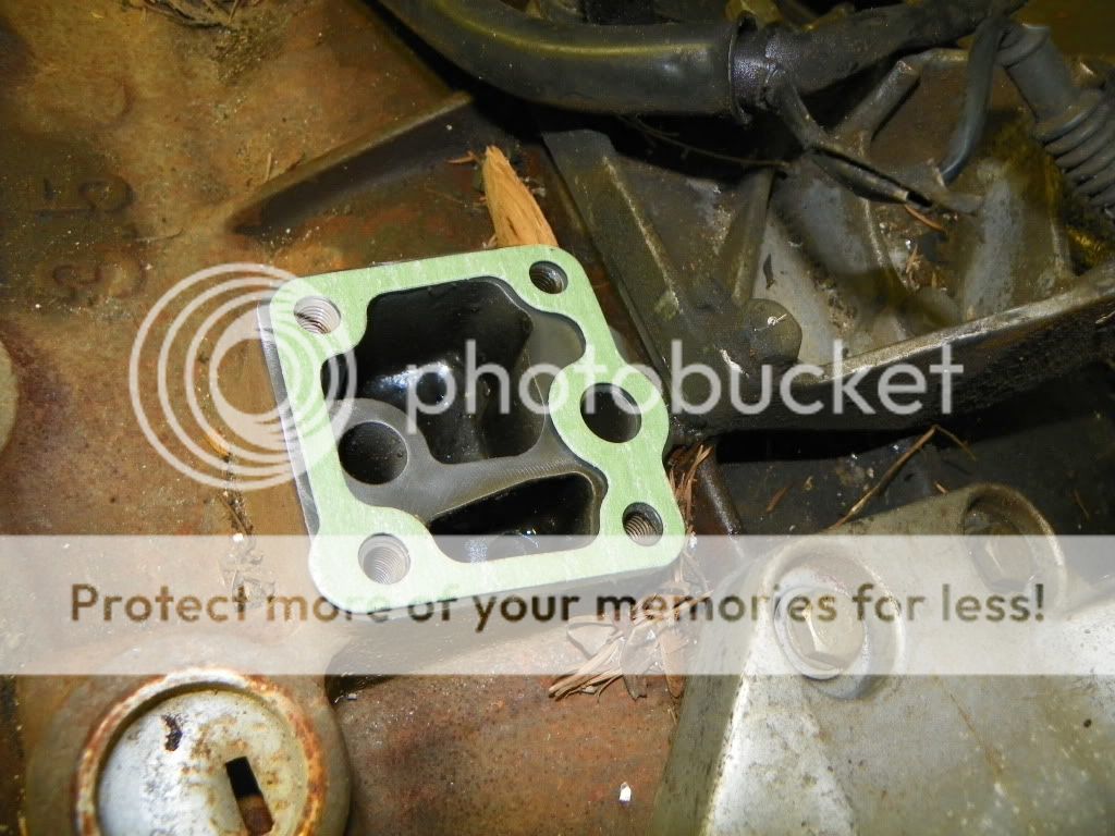

Gasket is different for sure, top or bottom bolt vs the upright can....The picture is of a 35 block w/ the gasket on use on my engine.(3.0 / 3.3) The offending can ....
What is for sure is that one needs to plug the 35 block to use the older top or bottom bolt can. This makes me wonder. If it were me and I was running the 3.5, I would do the block plug and run the old school can, convenience be damned. The upright can makes me nervous.
