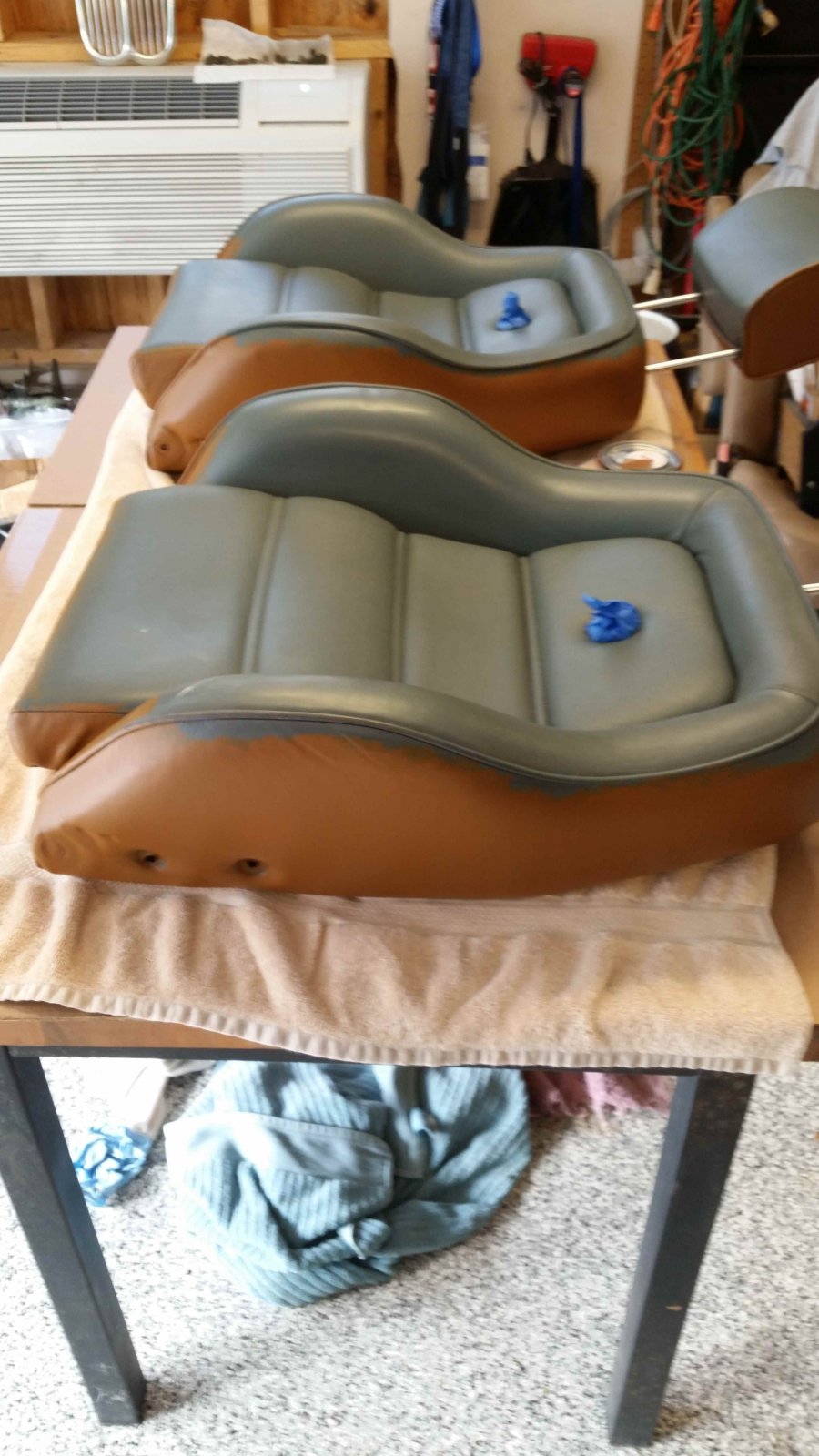

I second Gary's recommendations. And by way of emphasis, you need to clean and condition first, even if you are doing a color change.
Here is a picture of my front seats, part way through the process of changing the color using Colorplus dye:
