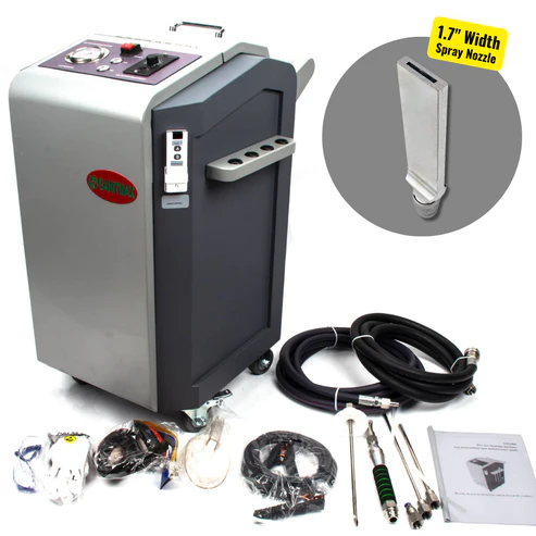

I'm impressed by the results on steel. But it really is hard to beat dry ice. Is there an affordable machine out there yet?
$13k for the machine but that is actually the cheap part. An air compressor that can handle the huge draw (100cfm pretty much continuously) as well as all of the moisture trapping and filtration is going to cost more than that, not to mention the power to run it and the media. You're going to pay $50k before you shoot your first pellet.
I think you'd have to work hard to get another $35k into the system....even if you had to buy an adequate compressor. Many home shops are already equipped with one that would meet the spec. Moisture trapping and filtration is already there with any hobbyist that paints. Media will cost more than that for traditional media blasters, but not THAT much more.

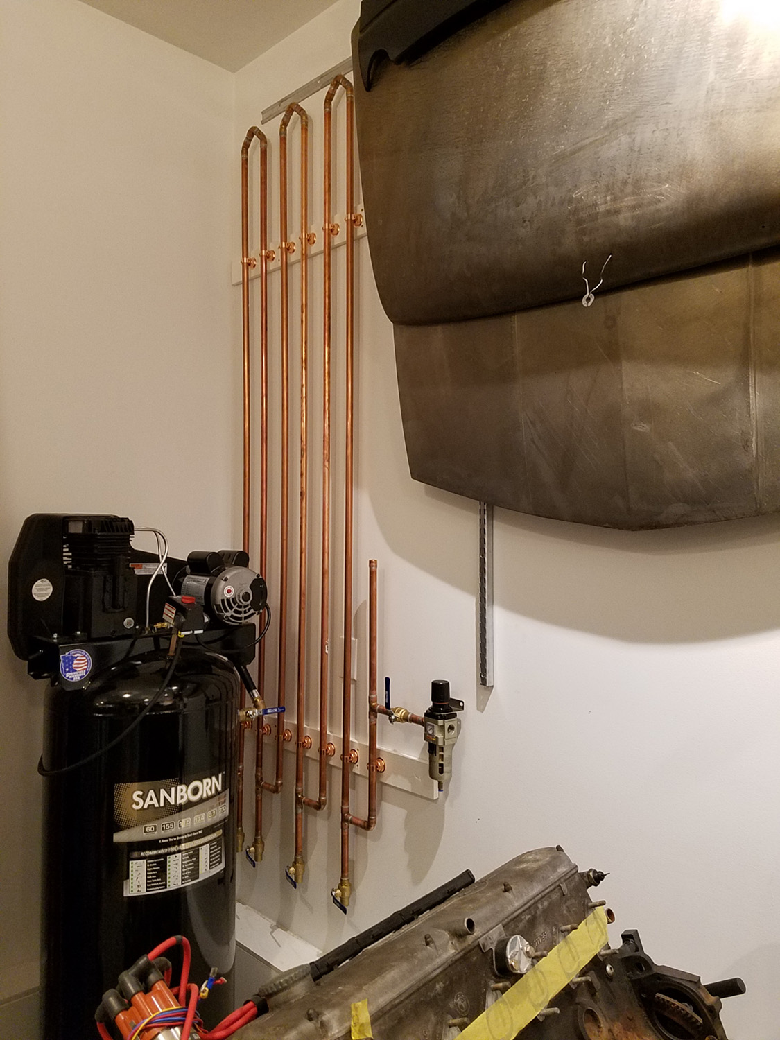

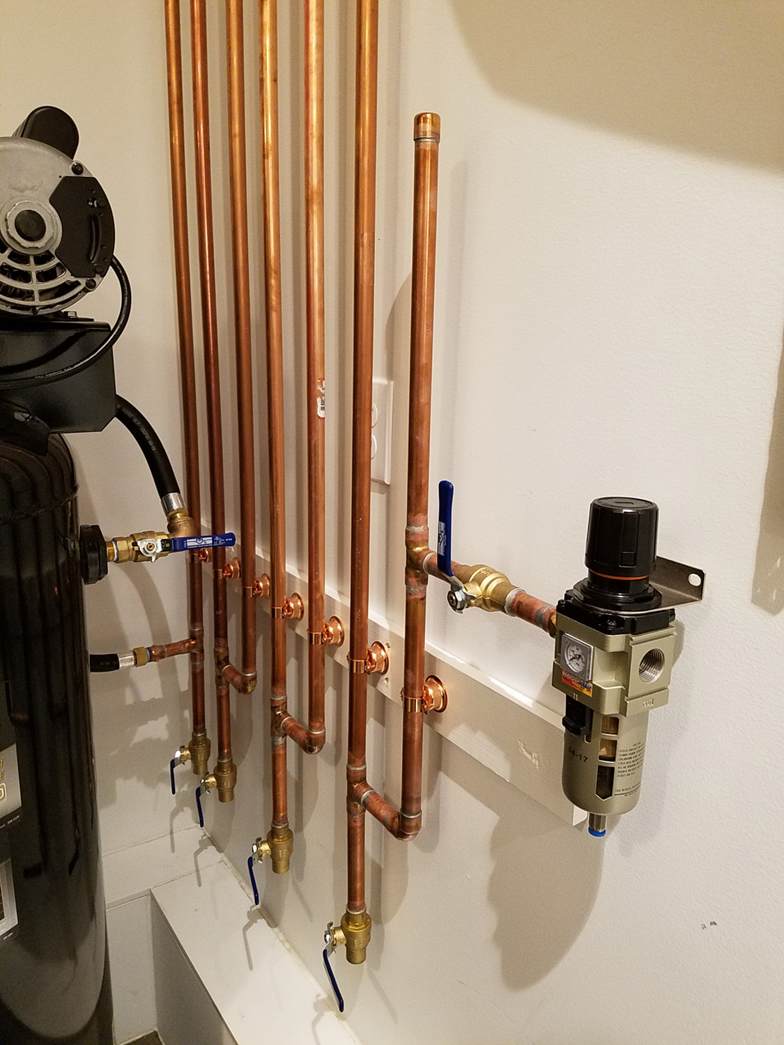

I think @autokunst made a nice dryer setup in his super garage. :)
Blush.
The air is pretty dry for not a lot of money and a few hours of time "sweating pipe". From here I ran a Rapidair pipe system that brings air outlets to two or three other locations in the garage mahal.
I have done a lot of research on this as anyone that does this work charges a huge amount of money for it. There's a lot of time involved of course, but in talking with professionals, the compressor is the most expensive part of the system. A guy I know in the NW just got up and running with a bunch of used stuff and it was almost $40k.
