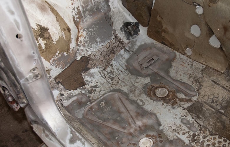

wkohler Well-Known Member Site Donor Messages 662 Reaction score 572 Location Phoenix, Arizona Jul 8, 2023 #2 Here is the mount in my E12 M535i. Only photo I seem to have that shows it.
bavarian Well-Known Member Messages 214 Reaction score 49 Jul 10, 2023 #3 wkohler said: Here is the mount in my E12 M535i. Only photo I seem to have that shows it. View attachment 164817 Click to expand... Thank you so much I have to say it looks so weird because the pedal bottom part looks so much bigger then that mount hole
wkohler Well-Known Member Site Donor Messages 662 Reaction score 572 Location Phoenix, Arizona Jul 10, 2023 #4 It slides in between the floor and the bracket. The hole at the top is only for the securing tab. E28 pedal goes in from the top.

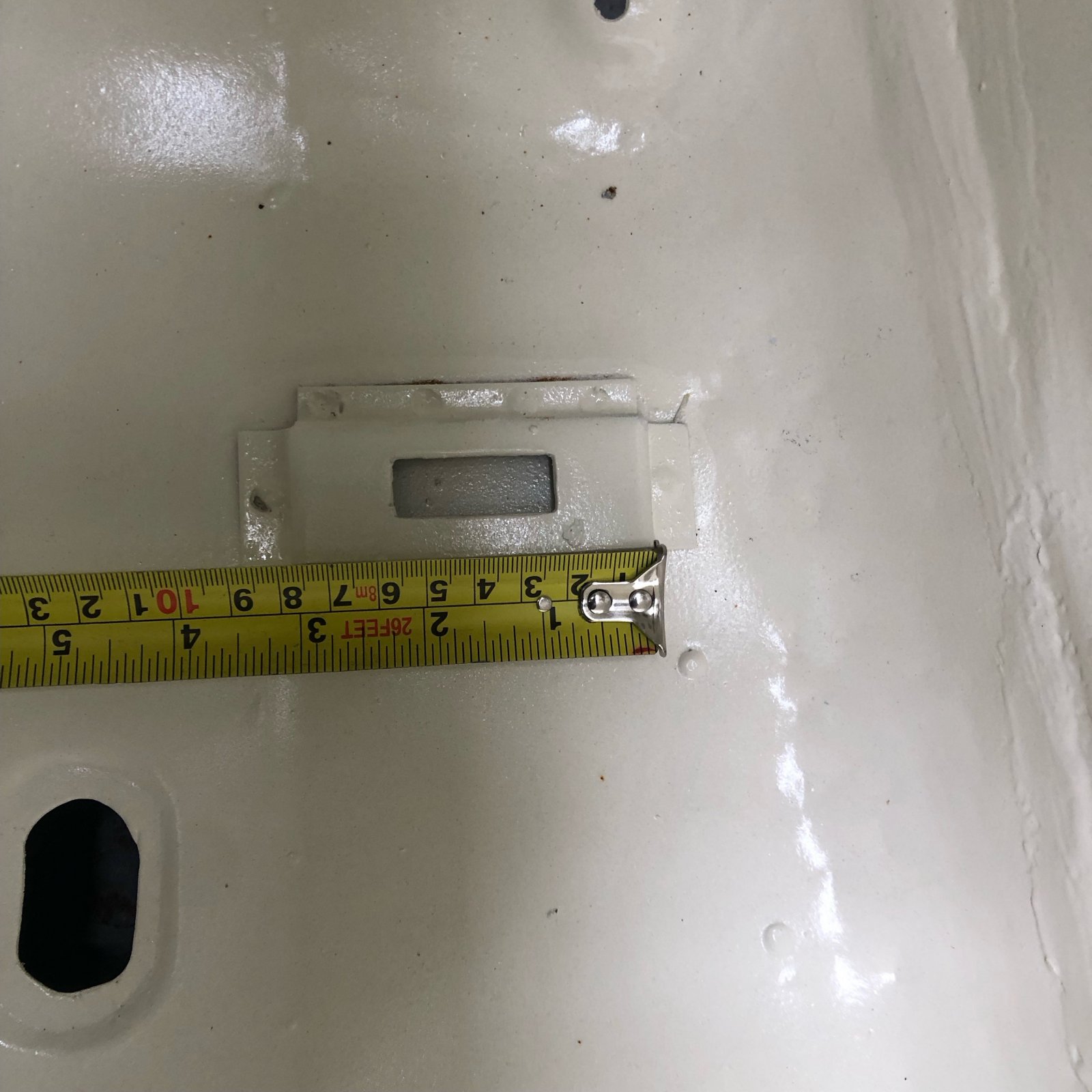

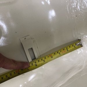

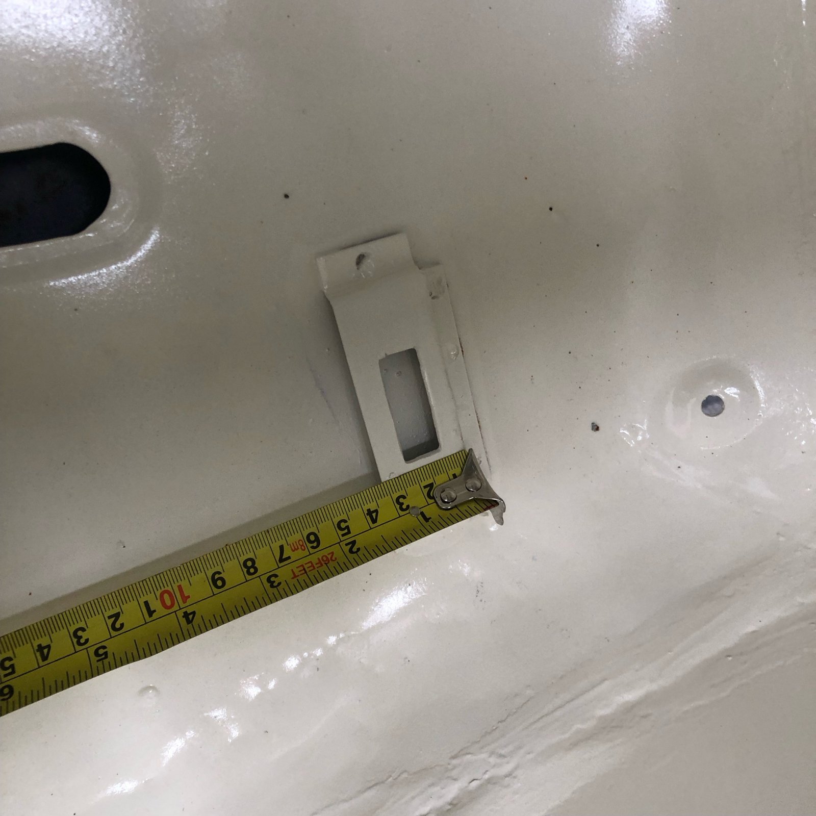

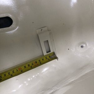

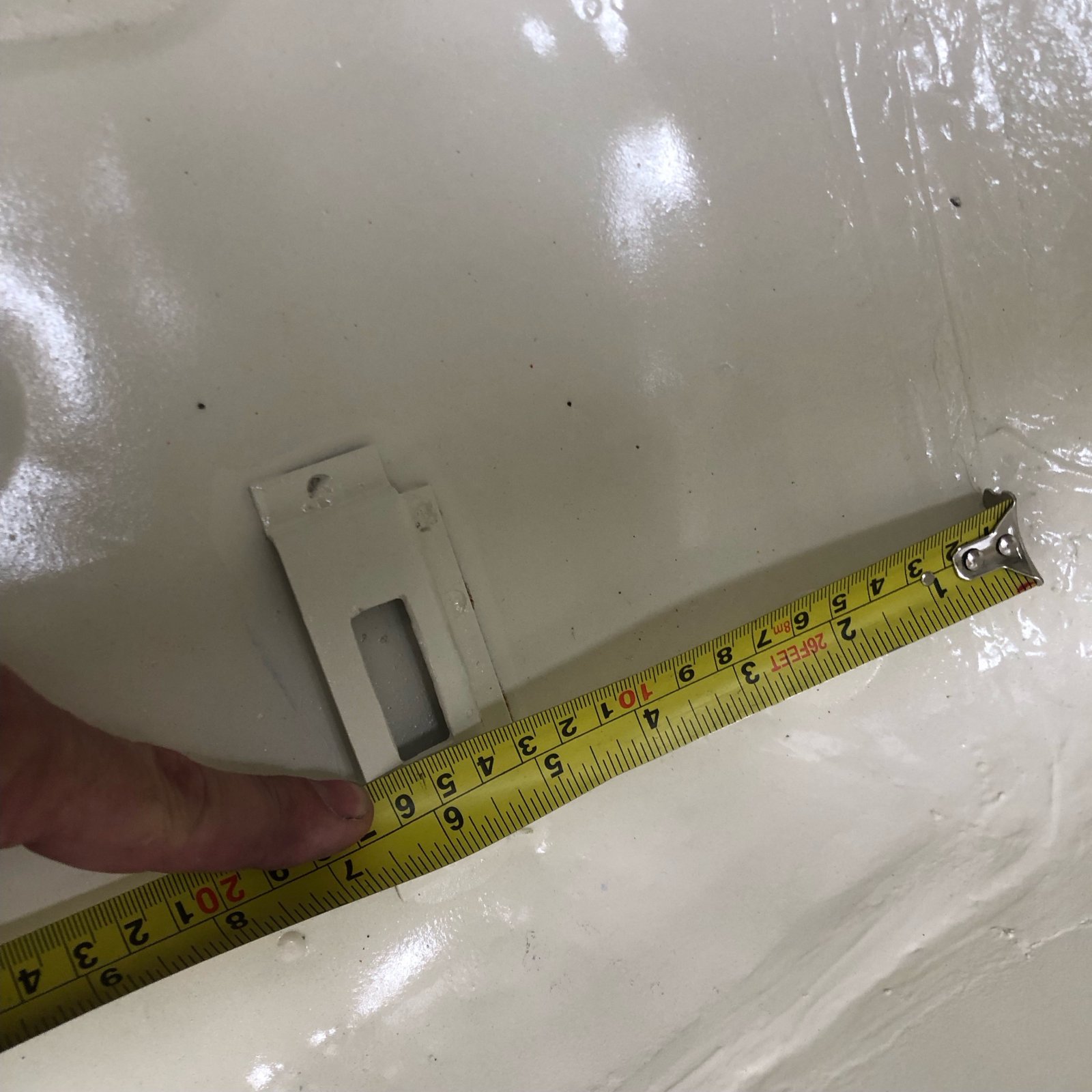

alprada70 http://www.oilsdesigngroup.com/ Site Donor $ Messages 1,352 Reaction score 915 Location Bogota, Colombia Jul 10, 2023 #5 look: Attachments IMG_8234.jpg 240.2 KB · Views: 172 IMG_8235.jpg 255.4 KB · Views: 168 IMG_8236.jpg 289.7 KB · Views: 171 IMG_8237.jpg 259.1 KB · Views: 191

bavarian Well-Known Member Messages 214 Reaction score 49 Jul 10, 2023 #7 Wow thanks for all the help , measurements.. yeah I can definitely make one myself thanks again
