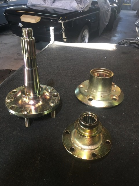

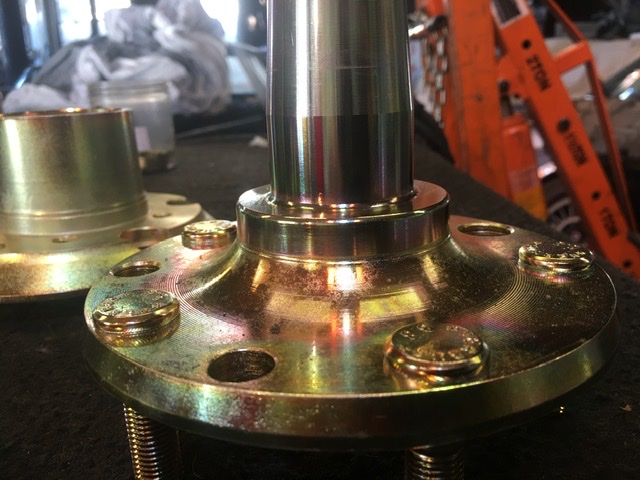

I'm working on a 73 e9. I dissasembled the rear arms for powder coating and as it were it was missing spacer # 10 in the diagram linked. This supposedly goes where my pic is pointed in my picture below. this part number is no longer available so i need to machine my own. I'm hoping someone can provide me with the width. Is this spacer press fit or does it slide on and off by hand?

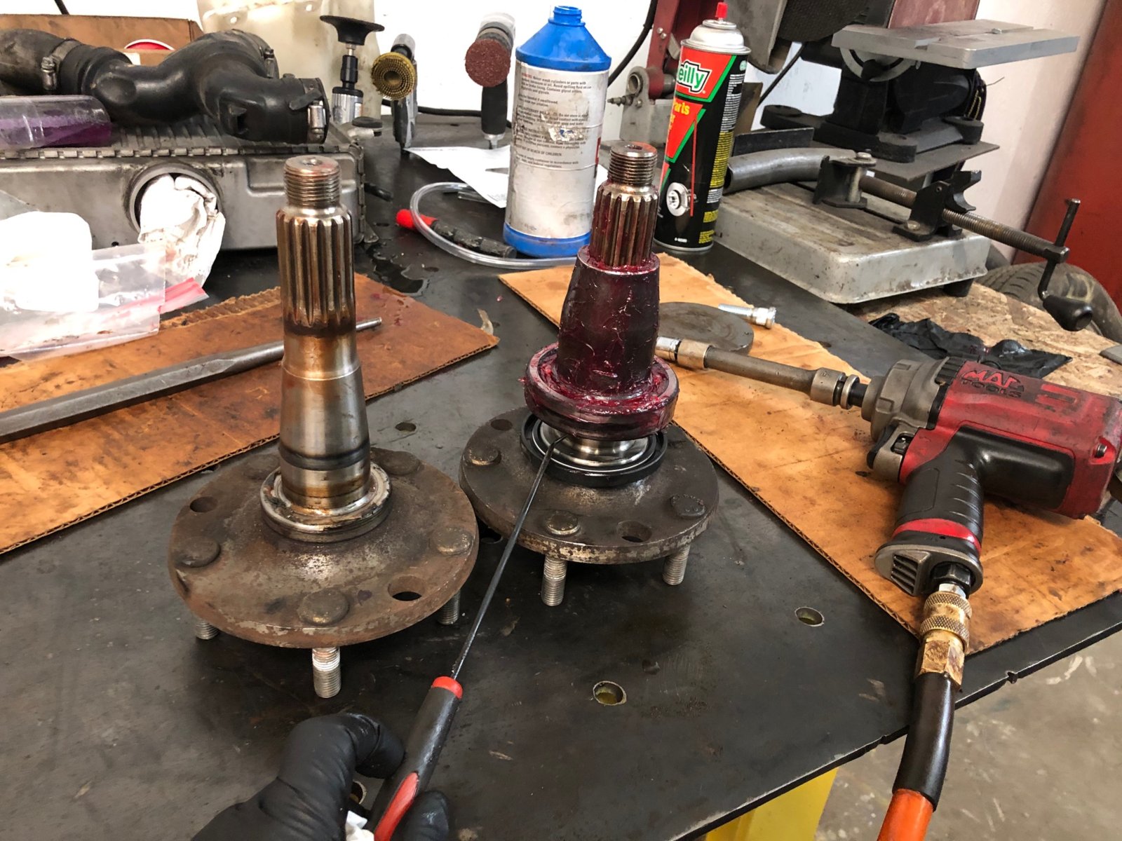

Can someone please help me out with how to calculate the shim thickness needed? Upon disassembly I made the mistake of not labeling the two shims and they are different thicknesses so i'm unsure as to which one goes on the driver side and vice versa.
I found this formula but i can't seem to find what A, b and c are as the blue book doesn't seem to be available anymore.
What the manual indicates is that the spacer C must equal (A-B)-.1mm
The case the manual cites is (63.5-58.6)-.1 with the result=C or 4.8mm

Best of my knowledge that spacer has never been available
It is permanent part of hub

Can anybody confirm the shim dimension formula i found below? What measurements is A and B referring to?
Wait a minute now, Don, you are showing 3 parts in your picture, there are only 2 pieces that you use the top piece goes where? ( looks like a 2002 hub ) There has to be a shim in there If you don't run a shim The bearings will be under a load from tightening the stub axle to the inner hub You have a spacer ( #7 ) in between the bearings that has to have a certain amount of clearance You have a bearing on each end, spacer/shim ( #6 in realoem ) at the inside of the inner bearing, the large spacer tube (#7) between the bearings, and that one needs to be calculated after putting in the outside bearing first, then fitting the large spacer /shim Then you have to measure the distance from the inner part of the outer bearing to the outer edge of the shim/spacer You then measure the length of the large tube spacer ( # 7 in releom ) and you need to be slightly larger measurement than the spacer tube to allow for the correct clearance between the bearings You get the correct clearance by changing the shim ( #6 ) to get your .1mm clearance Does this make sense to you ? I can do it without thinking that much but sometimes have a hard time to explain it

The third piece in his pic is the front hub for these cars. Yeah i can see how explaining it can be difficult...What a tounge twister

So it sounds like the formula I have is not correct if we're trying to achieve .1mm clearance.
That helps a lot thanks I think i can get it figured out.
