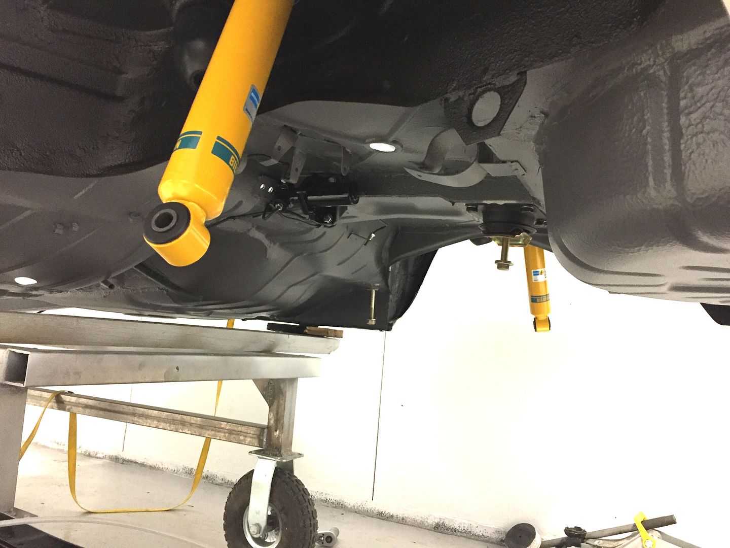

I need some help - the pipes were taken off by someone else when the car was stripped. The fronts pipes are obvious, but what route does the rear pipe take from the servo to the balance unit?
I've tried to look for photo's, but any info would be appreciated.

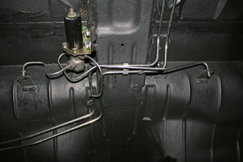

Left hand side of the car over the rear cross beam. PM your email and I can send you some photos.

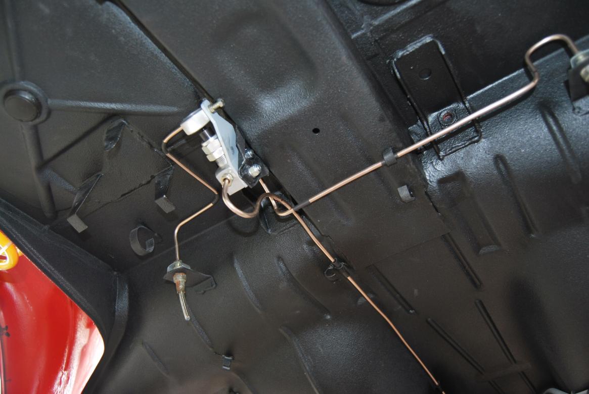

Here is a couple of pictures from my car, if it helps?:
Cheers,

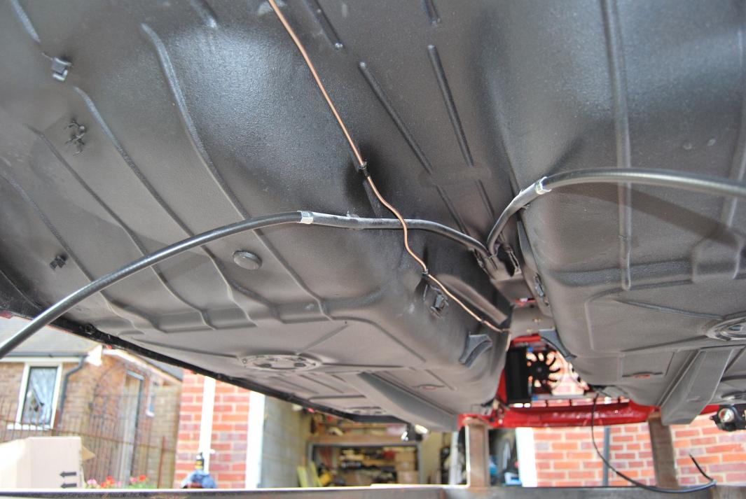

Here is a photo of the rear routing. The routing along the underside of the tunnel follows the small tabs. There should be a rubber sleeve around the pipe at each of these tab points.
