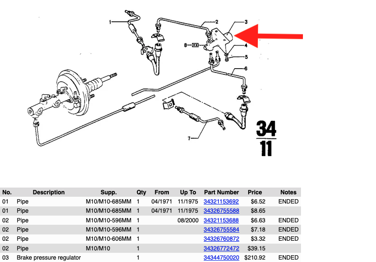

Agree that the Proportioning Valve (Prop Valve) should be rebuild / replaced while you're at it
On a typical brake system (depending on Wheelbase, CG Height, Tire Rolling radius, Brake Effective radius, etc. etc.), the Fronts do between 70-80% of brake work (Rears only about 30-20%). Until ABS/ESP days, systems were front/rear split system (like this one) or cross-split brake system.
Different Prop Valves have different input / output curves to manage (avoid) rear wheel lock-up.
If Prop Valve malfunctions, you'll loose the desired system balance (& stability) during braking. For sure not good when coming down from 100mph, but could end up locking up the rears (or put you in a tail spin!) at much lower speeds on wet or slippery surfaces.
