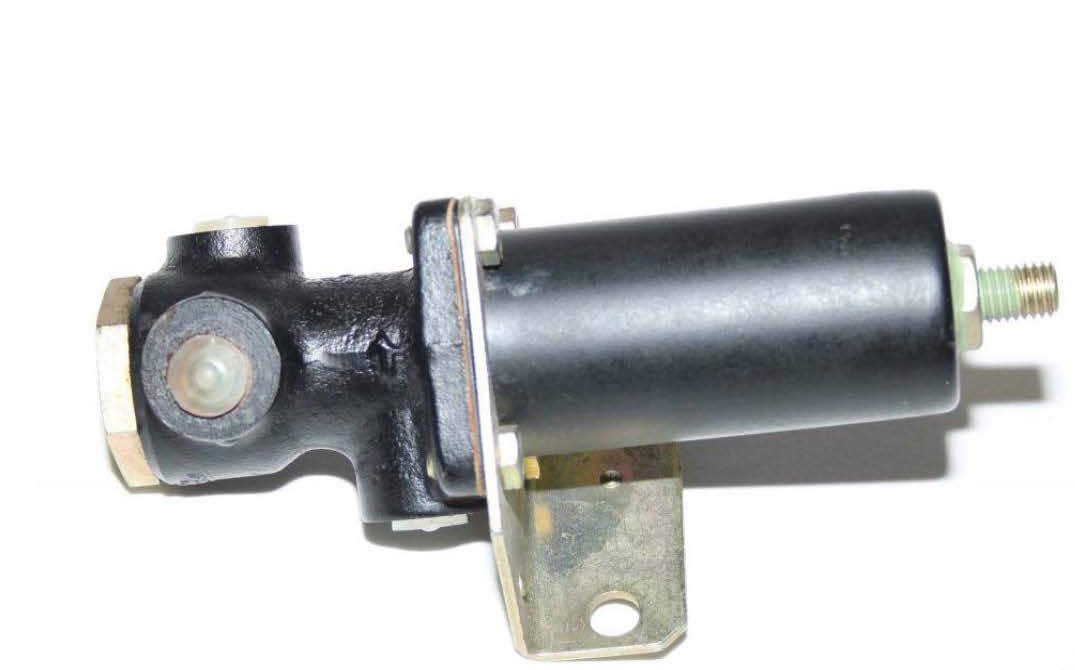

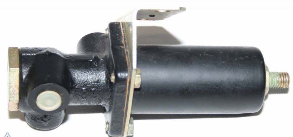

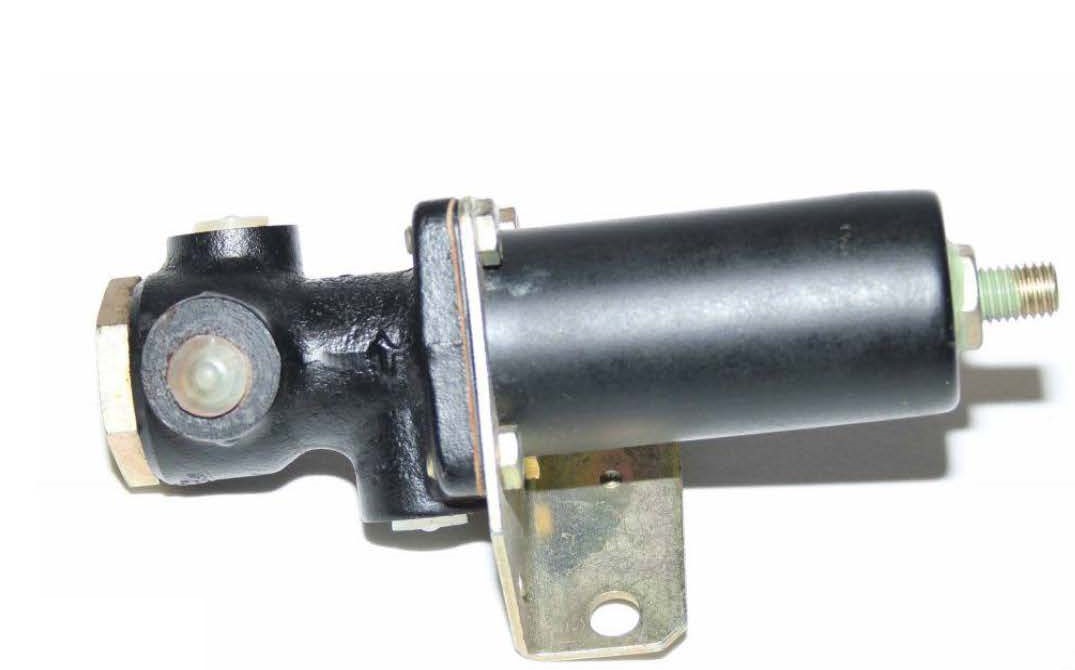

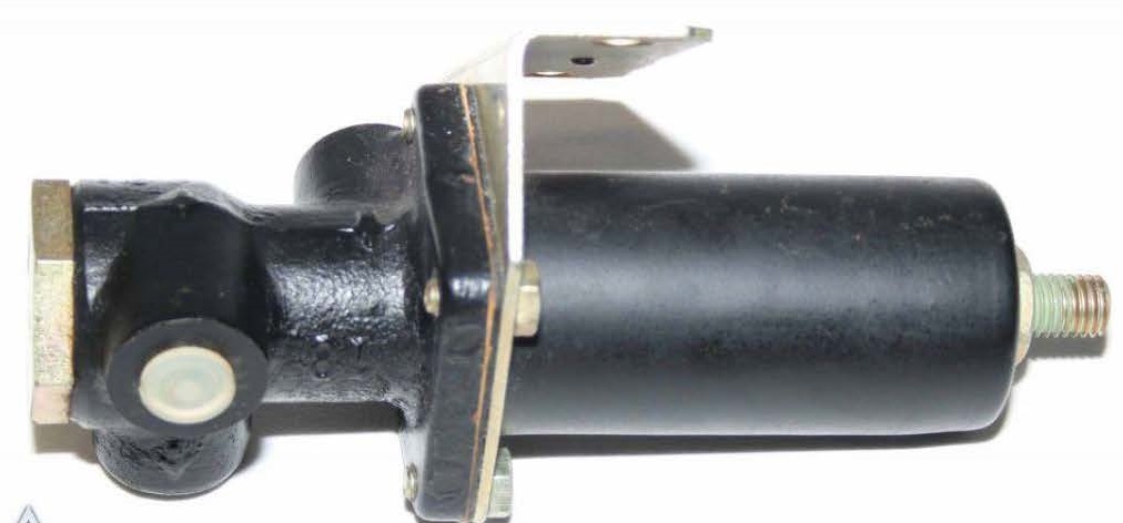

Hello, anyone have a extra rear break pressure controller that I can buy from I need one and I can not fined please help so I can drive my car check the picture please.

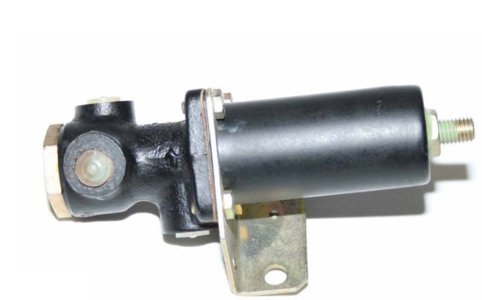

I am not certain that these are the same, but I believe they are. I purchased and used a rebuild kit from PMB Performance to rebuild mine. It looks like they require a core, but maybe they can help you source one?
there is a guy that rebuilds these, do you have yours?
thank you, yes I do have mine I order the parts and I will try to rebuild it myself it is not that hard there is 3 O ring that need to be replace.
Porsche 914 pressure regulator is supposed to be the same. Rebuild kit is-
If you try to source the o-rings yourself, the material needs to hold up to brake fluid. I'm pretty sure you need to source EDPM.
I would think a mid engine 914 would need a different rear brake pressure limit value than a front engine BMW. There must be a way to adjust and test the limiter, or some component(s) (spring?) are different.
Not sure they would need to be different. The valve is not a proportioning valve, which likely would be set differently depending on vehicle front to rear balance. Instead, the idea is merely to prevent the rear brakes from locking up under very hard braking when you are locking up the fronts.
Yes...it's a pressure limiter...not a proportioning valve. But wouldn't those two cars lock the rear brakes at different pressures? In addition to weight and front/rear balance differences, there are front/rear brake differences.
They sure look the same.

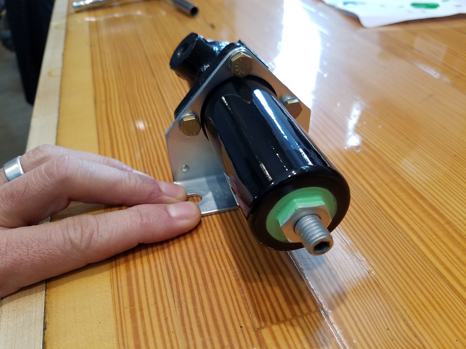

Perhaps the adjustment is the threaded allen screw on the end. I rebuilt mine, and this screw applies more or less pressure on the spring inside.

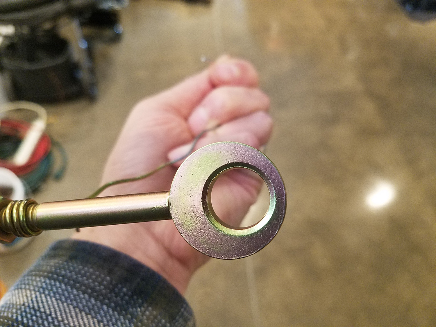

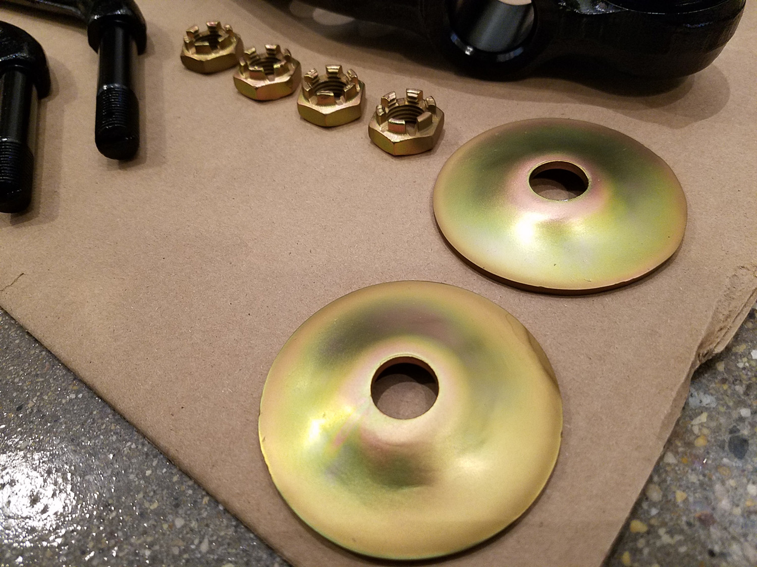

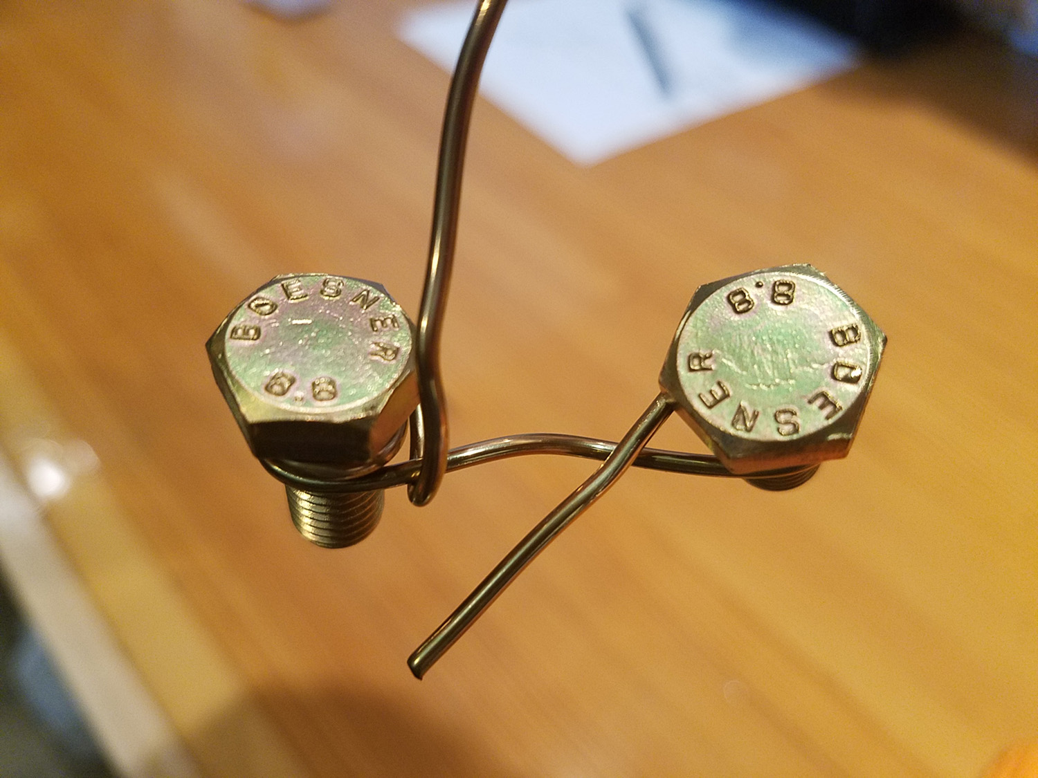

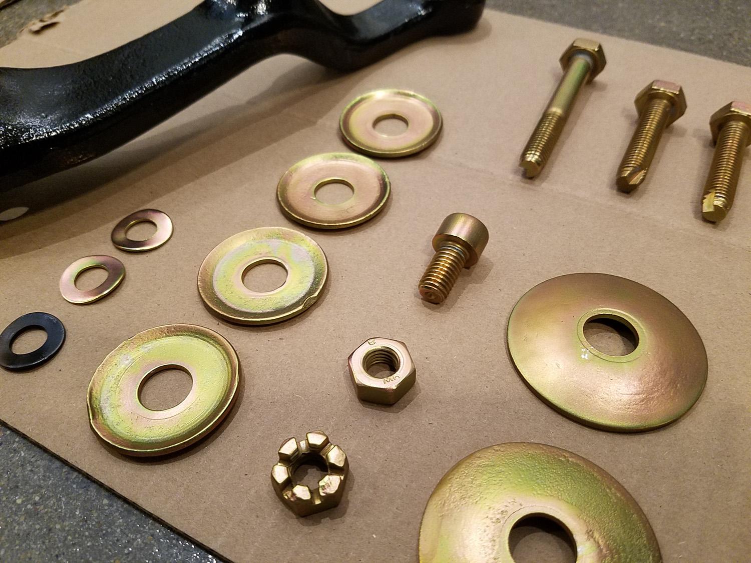

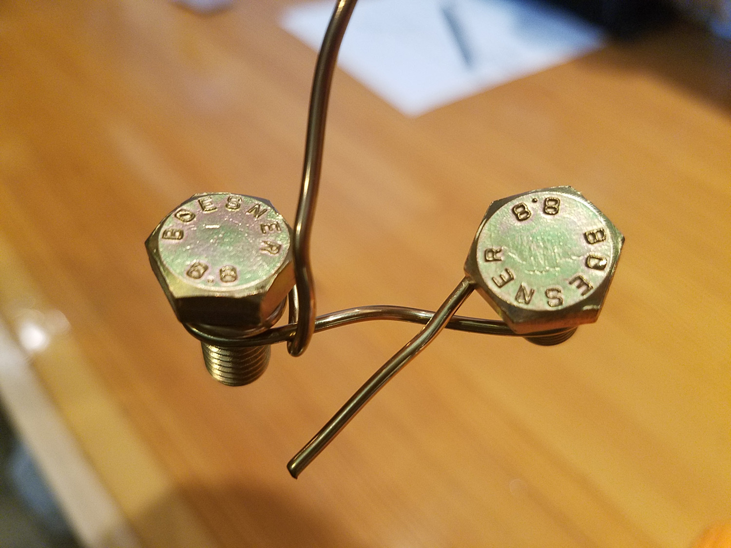

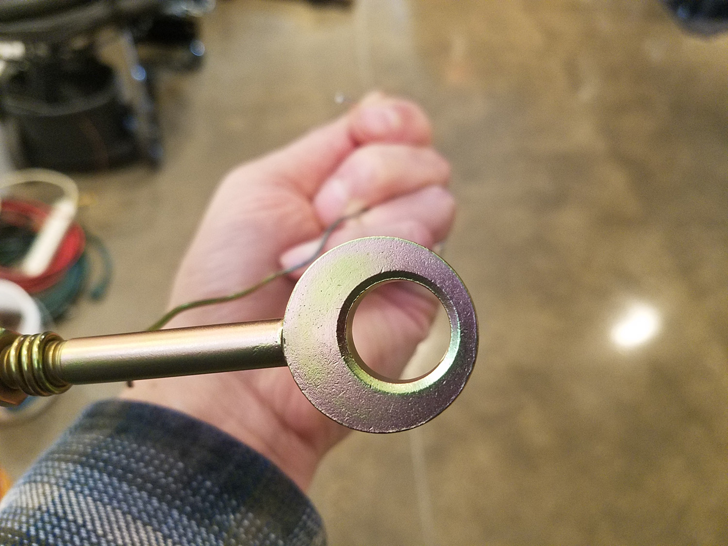

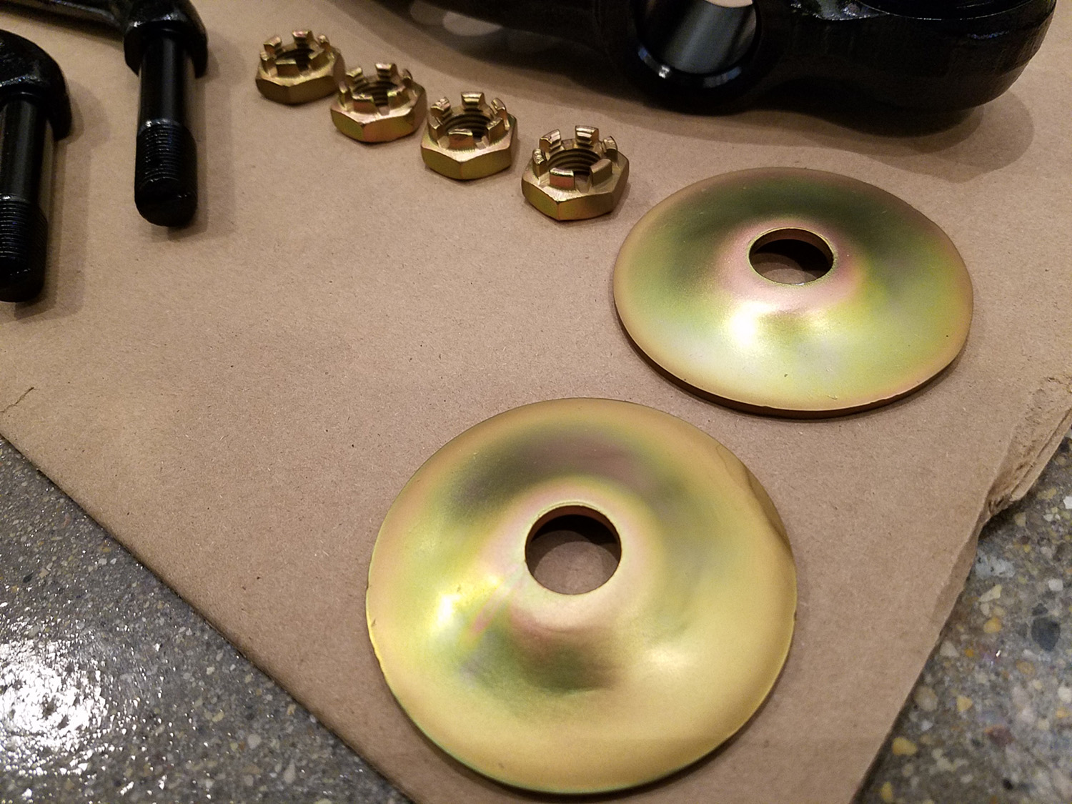

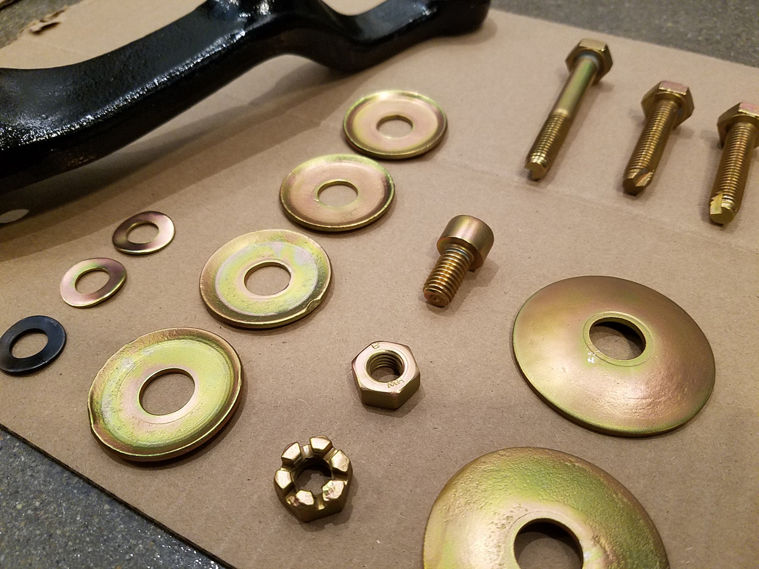

Do you use the Caswell plating system or build your own?
It is not 100% Caswell, but the latest formulations and solutions are largely Caswell, yes. I initially did a complete non-Caswell system that didn't perform well. I am sure I must have gotten some of the chemistry wrong (I thought you could believe everything on the internet). So I backtracked with most of the buckets using the Caswell formulations, trying also to leverage some other resources for details like cleaning processes, amperages, times, etc. Recently, I've had two of the recommended buckets crack and leak. One with a chemical I don't want to be breathing (think Erin Brockovich), and the other that ate through my concrete floor. :oops: I am currently looking for better buckets! Then I'll have to re-build a few of the formulas and do some testing. The biggest issue(besides leaks) is that it takes up a lot of room. But the results are, as @Dick Steinkamp says, jewelry. I still have some of the first few pieces I did laying outside in the dirt. They've been there for a couple of years and no corrosion or anything. I don't plan on laying the car in the dirt (like the previous owner did), so I am pretty pleased with the corrosion resistance thus far.
