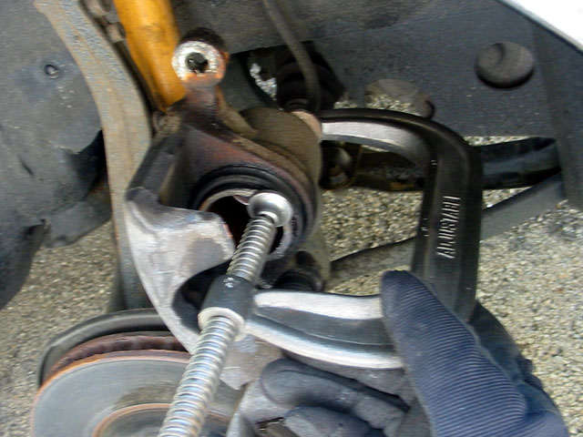

1. I got rebuild kits FTE RKS4202. Perhaps @Denis1967 has answered the question about the piston seal taking a set, but the new seals look to have a very square profile, making it impossible to get the piston back in by hand, even after liberal coating with brake fluid. The old seal appearS to be tapered toward the outer edge. I put one of the old ones back in and was able to pop the piston in by hand. It is normal to require considerable effort of a C clamp or harbor press to get them in with new seals?

I have used a c-clamp to pop them back in with no issues.

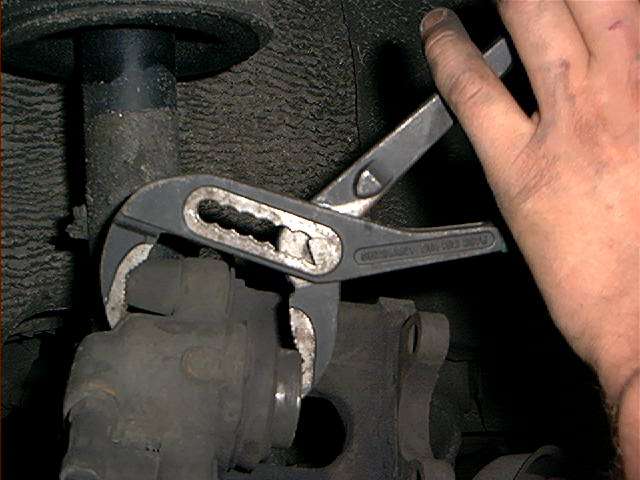

Arguably not the best practice, but in a pinch, another (less glamorous) approach involves the use of slip joint pliers and a piece of scrap wood or equivalent to prevent unintended damage to piston/caliper.

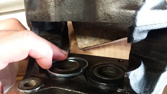

Is there some trick to get the dust boot to seat into the groove (and stay there) so the steel retainer ring can be installed? The piston is extended out of the bore a bit. Should it be pushed in as deeply as possible to get dust boot into the correct position?

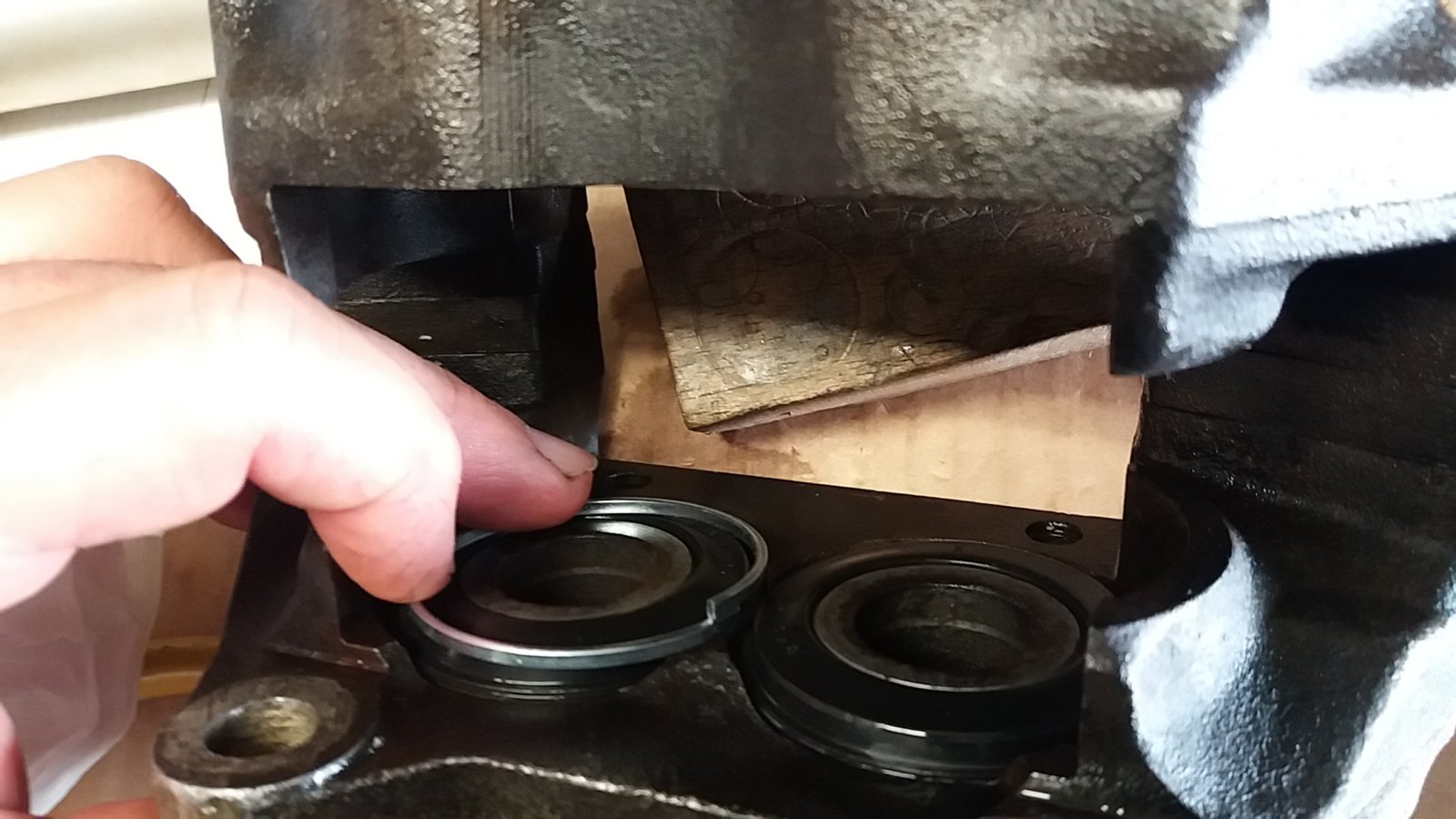

@deQuincy, this? Words would help me, such as "Depress pistons into bores and add dust boot and retainer rings.: (if that's accurate.)
Or would this be the way?
