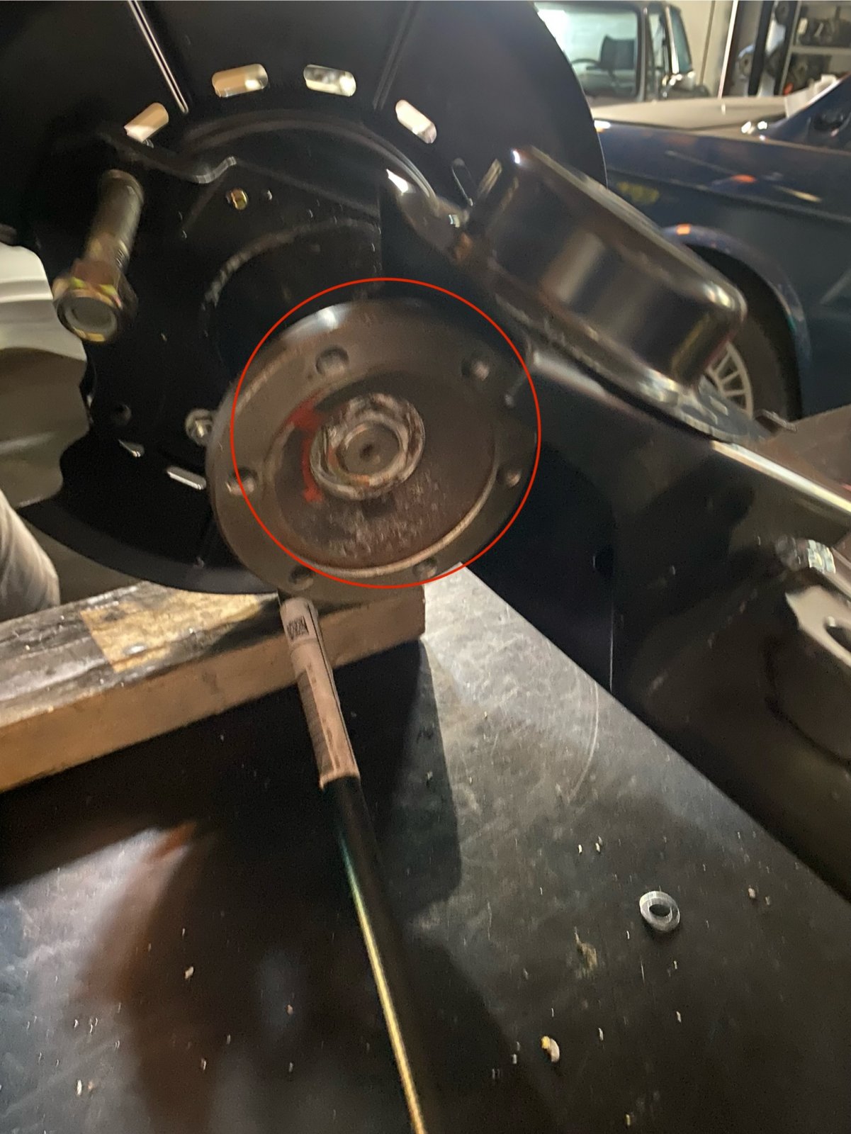

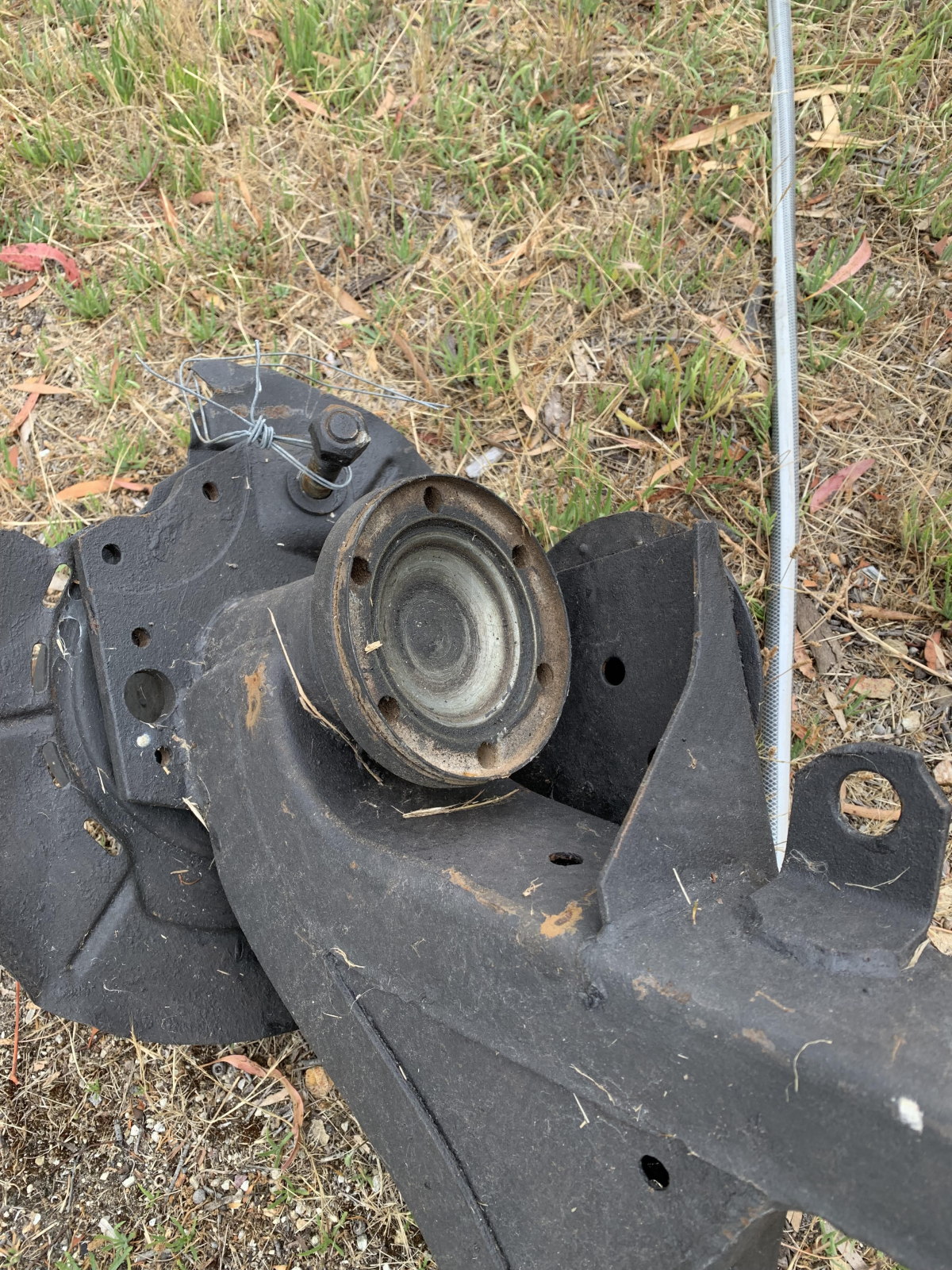

I went and tried to use a sliding hub w/ 5lbs hammer. I can't believe that the rear hubs are held in with just force and no pin or nut.

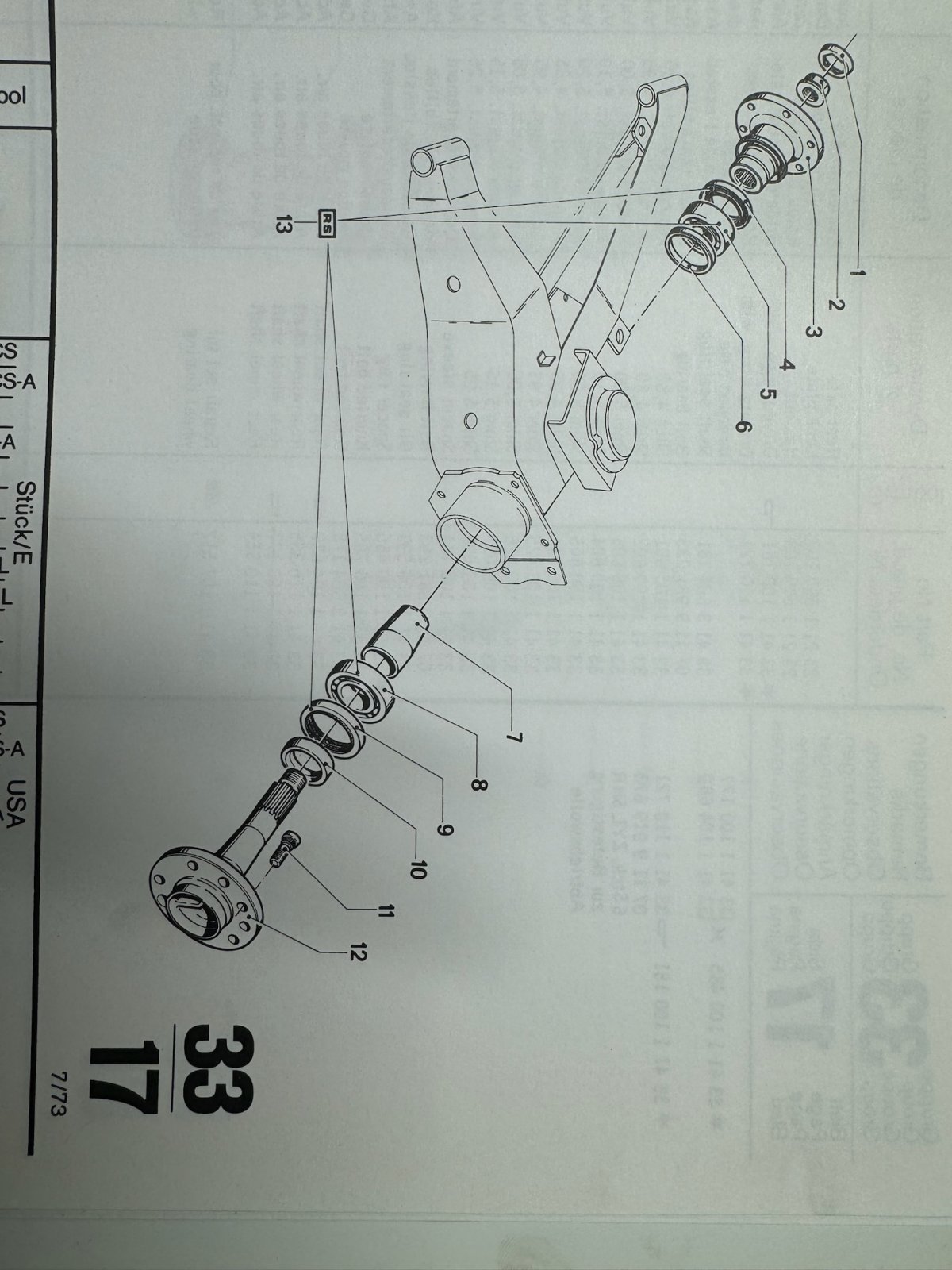

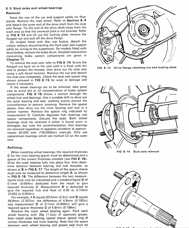

The hub on this 1974 does not have a nut, I'm curious if the photo attached if there is a cover (circled in red). Do I need to remove as it looks like it is all one piece. I'm going to take a look at the front today. I have just about every service manual available, but I cannot locate the "Jesus nut". Thank you can again

Simple question - did you actually look at the huge picture with the red circle I posted for you or is this an ongoing forum joke that I don’t know about?
Go back to the diagram YOU posted and look for item #2
what do you see?
Good morning- I'm sorry to ask, but are you free for a quick call. I can show you via Facetime. Happy to pay a couple of hundred for your time. The issue there is no viable nut or seam between the cap and #12. It is similar on the other side as well. I'm used to working on Porsche cars where there is much more info. Feel free to call if you have some time today, 480.297.5577. Chris
