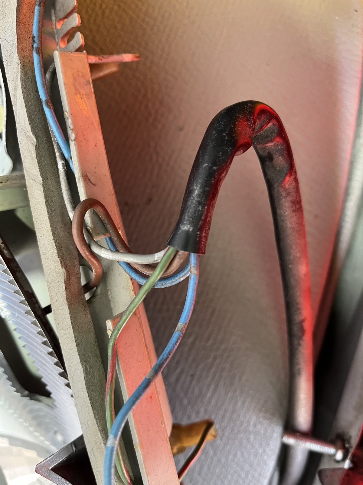

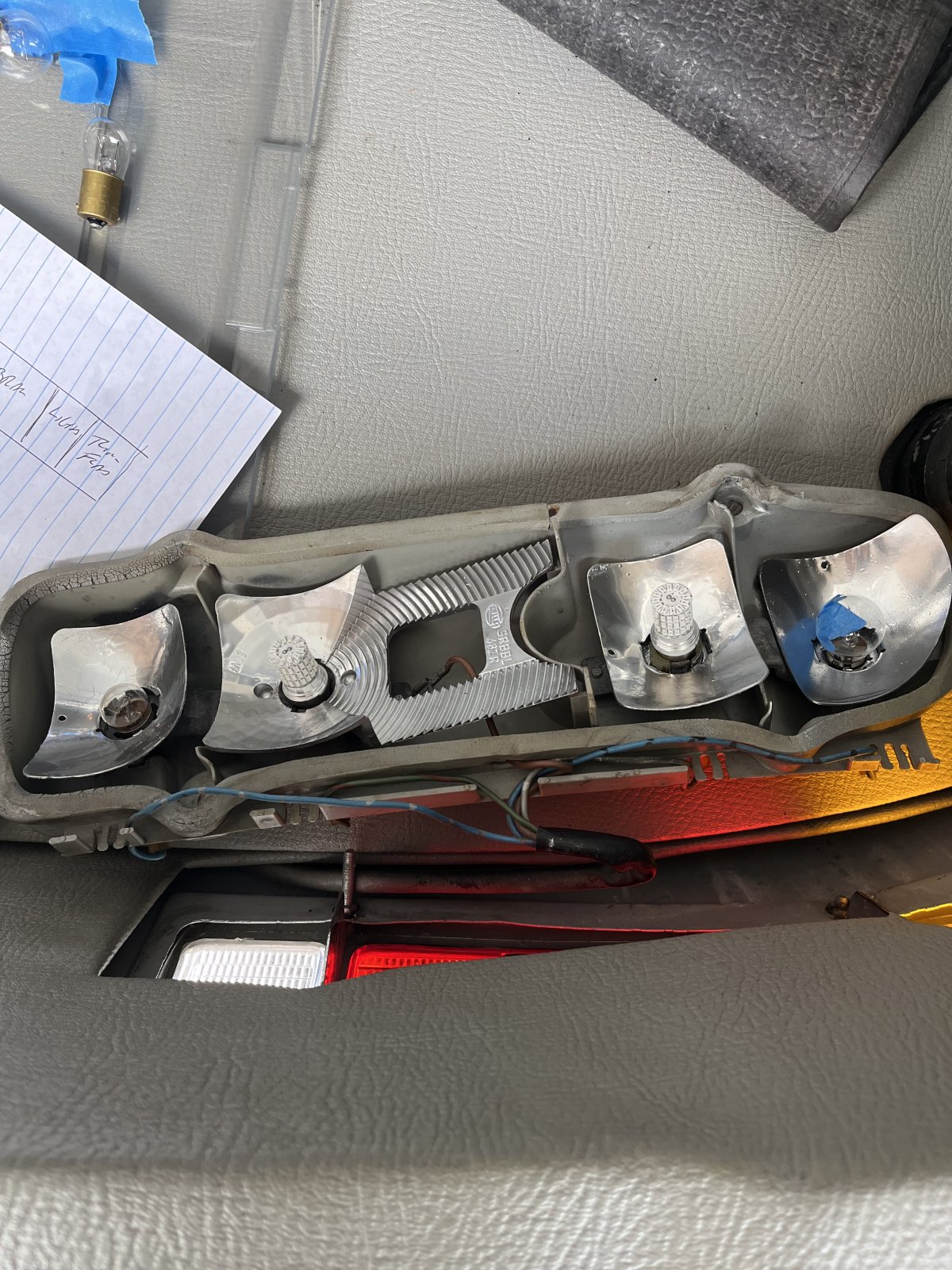

I recently cleaned up my tail lights and put in LED bulbs for the running and brake lights. Everything works except the left turn signal light does not work, instead when I turn on the left turn signal or the flashers the left running light flashes. All works fine on the right.

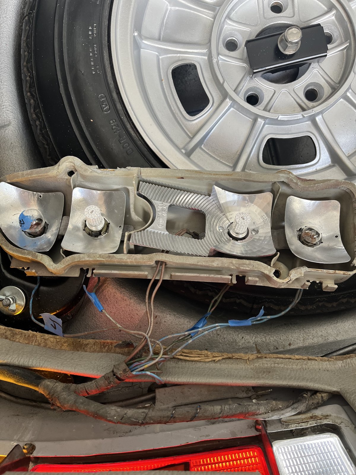

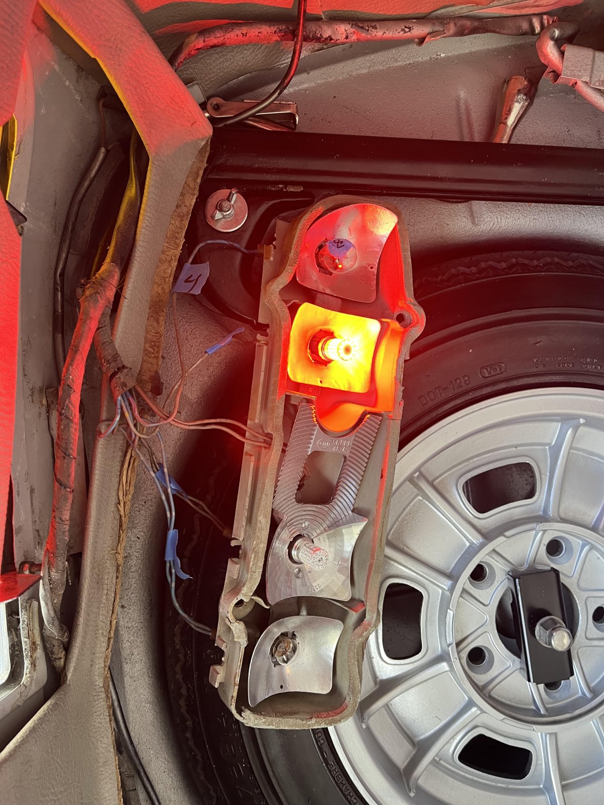

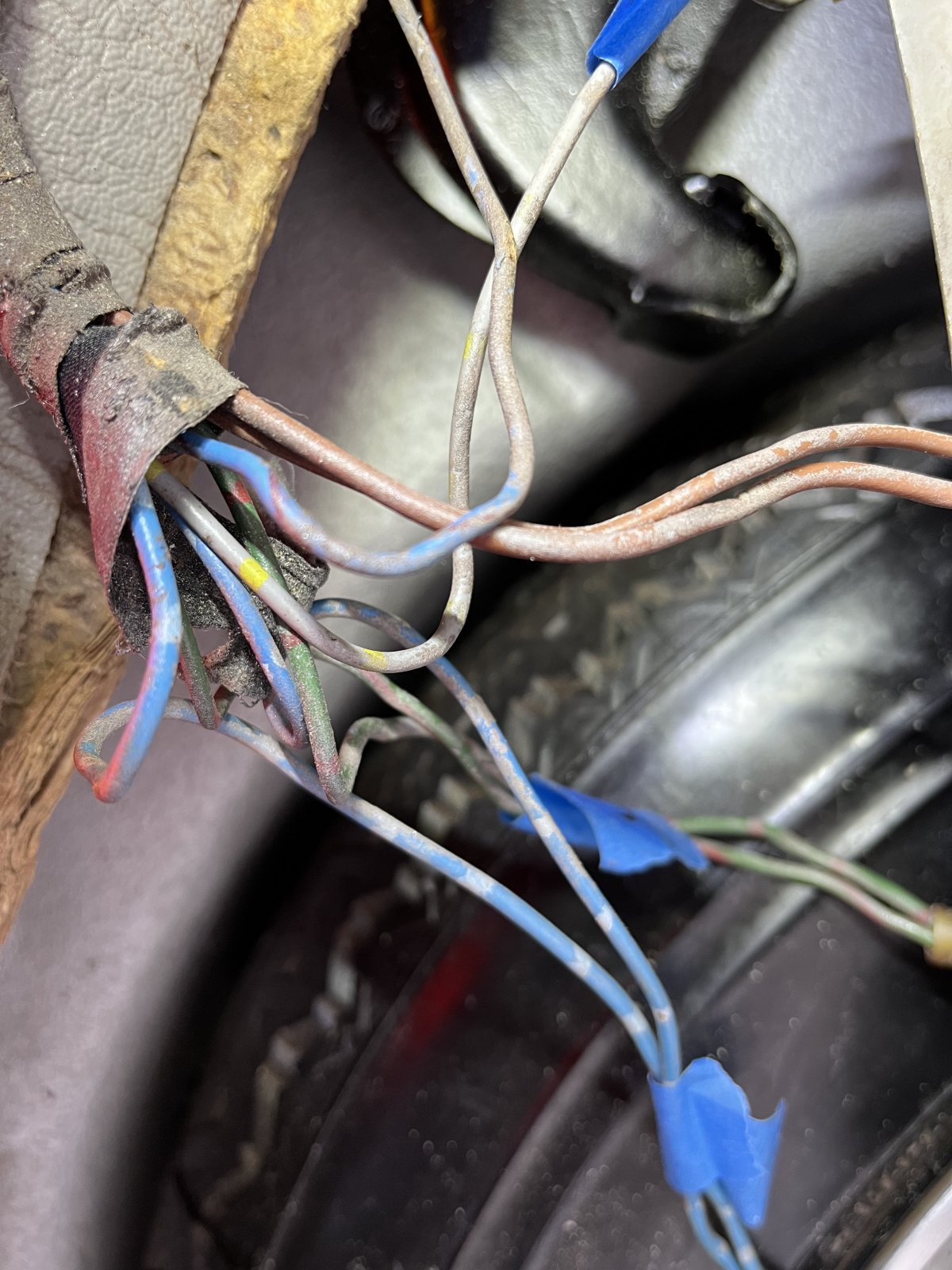

Have you tried turning on your running lights on to see which bulb lights up?
  • Fuse not blow
  • Grounded
  • Running light second light in- See picture.
  • I suspect I may have wired wrong, or wrong bulb is wrong place
  • Wires are - See pictures
Blue/Brown or Black stripe
Green/ Red Stripe
Blue/Green strip
Grey/White strip
Brown Ground

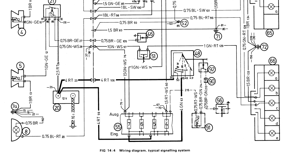

Left rear turn directional s/b Blue with Red tracer. Do you have a single element bulb in the turn directional?
8. Turn Directional Left Front 66. Rear light cluster left a. Reversing light b. Stop light c. Turn indictor d. Rear light e. Fog light
2800 has a few differences but LH Turn is Blue/Red as mentioned. These diagrams are invaluable:
I do have a single element bulb for the flasher. I do have Blue/Red for turn Left
Turn
Left Blue/Red
Right Blue/Black
Park
Left Grey/Yellow
Right Grey/Whit
Brake
Left Green/Red
Right Green/Red
Reverse
Left Blue/Grey
Right Blue/Black

The running light left and right circuits are independent, they even have separate fuses. They only meet at the light switch, so comparing left vs right is inconclusive.
Left front and left right running lights however are the same circuit. If the left rear running light is ON but the left front is OFF when you activate the flashers, then you have wired it wrong.
IMHO ground, ground differentials, fuses, and incandescent bulbs are all rear light colored herrings...
If both front and rear left running lights are ON when you put the flashers I would say you created a "Byzantine Failure". Then the red herrings start looking pinkish and I will eat my hat.

When I first acquired my car, the high school drop out who installed the prior owner's stereo spliced into the fuse 1 circuit, pulled the 5 amp fuse and installed a 40 amp fuse in its place. When the owner then cranked up the stereo, she melted the fuse block, left side tail light assembly, and most of the wires in the left side lighting circuit. I got a tail light assembly from Peter Coomaraswamy, repaired the melted fuse block, wiring behing the fuse block, and both ends of the wiring near the light sockets, but then I had this exact same issue. With incandescent bulbs.
And it was a ground problem. The turn signal ground runs through the tail light before connecting to the metal strip that the ground wire is attached to. I added a wire from the tail light assembly to the metal strip inside the light assembly and it solved my problem. ( I also did Andrew's aluminum tape improvement at the same time.)

Test for my scenario is pretty simple. Measure resistance from the side of the turn signal socket (which grounds the bulb) to the ground wire attachment point on the back of the assembly and compare to the resistance from the side of the running light wire socket to the same ground wire attachment point. Equal resistance = no problem. Higher resistance at the turn signal socket indicates a problem.
Of course, in this situation, resistance of the bulbs is probably not similar, and that alone could be causing this problem.
