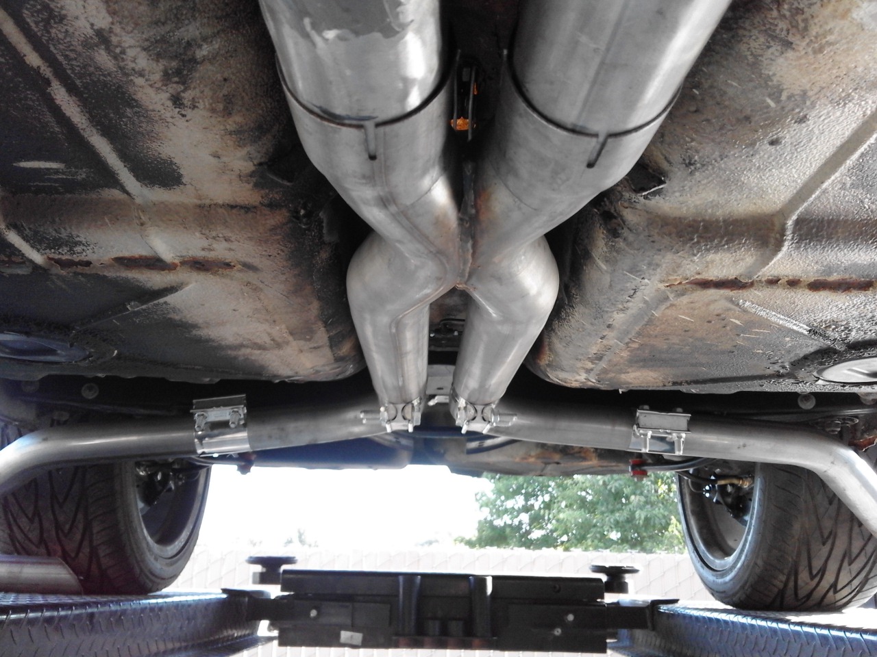

@Stevehose - Thanks for the pic. I thought the center "thing" was a resonator as opposed to a muffler?

I don't know what is actually called, when I had it cut out it hit the floor of the muffler shop with the thud of a rust-filled boat anchor. My exhaust is not loud at all, just a little more throaty than stock. Not loud on the highway, sounds great at low speed around town and reverberating against the buildings of the French Quarter. Actually, I would like it a little louder but thus far I am restraining myself :p

When I bought my Bavaria it was in the process of becoming a hot rod. It had this newly fabricated muffler shop exhaust system on it...
I'm far from a purist and own two hot rods with (semi) loud exhausts systems, but a Bavaria (and maybe a CS?) is a stately car that deserves an exhaust note in keeping with its stature (IMO). Peter at KK found me a complete NOS system. Perfect (for me)!
