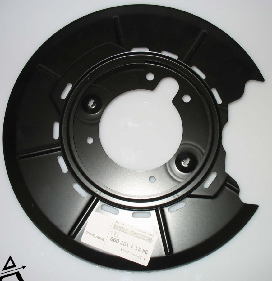

I need rear brake calliper protection plate. Left and right side. OEM 34211107097/8
New, or used in good shape.
Henrik
Only the right one is available from supplier (W&N or BMW Germany) So I hope someone may find both or at least the left one in their messy garage.

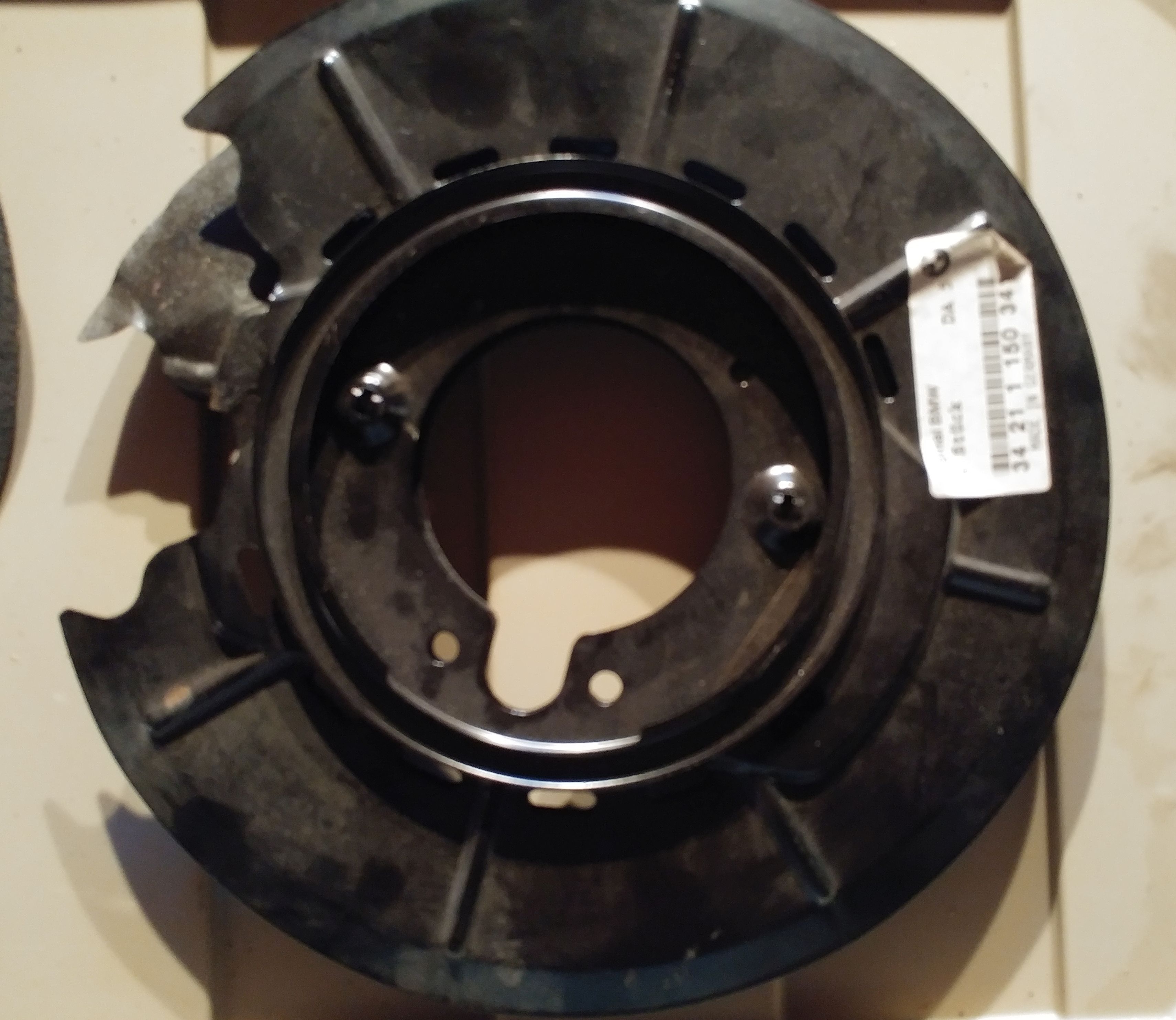

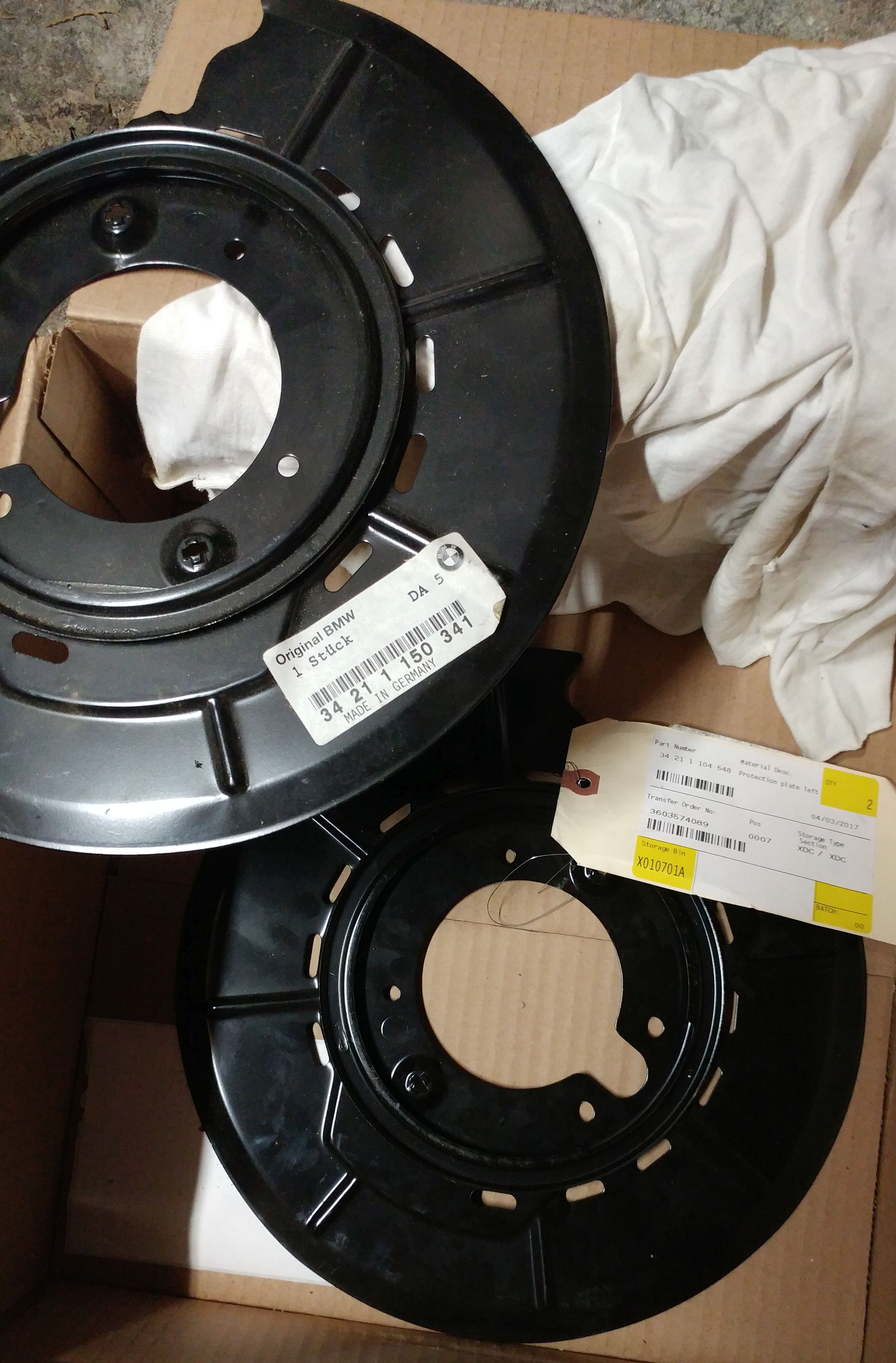

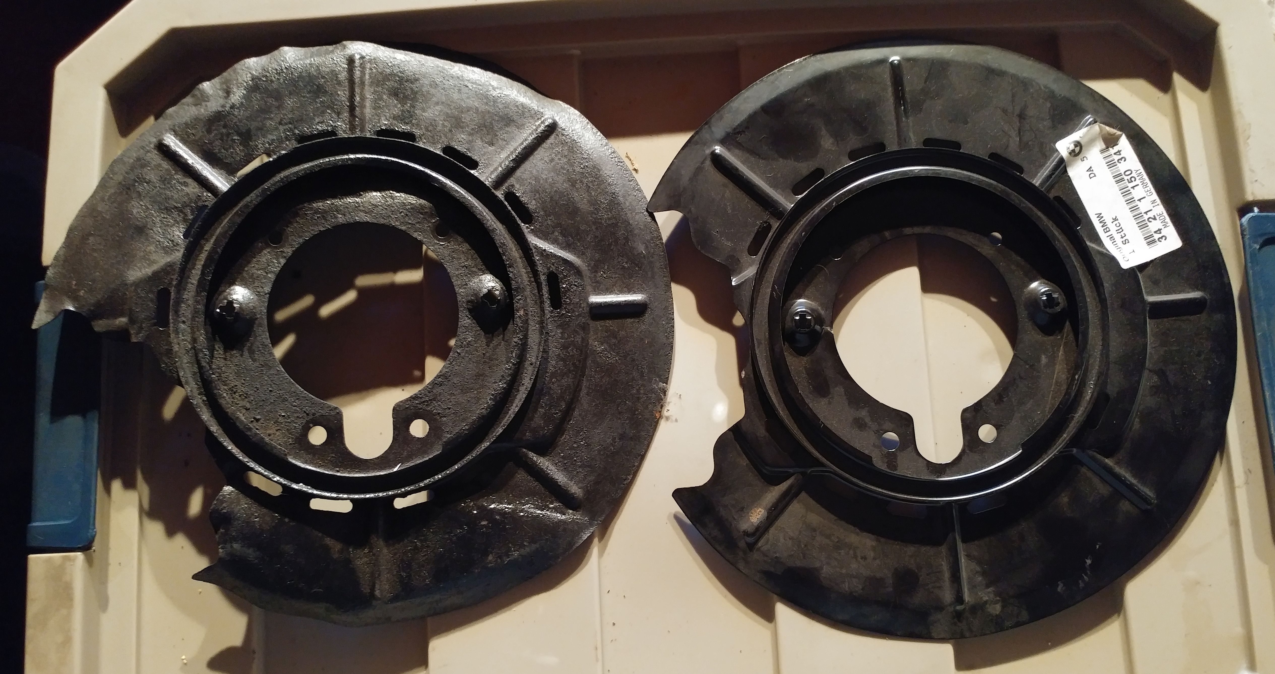

FYI, you CAN use E24 protection plates (still available for about $40/each), but you will have to take some tin snips and cut the plate a little bit as the caliper mounting position is clocked slightly different. Here's a RIGHT side as an example. Dirty one is E9, clean one is E24.
