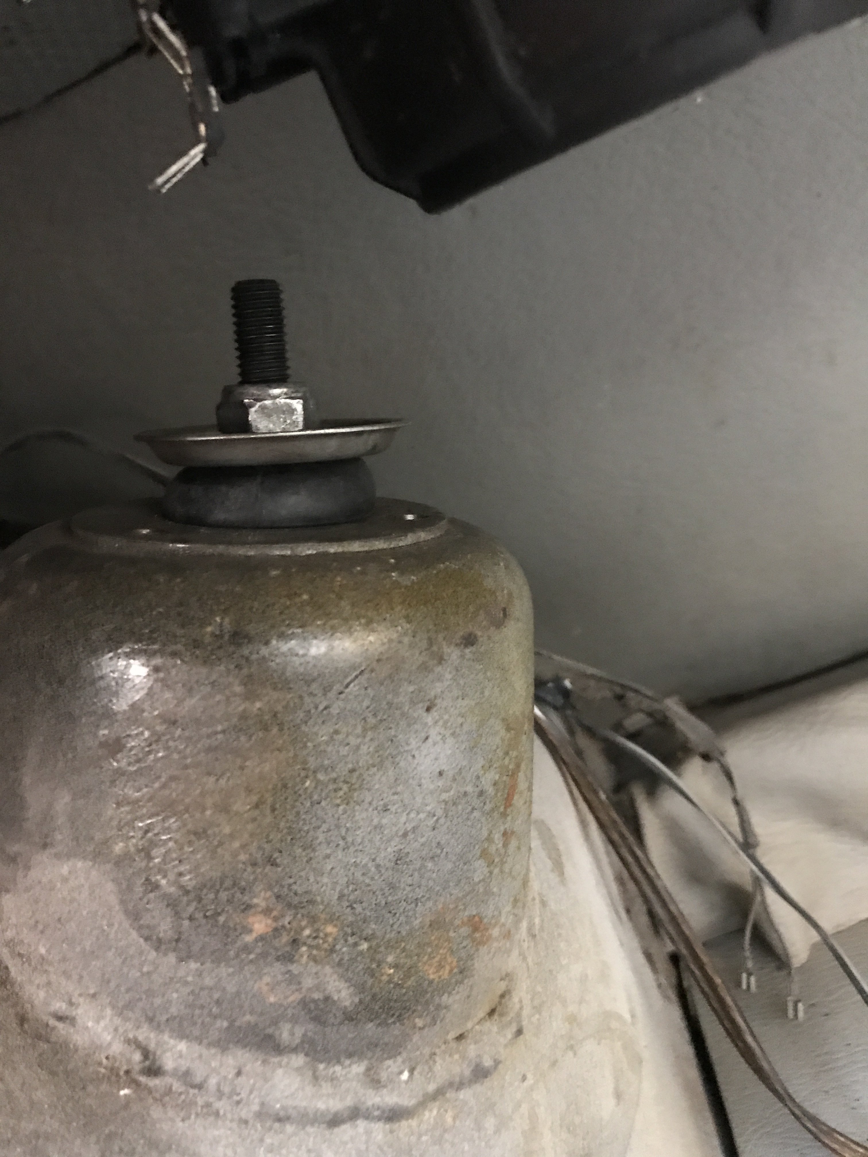

Have I got this right?
I put a backing washer above the plate (figured it couldn't hurt) which is compressing the factory/OE bushing. Since there's no bottoming out I figure it's a 'feel' thing in terms of how much compression/deformation I should end up with?
On the underside of the tower I installed just a backing washer and the plate.

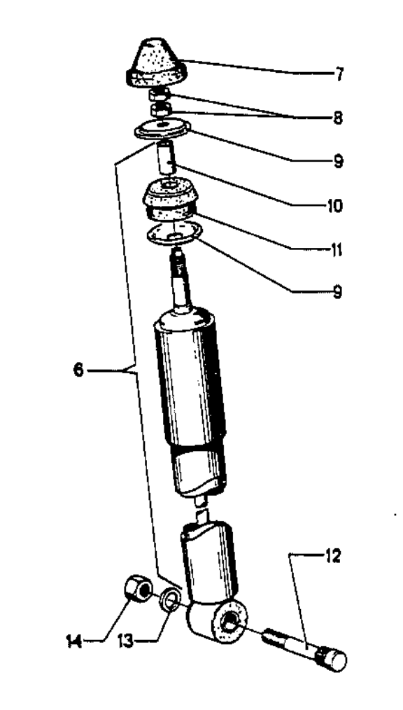

There's actually supposed to be a metal sleeve inside the rubber so that you can bottom out.
Number 10:
My car was missing these sleeves, so I asked for the dimensions in another thread, and the answer was 1 inch/25mm long.
I should have looked more carefully perhaps - I bought the bushings from Rogerstii and assumed (as I'd read in another post) that the sleeves were attached inside though slightly shorter hence I did not see them flush with the top/bottom. Thanks for pointing this out, just called Rogerstii and ordered the sleeves.
I should have looked more carefully perhaps - I bought the bushings from Rogerstii and assumed (as I'd read in another post) that the sleeves were attached inside though slightly shorter hence I did not see them flush with the top/bottom. I'll call Rogerstii to ask if I got that right or needed another part.
Yes, and if they don't have them you can easily make two sleeves yourself out of a small pipe or something, as long as it fits over the shock rod + inside the rubber, and is cut down to 1" long :)
