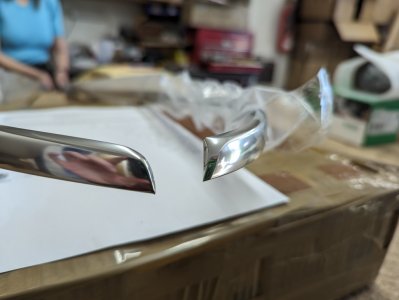

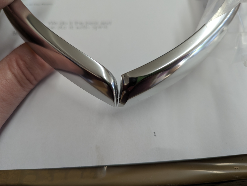

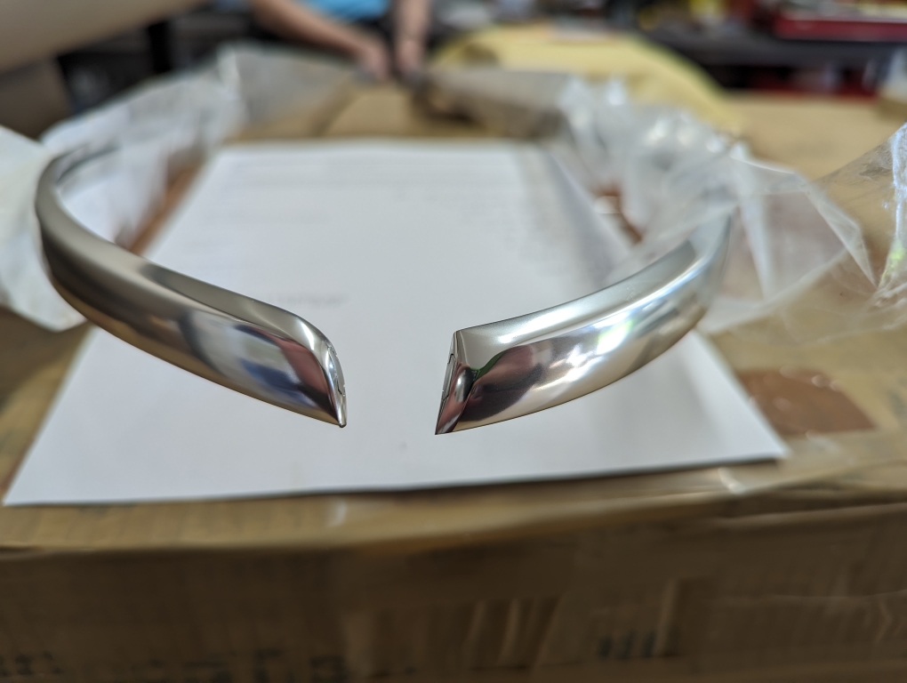

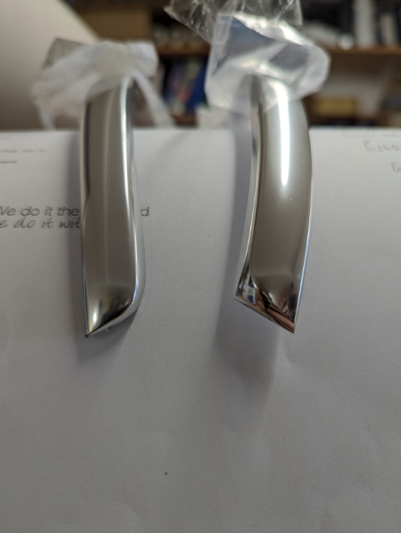

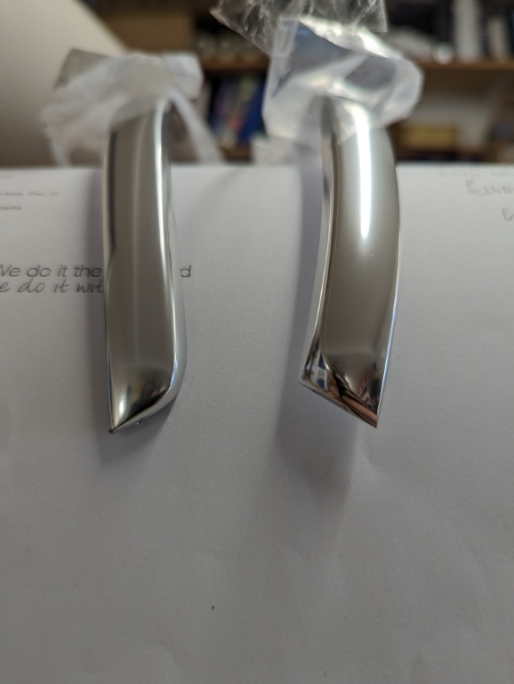

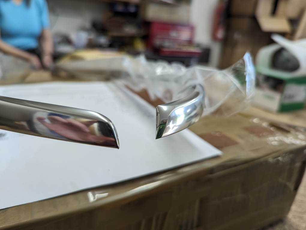

Hi all, I was looking to get new trim for my car and I have a question.

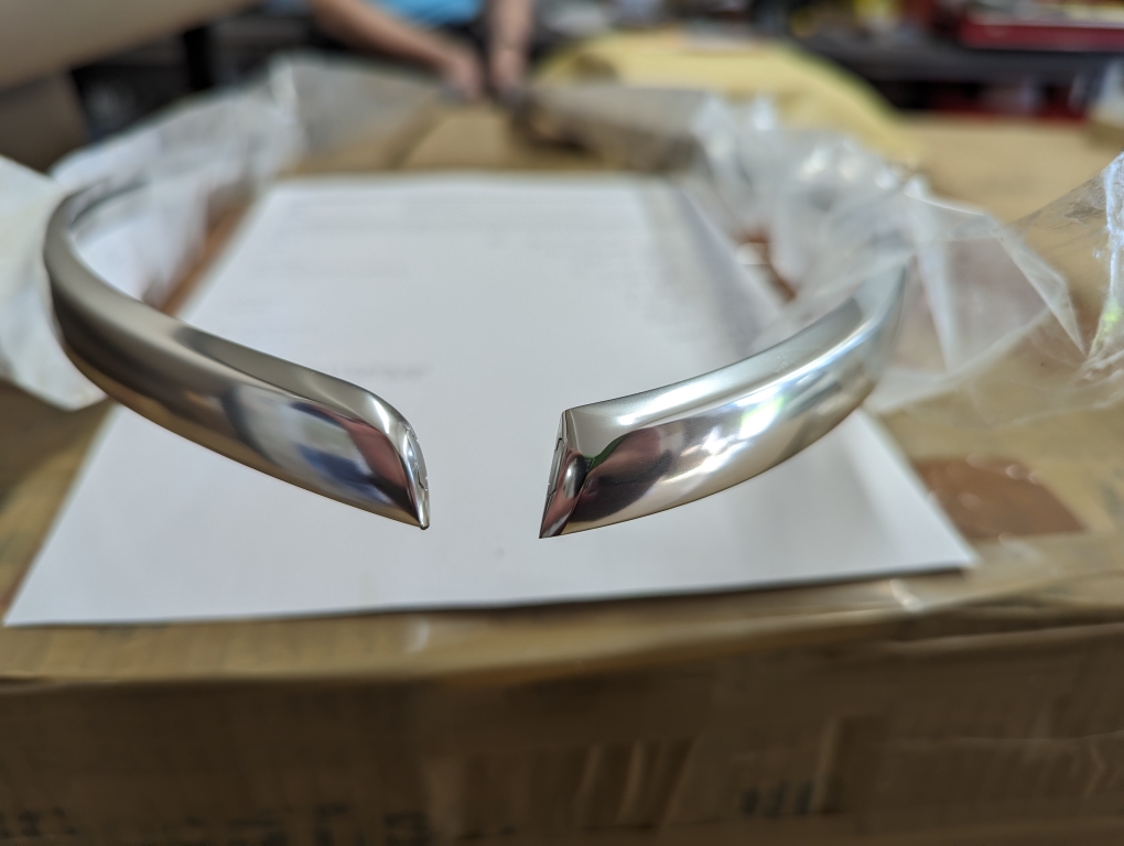

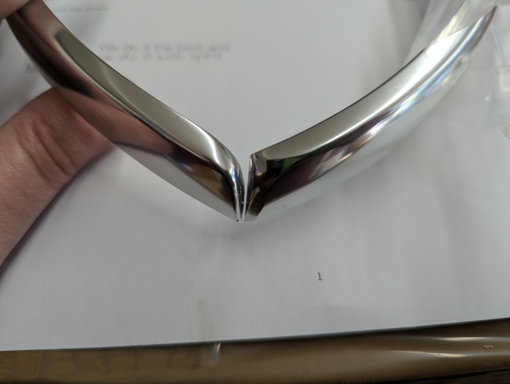

I need the rear right trim for an LHD car. W&N had all except the right one. Fay at jaymic told me they had them but when she went to look she saw something odd and was nice enough to send me some pics. They are BMW originals and the left and right don't look the same. So, I wonder if this is normal and are the pictured ones an LHD or RHD car?
Johan

yep, there is a problem with the one on the right. looks like they didn't finish grinding the end ...
Hi,

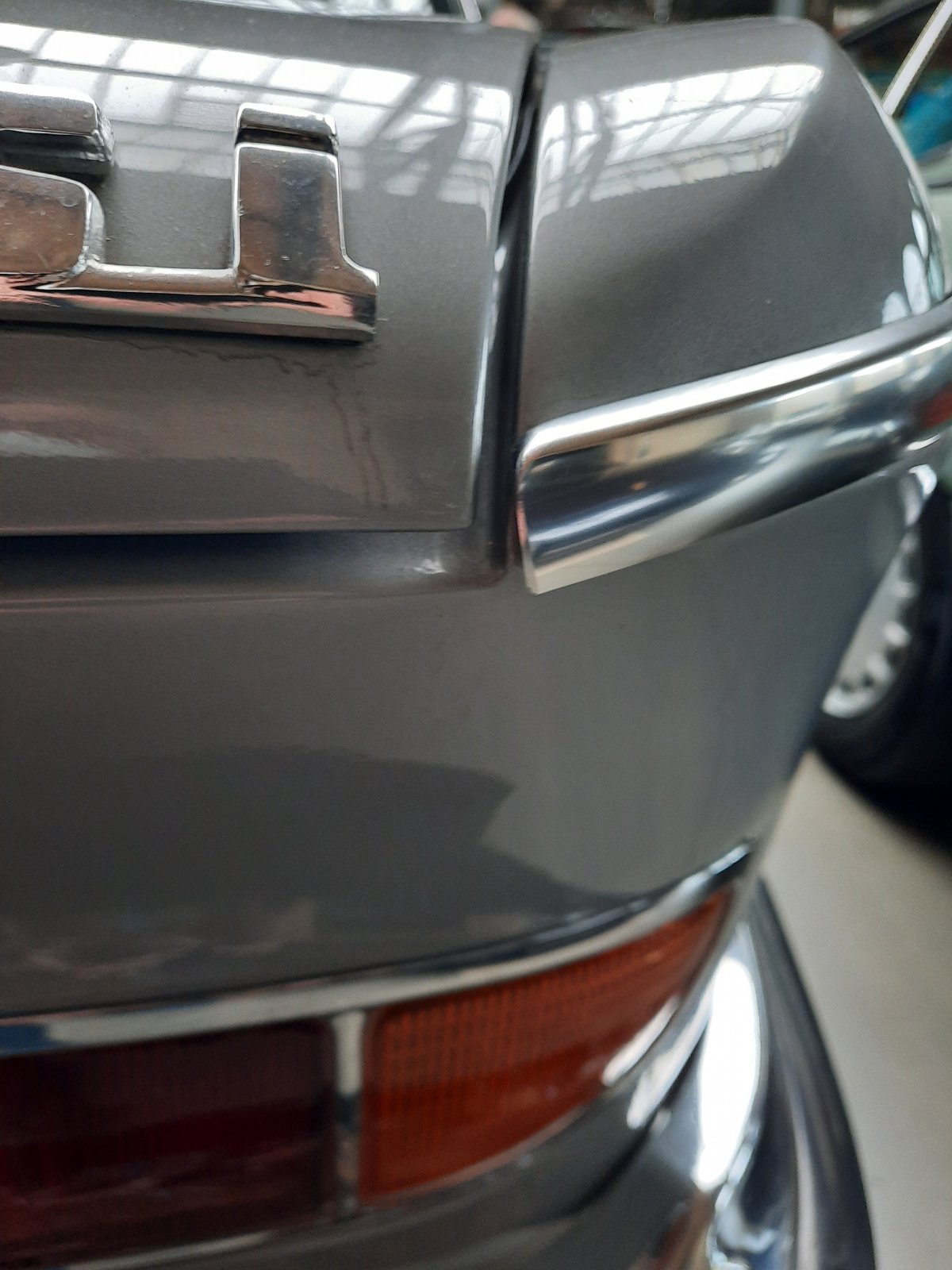

the following issues exist on the BMW´s reproduction of the rear trims:
- they were either too long (as on first pic) or too short (as on second pic)
- the rear corner doesn´t follow the body line, it points downwards. This cannot be corrected since you are not able to bend the trim upward.

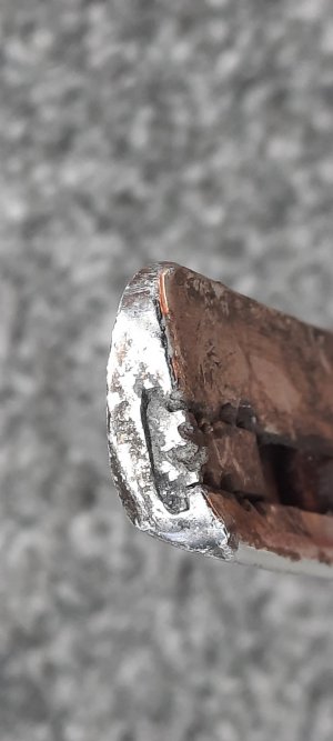

- the end was kept open and not closed

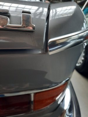

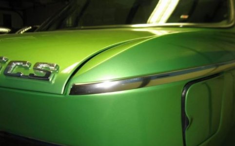

Source of pics: TomHom & Christoph
Furthermore, I was told that a reproduction of the rear fenders does not have the same shape at the factory car's have, so here original trims will also not fit perfectly.
It´s a shame
Thomas
the alternative is to buy good used ones. i had mine stripped, polished and ceramic coated by Speedway.
