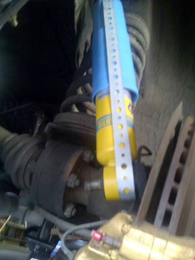

i compress the shock and keep it in place with plumbers wire, slip it on, then release it up the tower
that is the way to do it, yes, no hammer but a piece of wire

For reinstallation of the gas strut, I first compressed it (I have BIlstein, I just leaned on it). tied it off with a rope. Then mount the strut to the axle. I used a piece of rope, looped around the top of the strut and back through itself to gently release the strut, expending it upward, and direct the threaded end through the hole in the trunk. the spring does not need compression when reinstalling. (if you are able to lift the car of the rear subframe that is)

there is a writeup and photos in a thread i did some years ago, i used the rope, stevehose used the plumbers strap
yes the cv joint yellow metal cups will suffer, my advise use compressors and no hammer
I meant plumber's tape or strap, this stuff:
