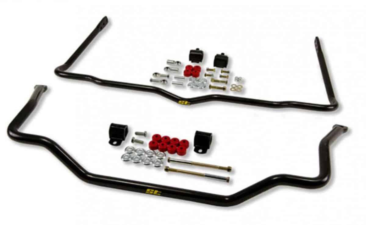

I would also highly recommend a new sway bar kit. Did wonders (ST brand) for my 2002:
