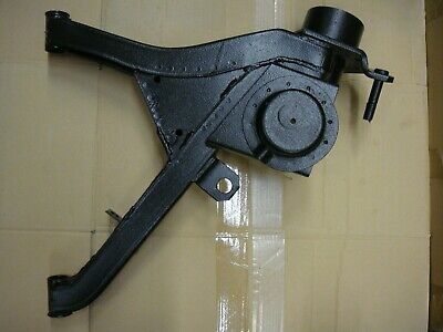

Obviously they are easy to tell the diff between 2800CS and 3.0CS w/the brakes still on, but how does one tell with everything removed?
e.g.:
For example, the ad says 2800CS, but how can one tell?
e.g.:

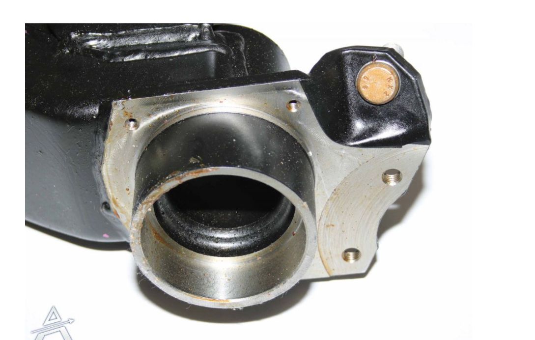

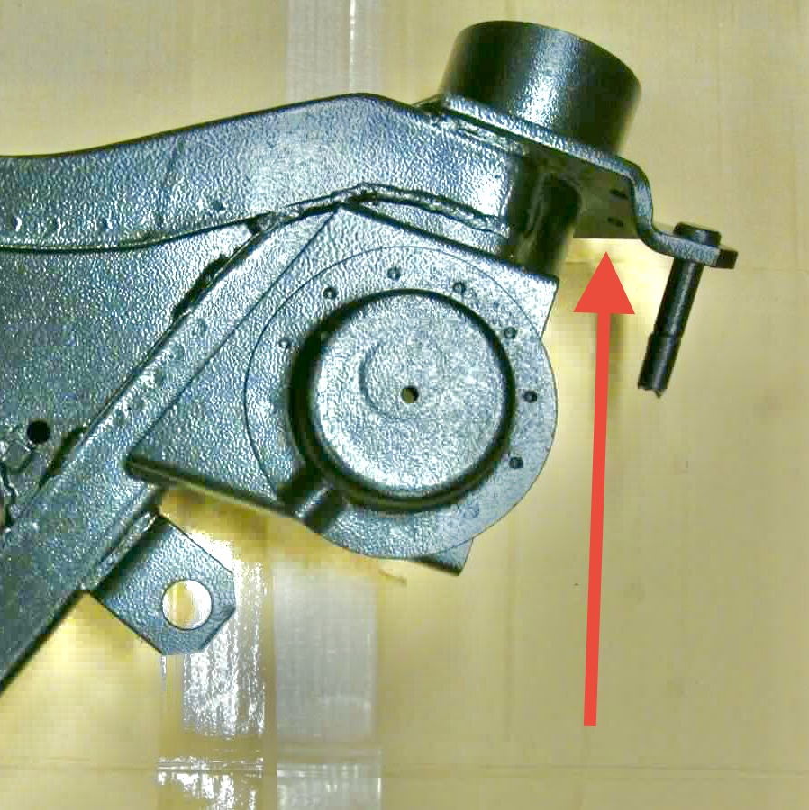

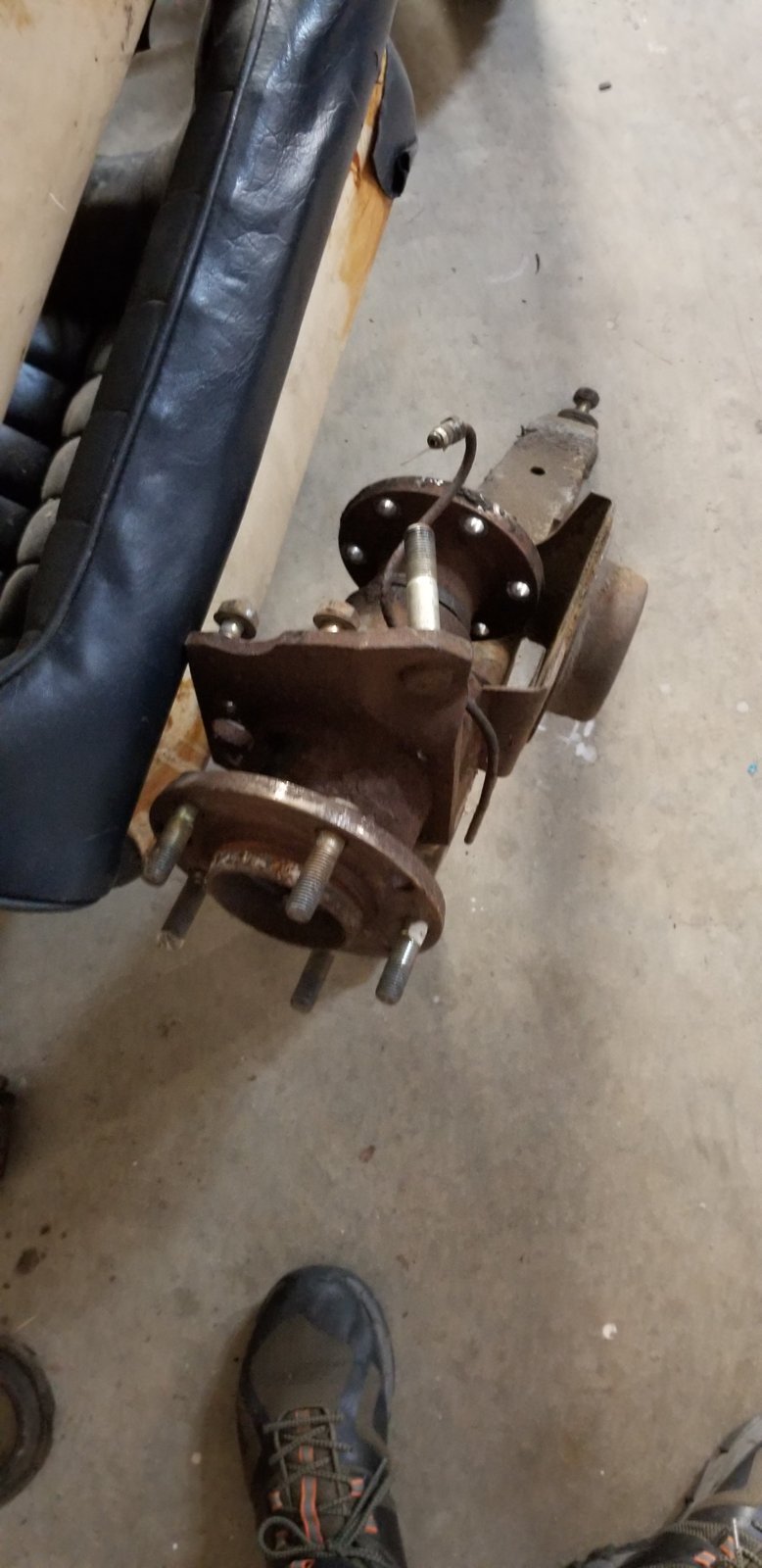

Directly below the shock mount stud you can see two bolt holes that mount the calipers
Just from the picture I am seeing a machined face for the caliper mount, also the thickness of the mounting plate seems beefier. So I would say no
Picture is 3.0cs(i) in my opinion. But the description says „Archivbild“ which means translated to english something like „example picture“. So it’s not the actual selling item.
Is that the only diff? Can one just drill the holes?

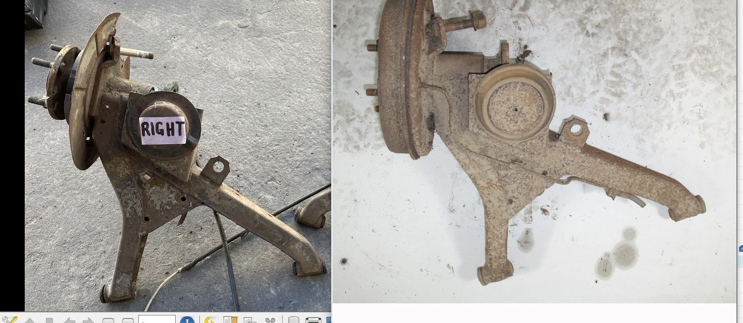

after all the home work I did 2800 dos not have the place or the 2 hole to install the break caliper
the short answer is not really. the rear springs are very different mounting on the e3 and e9.

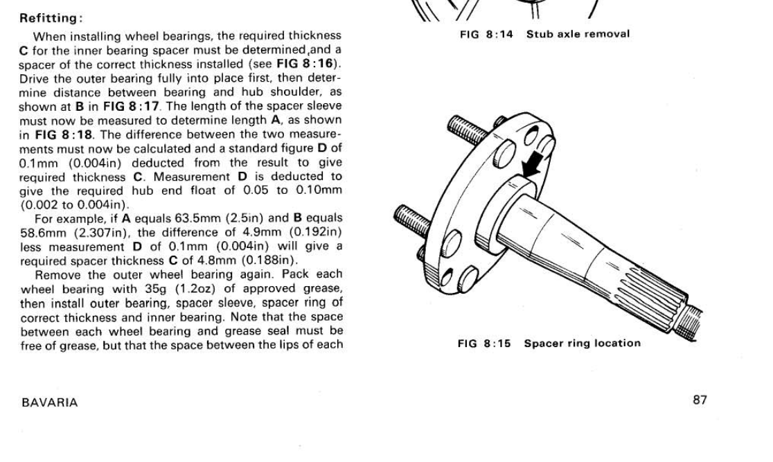

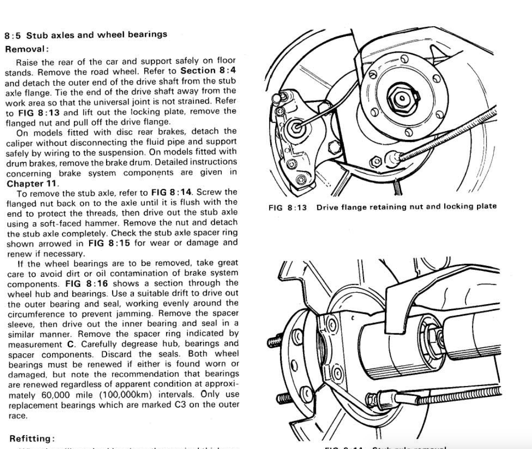

thank you very much, that was good enough, I fined a good trailing arm for my 2800 now I can change and have a rear disk break but now I order a barring and seal but the ting is I don't know how I pull off the old barring and seal or what kind of tools I should use I took it to local mechanic they didn't want to do it now I am back to square one if you know what kind of tools I have to use please explain me
its a PITA job to break everything loose from the subframe and put all the new things on ... it is also time consuming. i would look for another mechanic ...
it is on the floor I am kip looking how do I hammer the barring's to pop out not to damage the arm or I have to spend time driving around to fined a good mechanic and always good mechanic are busy
If you are trying to modify a 2800 rear trailing arm to accommodate disk brakes, I don't think that is possible. The 3.0 trailing arms have a machined surface and a set of holes for the installation of the carrier that holds the calipers. That machined surface needs to hold the carrier, and thus the caliper, at precisely the correct orientation relative to the two friction surfaces on the front and rear of the rotor. And the holes need to hold the caliper at the proper angle relative to the outside diameter of the rotor.
You either need 3.0 e9 trailing arms, or go back to drum brakes if you want to keep the 2800 trailing arms.
Well, as has been said before in this thread, anything is possible with enough money, but it would undoubtedly cost more to do it properly (find some disc brake arms to accurately measure the differences, weld on new steel of the right type to your 2800cs arms to make the caliper mount, heat treat the welds to make sure the steel is the proper strength with no built up stresses, machine the new steel to match specs, drill the mounting holes in the right place at the right angle and tap them, repaint or powder coat the arms and install new bearings, install the new calipers and rotors you bought and install arms) than to buy good used 3.0 e9 trailing arms and bolt them on. It's not easy to find disc brake arms, but they do come up from time to time.
