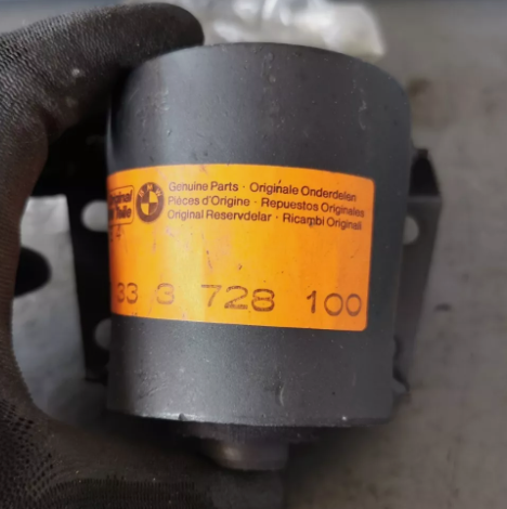

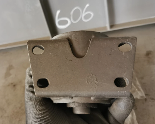

Now on the alignment: others posted that there is no adjustment, but the thrust rods are mounted to the floor with the 2 m8 bolts: the thrust rods do have slotted holes.
Secondly, the mounting of the rear axle to the subframe is done with the rubber bushes over the thick pin in the floor. That rubber part is encased in a steel structure which also has slotted holes. which means the axle can move left to right over these holes (were it not for other nuts and bolts to influence the position of the subframe as well).
(pics of an NOS part of Ebay)
So there is some freedom in these 2 places on either side, but I'm not sure if it actually influences the position of the axle itself.

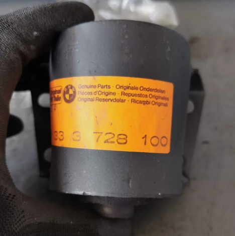

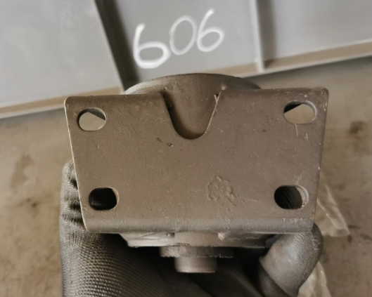

View attachment 204328 View attachment 204329(pics of an NOS part of Ebay)
