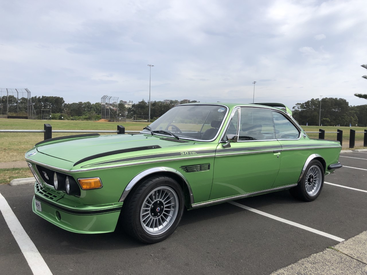

I tend to think my rear wheels sit a bit inwards for my liking, so would a 5mm or 10mm wheel spacer on each rear side help? Or would I end up with rubbing? Has anyone added rear wheel spacers on the back? and suggestions of who sells them. Many thanks.

You would probably need to change the studs as well which is not a trivial effort. All e9 look a bit narrow tracked from the rear. Front track 1450mm, rear 1415mm so almost 1 1/2."

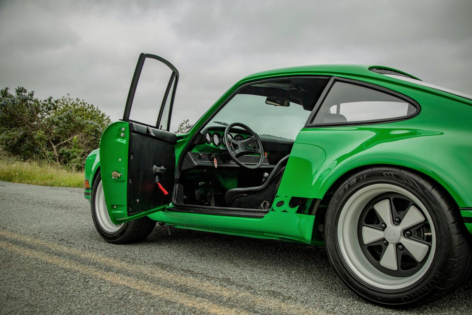

I've used these many times to get just the right stance and fitment in early wide-body cars which are so critical to the look. Lot of the early cars were asymmetrical and had to run different spacer sizes from right to left. Wierd but it was normal.
This car had close to 5mm difference from left to right but you just do what the car wants....

Thanks Chris, that's interesting, I didn't know the front and rear tracks were so different, so I guess the way my car looks is actually period correct.
Though I might hunt for some 3 or 5mm spacers, but will check the stud lengths first.
