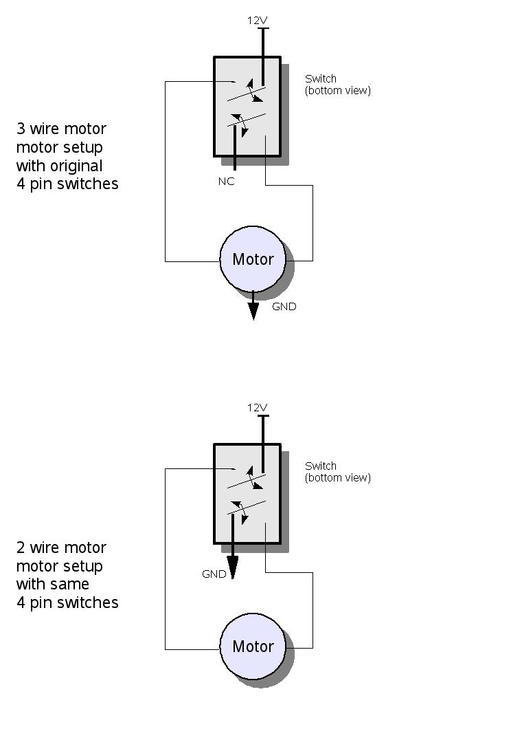

I spent the weekend cleaning and upgrading my rear windows (73 CSi) to run on E28 motors.
A couple of years ago, I used this step-by-step process for the Front windows. I kept the old wiring system and did not add a relay system - just grounded the two front switches on the unused post connector on each switch as per the drawing below.
Now that I am doing the rear motors, the question is this: do I have to ground both the front and rear switches or just the rear?
Thanks as always.
Yes, with the 2-wire motors won't function unless the motor can be connected to ground through whichever switch is actuating it. Just don't ever have the front switch in the UP position with the rear in the DOWN !

Got it.
