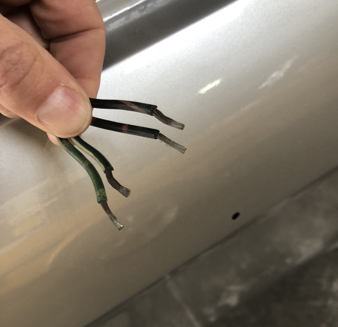

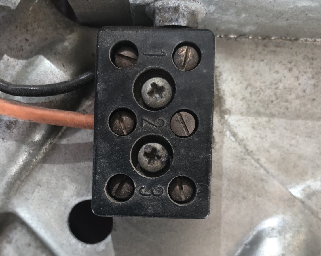

I’m putting the windows back in the car, I didn’t take them apart. I Need help figuring which wire goes in which hole.
here is where the wiring diagram is your friend.
front
green goes to green
brown goes to brown
black goes to black
rear
the brown goes to ground ... not sure it goes thru the wiring block in the rear (it does in the front)
the black from motor goes to the black / red (2 wires - to 2 switches)
the green from motor goes to the green / yellow (2 wires - to 2 switches)
front
green goes to green
brown goes to brown
black goes to black
rear
That worked! What Threw me off was that threw me off was that orange wire splice, not till I zoomed in the picture and noticed the green wire and then it made sence.
Now all 4 windows are working but the rears are slow moving and stop (binding)
