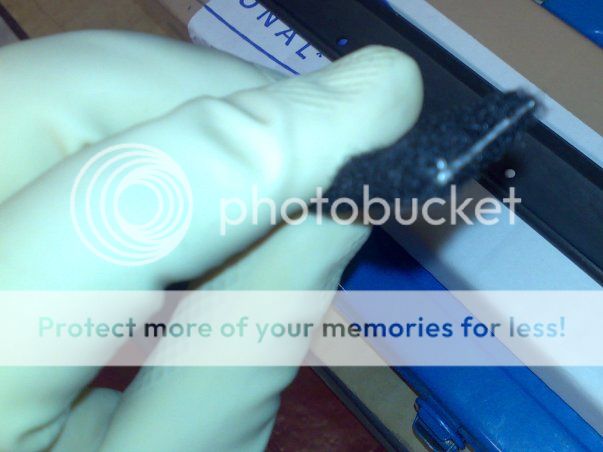

hi, assuming that you refer to the felt part, the original old part was corrroded and thus it had some irregular areas, i can not use any part of it
i used what it seemed to be a synthetic material that is covering and wrapping an aluminium plate, i assume that no corrosion will happen
the alu plate is 1mm thick and 18mm wide, the area that has to contact the window has a protuberence of 4mm, that is bigger than any rivet head that you would use, so there is no risk of scratching the glass
as about the purpose i assume that is not only avoid the scratching of the glass, but to avoid also the rubber to get trapped by the down moving glass, the felt protuberance improves the slipping of the glass when it moves down
